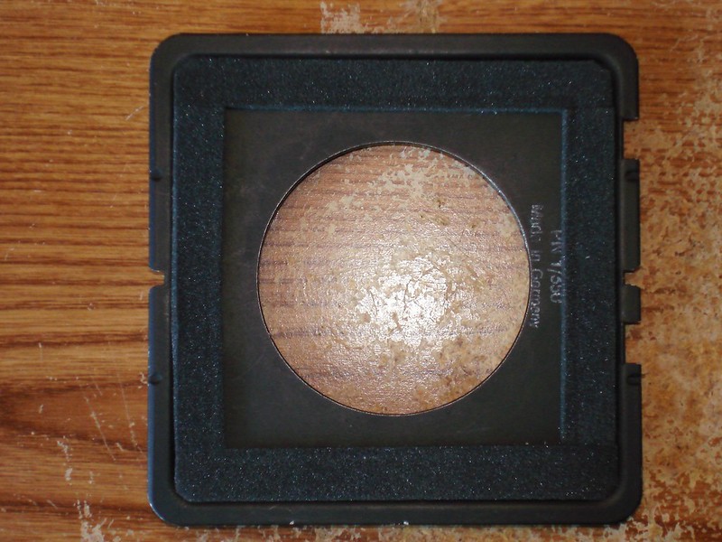

Interesting is "PN 1/350 Made in Germany" as I never ever saw a german product bearing PN (part number).
DSC06088 by Nokton48, on Flickr

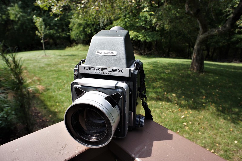

Yesterday I was out shooting hand held with one of my Plaubel Makiflexes. I had forgotten what a complete joy this camera is to use! In this one, I'm running 70mm unperforated Efke PL100 in a Beatty Transet Graflock 70mm back. What fun! Lens was Plaubel Makiflex auto-iris 150mm Schneider Xenar, shooting wide open. I think ADOX Borax MQ is the way to go with Efke PL100, although I've also had killer results with Pyro PMK+ Wonder about Microdol-X?

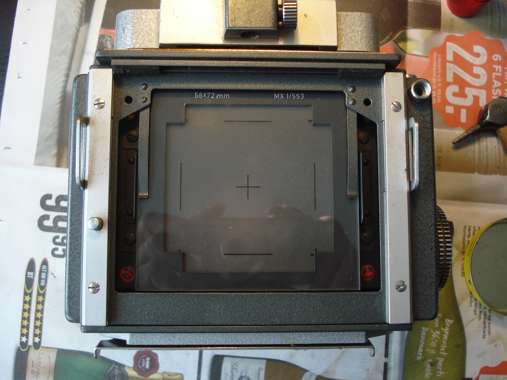

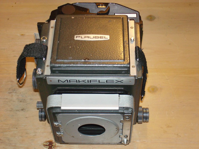

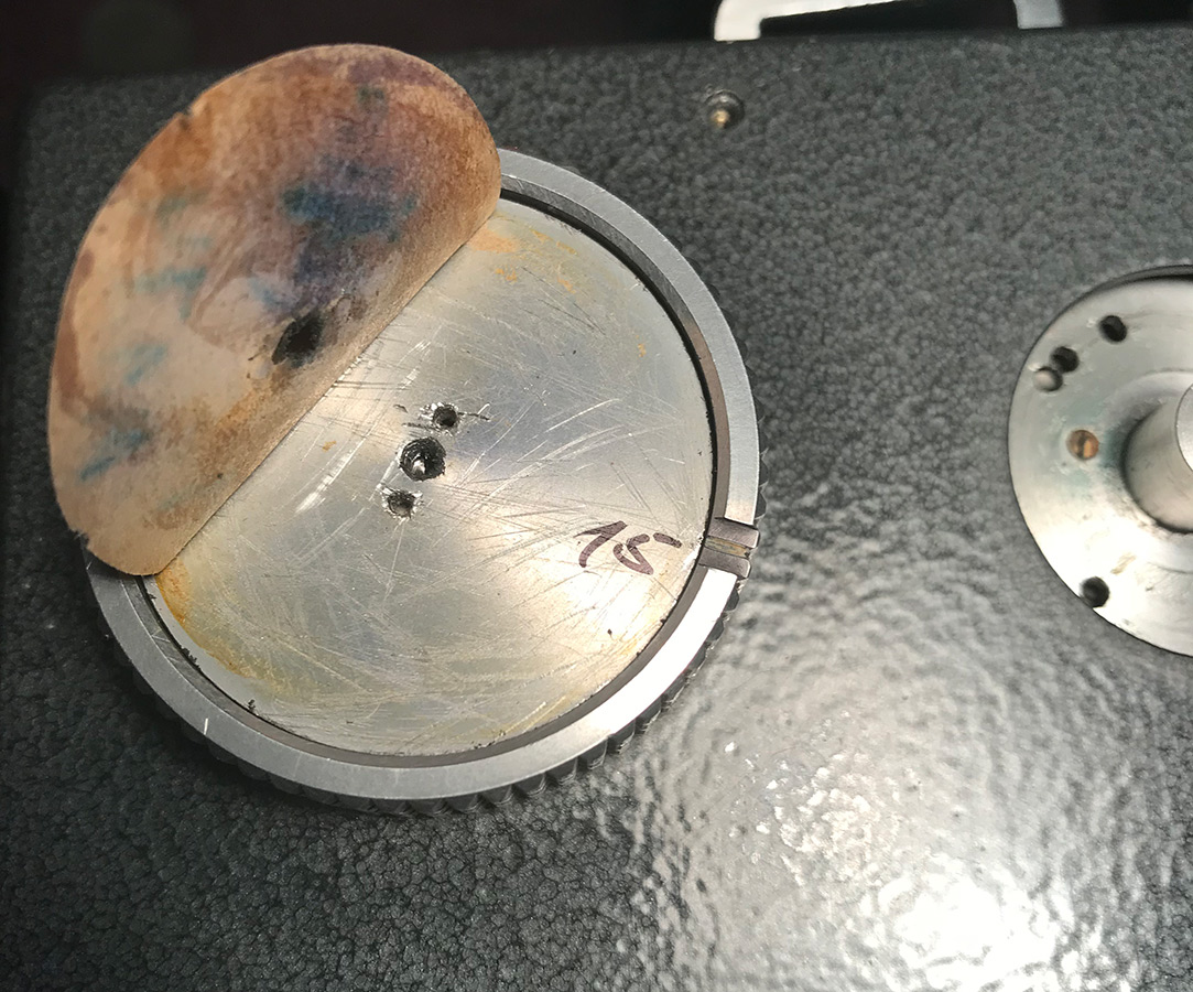

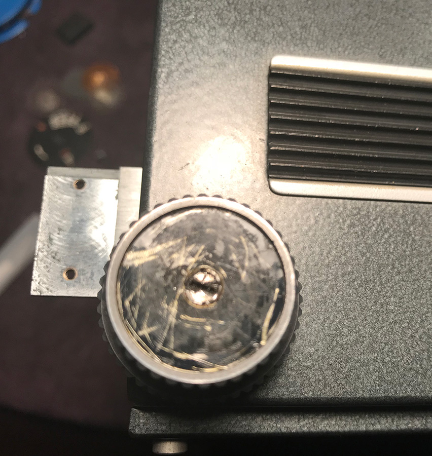

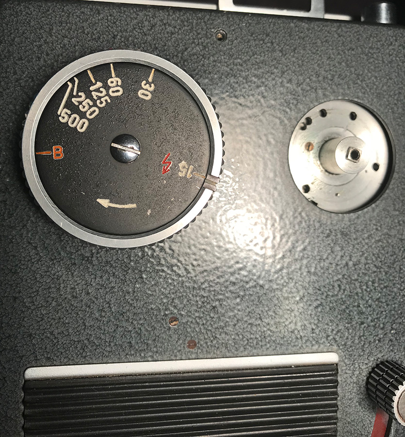

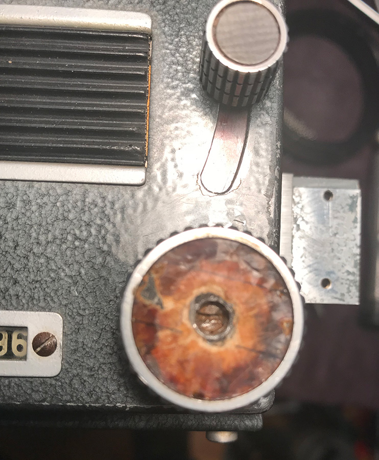

After a long search i finally got myself one. Now i want to open it for some CLA, but am stuck - can't remove the big speed dial and the focusing knob (see pictures). Any help with that is much appreciated.
View attachment 189223 View attachment 189224 View attachment 189225 View attachment 189226

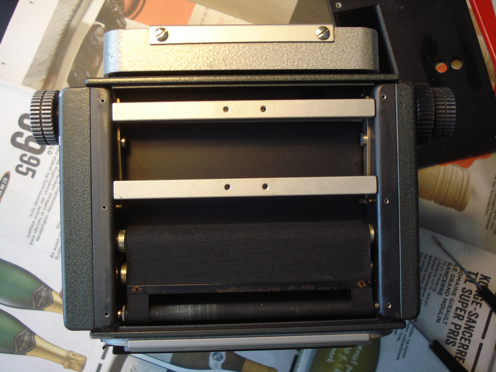

I acquired a Makiflex Standard about 35 years ago, but have hardly used it on account of a sluggish shutter.
I remember I once tried to open it up somewhat to do some CL(A), but only managed to remove the left side body panel, which is to no awail. You cannot access the bearings needing lubrication from under the left side panel.
By the way: The focusing knob on the left side is secured with a bolt that has a LEFT thread! I suppose the right side converse has a right thread; but I never managet to loosen the right side bolt, which seemed stuck.

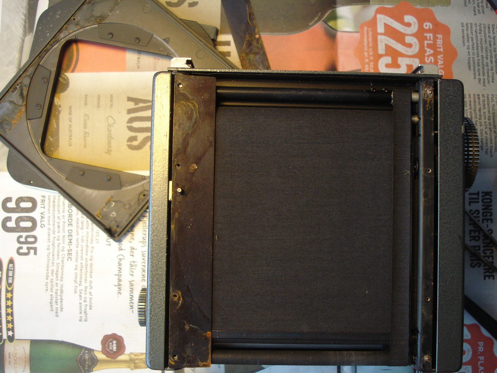

I was of course intrigued by reading about the need to remove the back panel, and have tried it out this sunday pm.
As the pictures may show i managed to wreck 3 of the 8 small, low quality steel bolts holding the back panel fastened to the steel chassis. The camera seemingly had a few drops of water inside at some point. Hence the rusty bolts and other traces of rust seen in the pics.
I also managed, albeit with some difficulty on account of very tight bolts
under the tripod plate, to remove the bottom plate. So I think I have been able to clean and lubricate the running parts sufficiently.
Only the slow speeds gear train inside the right body panel has been partly inaccessibel. But off hand everything seems to be running merrily enough as of now. Note this is the M. Standard, lacking the very slow speeds.

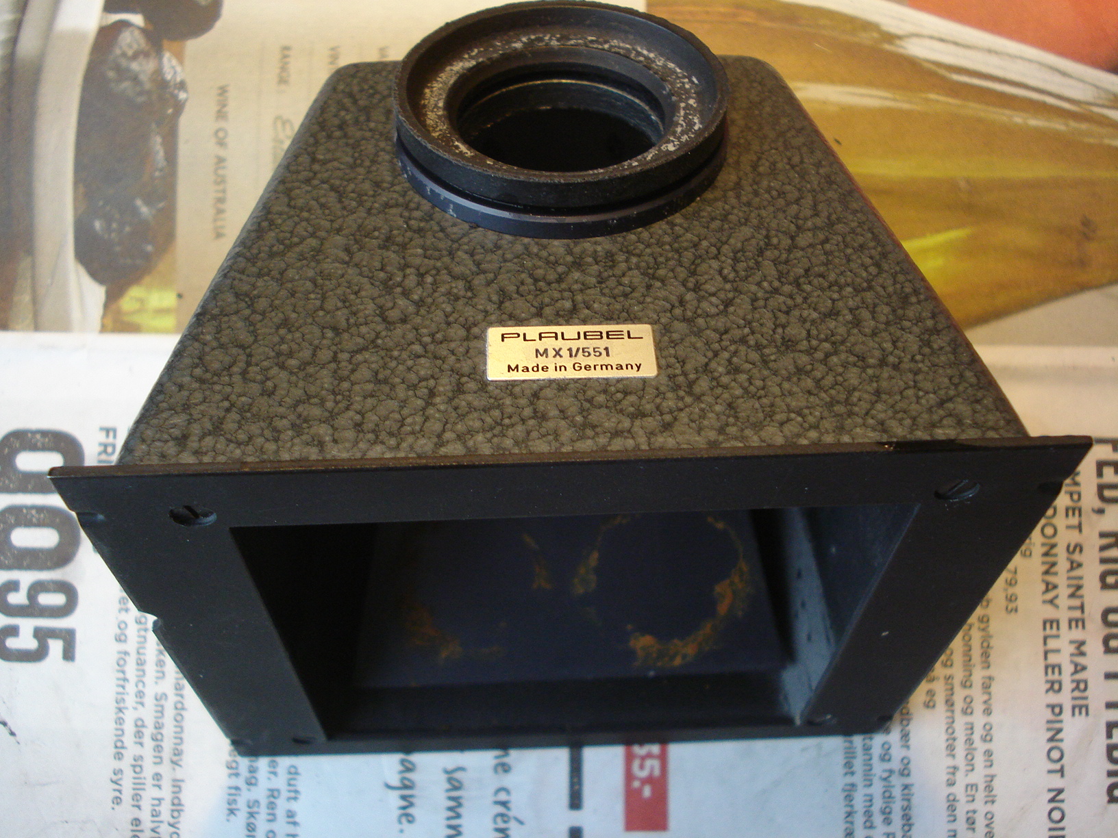

There is no functioning finder. The angled finder seen has missing mirror and finder optics. I hope to eventuelly fix this. I also have picked up a Fujica waist level finder for the 680 at some point, which should be adaptable.
So I'm looking forward to using this handsome brute in the not too distant future. And thanks again to everyone for inspiring reportings.

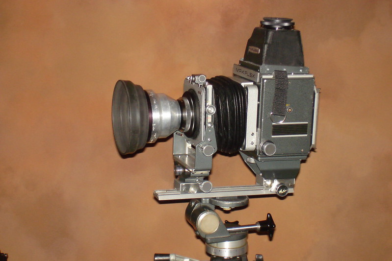

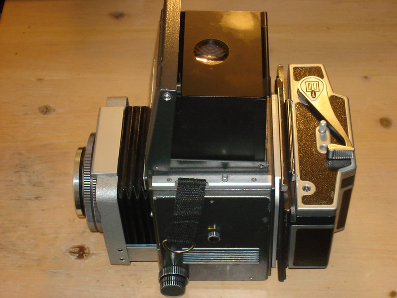

Hi Lorbitar!
Thanks for your kind words. Makiflexes are cool, no doubt about it. Your camera has some light surface rust, -hopefully- not deep inside! If the curtains are running smoothly I would think you are probably good to go. If the body screws came out in one piece, I would try to replace them. Any local repair shops around you that might have replacement screws that would fit?
Regarding the Makiflex Porrofinder, you will need a piece of front surface mirror, cut to exactly the right size. Perhaps a close-up diopter filter could suffice as an eyepiece lens? Then also you could screw in a rubber hood to not scratch your eyeglasses. The Porrofinder does invert the image upside-down, perhaps you will not like that?
The Makiflex frame (the flat frame that slides into the camera body) can be adapted to take a variety of other viewfinders. I particularly like the Mamiya RB67 Metered Stovepipe, I adapted one to fit my Makiflexes. The diopter adjustments and screen viewing is just lovely! Geoff Berliner has adapted Arca Swiss Stovepipe viewfinders to his Makiflexes, and he likes them.

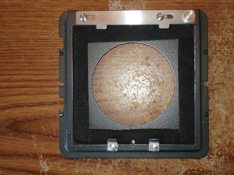

The best thing about the Standard Makiflex, is that is will take Plaubel recessed lensboards. So wider lenses will go on your camera. I particularly like the 120mm Schneider Angulon f6.8 (in a barrel mount; no shutter). Lovely lens.
Let us know how it is going. There are few of us, but we are a very helpful group.
Plaubel Recessed Board 2 by Nokton48, on Flickr

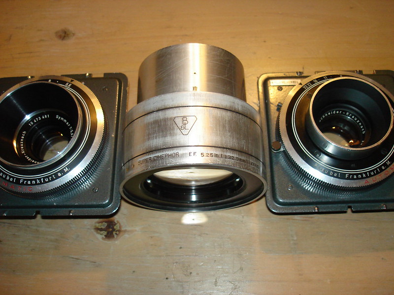

Here is my "new" Bausch and Lomb" Super Cinephor 132.8mm F2.0 lens. Designed for theatrical movie projection of 35mm and 70mm film. Hoping I can adapt this "beast" to the Makiflexes. It weighs a ton :smile:
Shown in between two 150mm auto Makiflex lenses (Symmar and Xenar), for size comparison
Super Cinephor by Nokton48, on Flickr
Super Cinephor image from the internet. I'd like to do something like this, but a 9x9cm image on LF sheet film.

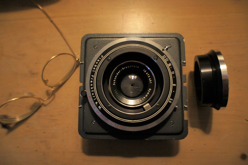

Today I was able to finally remove the front ring from my Automatic Makiflex Schneider Symmar 150mm F5.6, that I bought from Poland, last year. The ring was completely jammed on, I was finally able to remove it with a rubber Band Wrench, and a lot of brute strength. It has now broken free, so I will now attach a protective filter to the front of the Symmar.
150mm Symmar Makiflex Automatic Mount by Nokton48, on Flickr
Here you can see how the spring loaded Makiflex Automatic mechanism is attached to this barrel mount lens. The front ring also serves as a lens hood, and protects the inside spring mechanism. This is the only Automatic Symmar I have seen so far, they seem to only be in Europe. Along with the Auto Makiflex Voigtlander Heliars, of which I have seen a few. But only one Symmar ever.

I have just figured out how to put the Bausch & Lomb 5.25" monster theatrical movie projection lens onto the Makiflex Standard.
IT FITS AND FOCUSES PERFECTLY. But not out to infinity, very close-up only. About 18"x18" area image in proper focus. Amazingly lovely bokeh. :smile: Should work well for very tight portraits. The Makiflex excels at fashion and portraiture according to Plaubel.
Ten pound lens. F2! Perfect for Makiflex. Presently held to Plaubel board with gorilla tape. Rear of lens barely fits into Makiflex Standard body. It's HUGE. Will not fit Automatic model Makiflex, due to cables, smaller throat, etc.

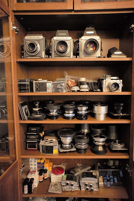

New Showcase for Plaubel System by Nokton48, on Flickr
We have new floor to ceiling shelving in the office area of my home, so here is my Plaubel collection, ready for use. Nicely organized behind glass doors to keep it dust free.
This keeps me thinking about taking it out and using it! That is up ahead, in a very big way. :smile:
This is not all of it (no way) just the things I want to use all the time. The rest is in my studio in the basement.
