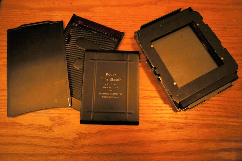

Here I am getting my 9x12cm plate stuff together. On the right, a Plaubel Makiflex Plate Back I bought on German Ebay. On the left, a RADA Normalfalz 9x12cm Plate Holder. Normalfalz in German translates to "Standard Folding". RADA made over a dozen different styles of 9x12 Plate Holders. It took a while to sort it all out.
I have fifteen of these RADA holders, and the "Kodak 9x12 Film Sheath" is an accessory to use the holders with modern sheet film. I have plenty of those also. So I can shoot glass plates or modern 9x12 sheet film.

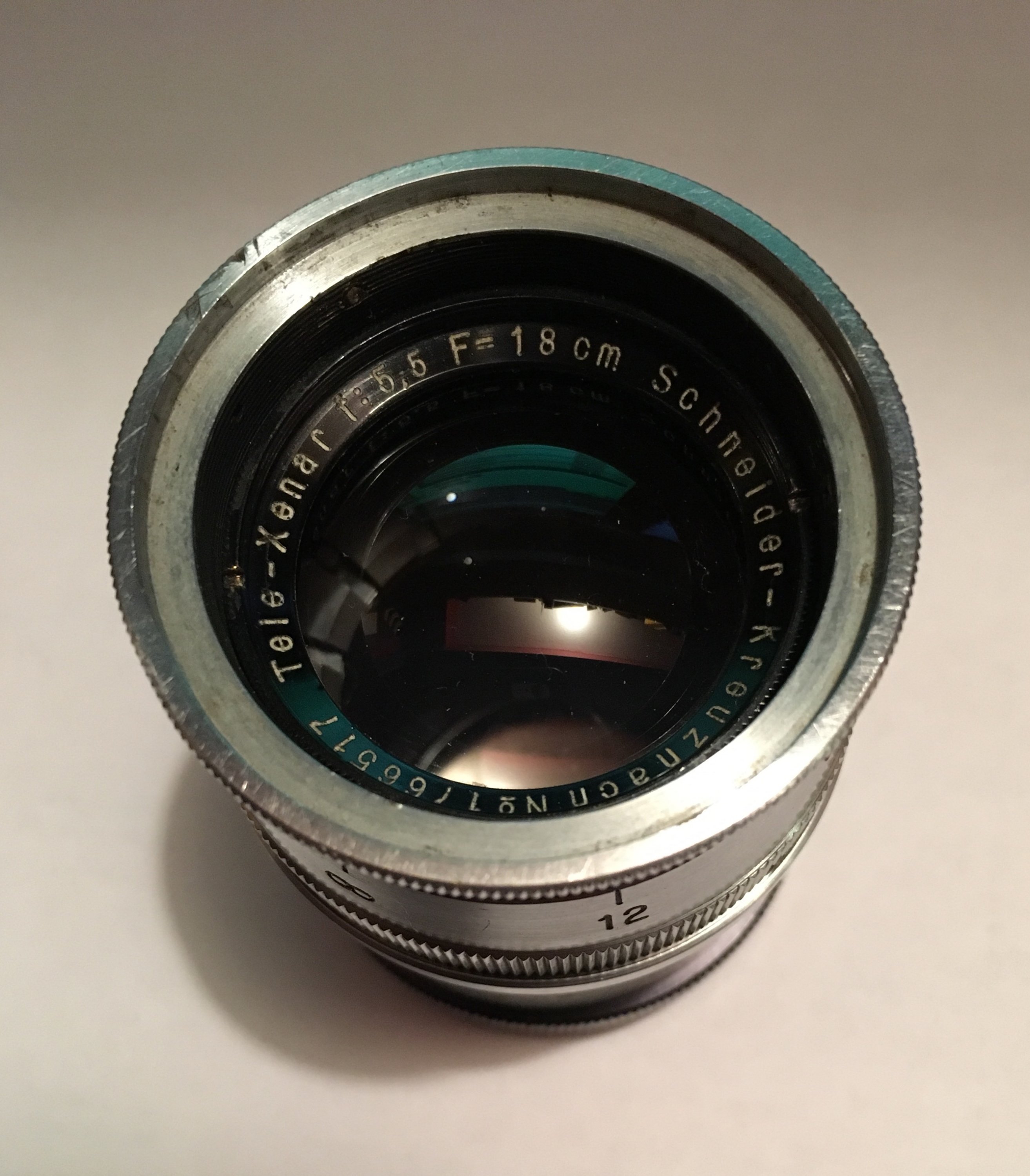

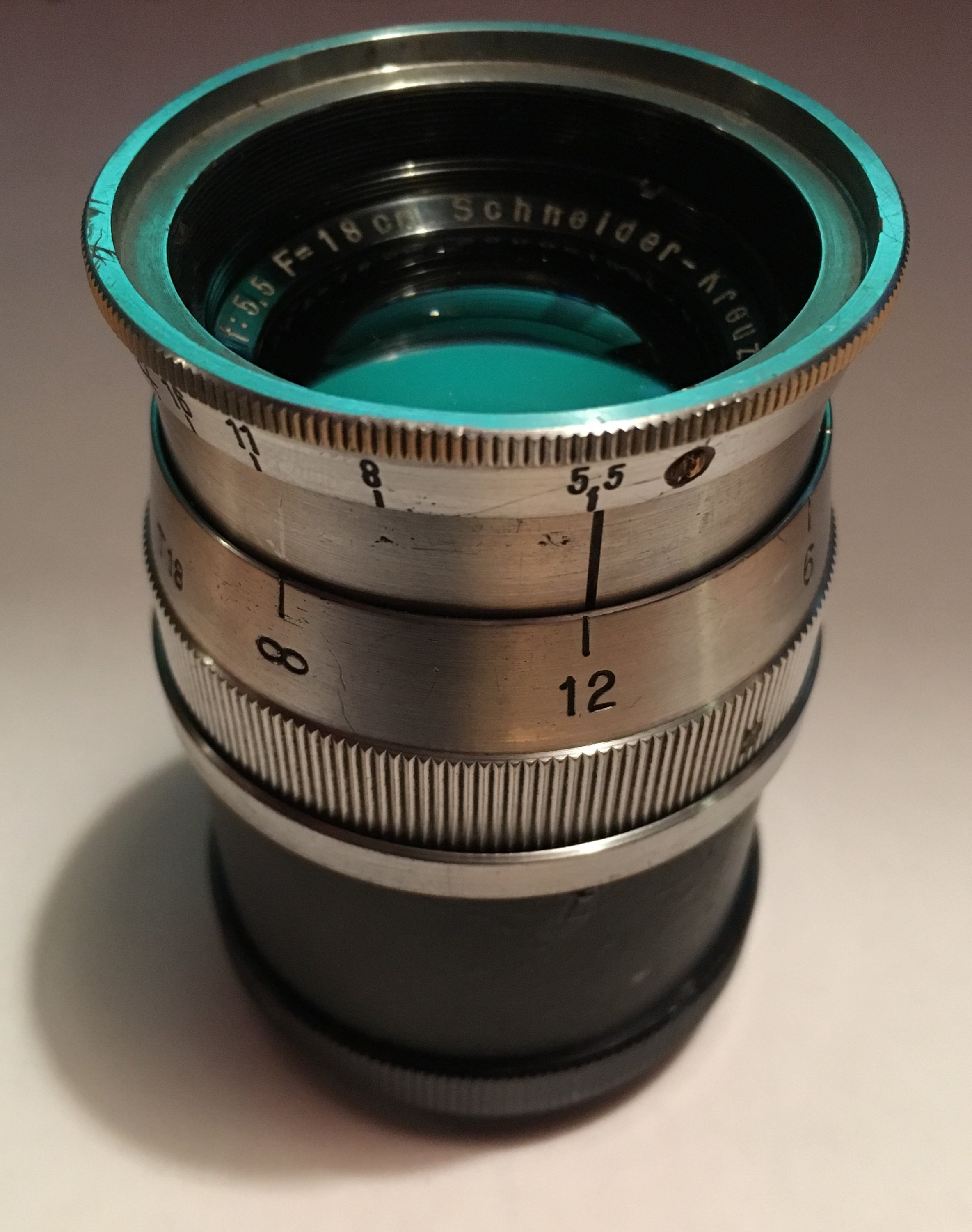

Ha, Ha Dan! It's funny how we are sometimes in synch. In september I got the same (maybe a bit older #) Tele Xenar 5.5/180mm from the friend in Belgrade. This one has focusing helicoid and nice gash on the center of the rear element. It had 40.5mm mounting screw on the back. I had to clean and lubricate focus, it was completely frozen. No idea for what camera it was originally made? Most likely Robot? I was able to mount it on M42 ring and then on the Nikon.
Nothing much to write home about with 24x36mm format. Maybe larger negative can show something interesting from the edges of it?

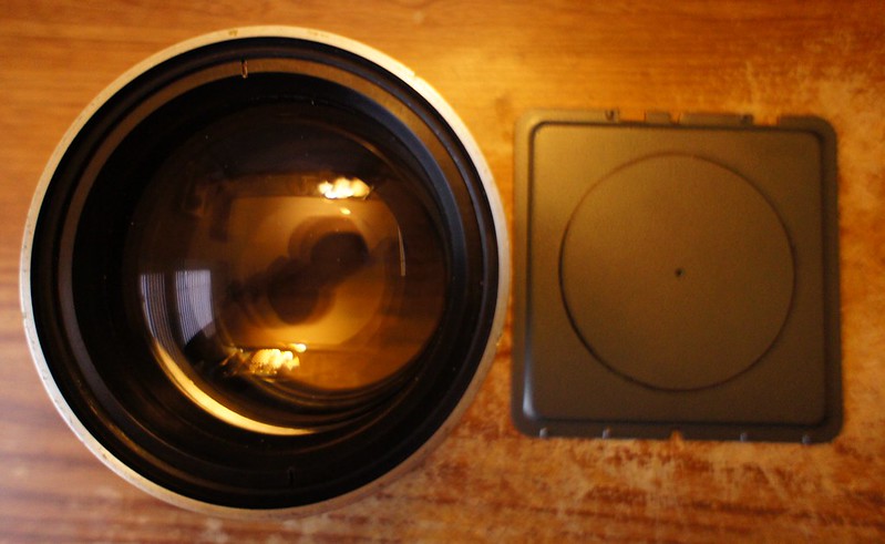

159mm Super Cinephor Making Lensboard by Nokton48, on Flickr
Here I am making a lens board for my 159mm F2 B&L Super Cinephor. This will involve a fair amount of metal cutting. I will use my electric scroll saw to cut the hole, and then use a fine metal file for the final hole shaping. This will take some time to do properly. Then I will re-do the foam light seals on the lensboard. Finally then I will epoxy (I use JB Weld) to glue the lens to the board. Overall a time consuming but necessary photo project.
There simply isn't room inside the Makiflex Standard body to fit a recessed board. The rear cell on this Monster -just- fits inside the camera throat as it is. It's a very tight squeeze. I might be able to shave 5mm off the rear lip of the lens, that would get me closer to the film plane and extend max shooting distance. We will see as this progresses.
I know of another Guy who ran into these lens size issues with the Super Cinephor, and he went the same route as I have described. He is using Sinar F+ and Sinar shutter but the lens mounting issues are the same.
