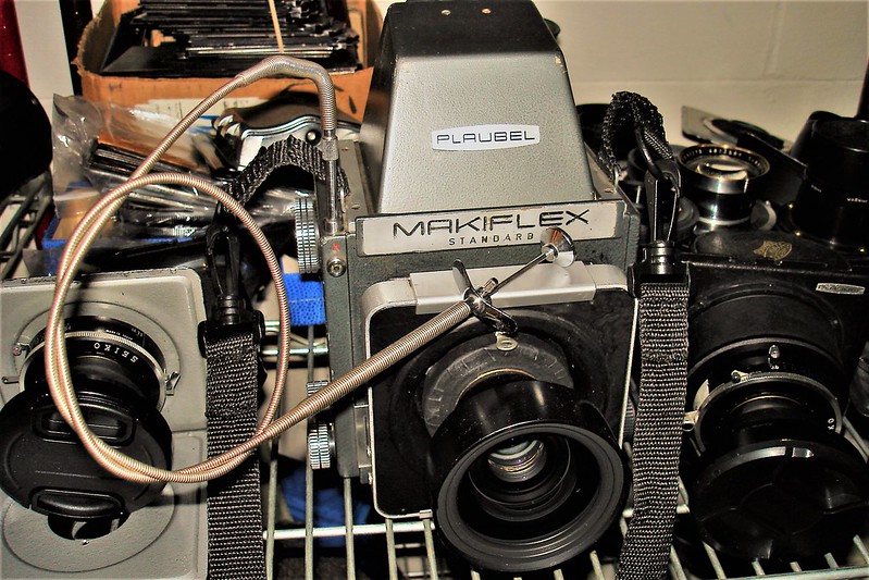

Some of my Makiflex stuff down in the studio. I like the metal Metro shelving with wheels to hold a lot of heavy stuff securely.

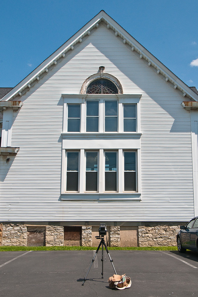

Here is an old test of the 150mm F9 Rodenstock Apo Ronar. This was during my "struggling" period with the Plaubel roll film holders. First of all, fifty or sixty year old holders are incredibly dusty inside! Also frame spacing problems abounded, which I have since completely sorted, by using film spools of the wider original diameters (duct tape or the original wooden 120 film spools). I do like the curved corners of the Plaubel backs. Neg flipped for scanning.
Agfa APX 100 in Mic-X, 150mm F9 Apo Ronar. Columbus Camera Group "White Church" exterior detail. Auto Makiflex.

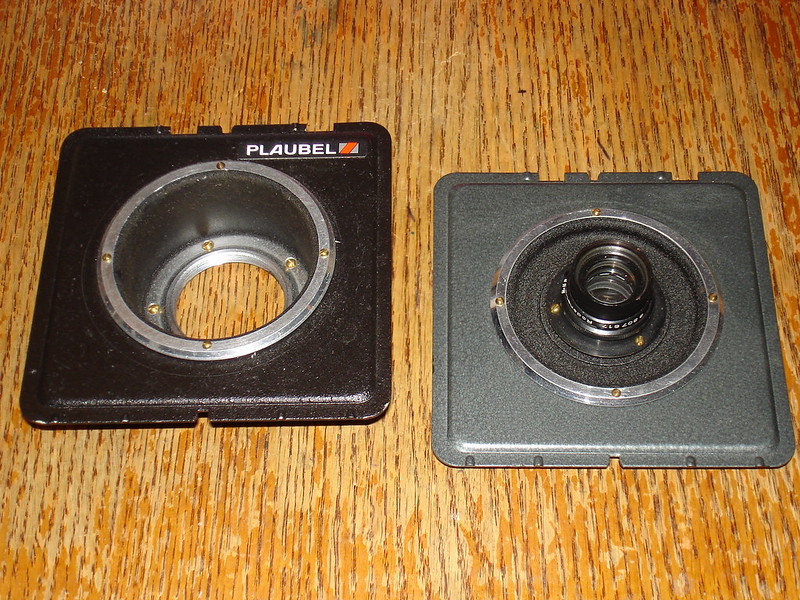

Back to my Plaubel Makiflex project. Since accessories and lens boards are rare and difficult to come by, I decided to mount an adjustable iris lens clamp to one of my boards. This will allow me to mount lenses directly to the camera without board or flange. I used as large an adjustable iris that would fit on the board so I can mount large diameter speed lenses. In the first pic is mounted a 7” f4 C.C. Harrison New York City, Daguerreotype Petzval Portrait lens. This camera makes 9x9 cm images on 4x5 sheet film. 7” / 180mm seems to be the right focal length for this format so I’m pulling out fast lenses in that focal length, though I’m pulling out some shorter ones as well. I pulled out a ca. 1890 Steinheil Portrait Antiplanet 7” f3. This was a redesign of the classic Petzval Portrait lens that was formulated to be flatter field. It’s quite an interesting lens worth reading about if your a lens geek like me. I also pulled out a Astro-Berlin Tachar 150mm f1.8 lens. It’s quite fast but doesn’t reach infinity on this camera due to the reflex mirror but works at portrait distances. Still lots of experimenting to do. -Geoff
Some of the RZ67 lenses woudl likely cover, at least at portrait distances.
Thanks Ed. That is a good idea. I've been buying broken RB67 lenses to get the Seiko shutters for my Fuji GX680 to Maki lens hacks.

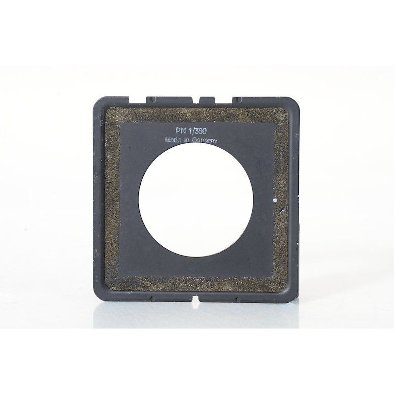

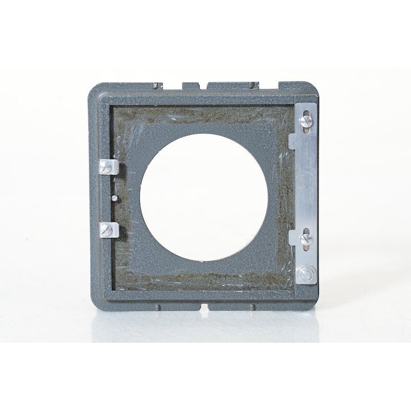

Just bought this 120x120 to 95x95 Plaubel Peco Jr Lensboard Adapter.
I will clean it up when I receive it.

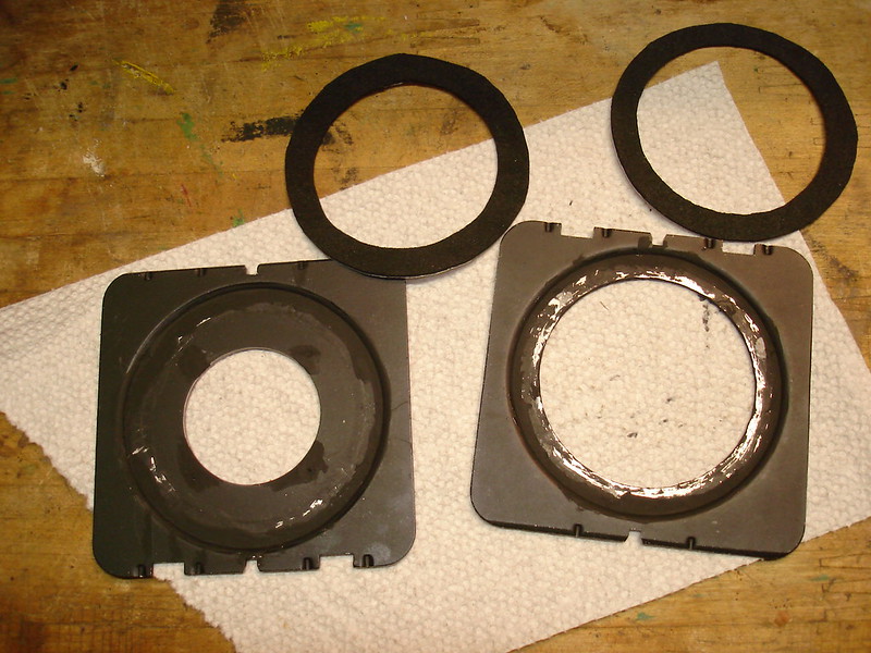

Here I am restoring some 95x95mm Plaubel Peco Jr lens boards. I bought these by mistake, but now that I have the 120x120 to 95x95 Adapter Board coming, I can utilize them. I cut out circles of adhesive foam rubber (redoing the board light trapping). And with some flat black Krylon, and some liquid aluminum to fill in screw holes, these are now good as new, ready for the new adapter board.
