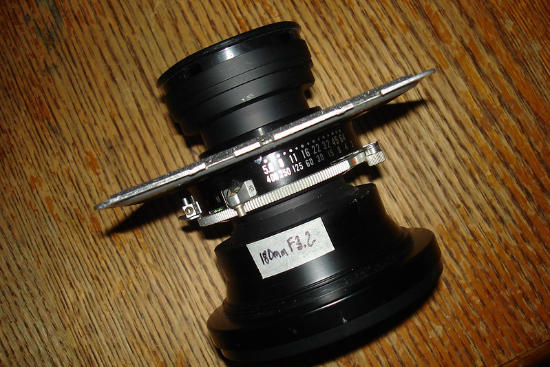

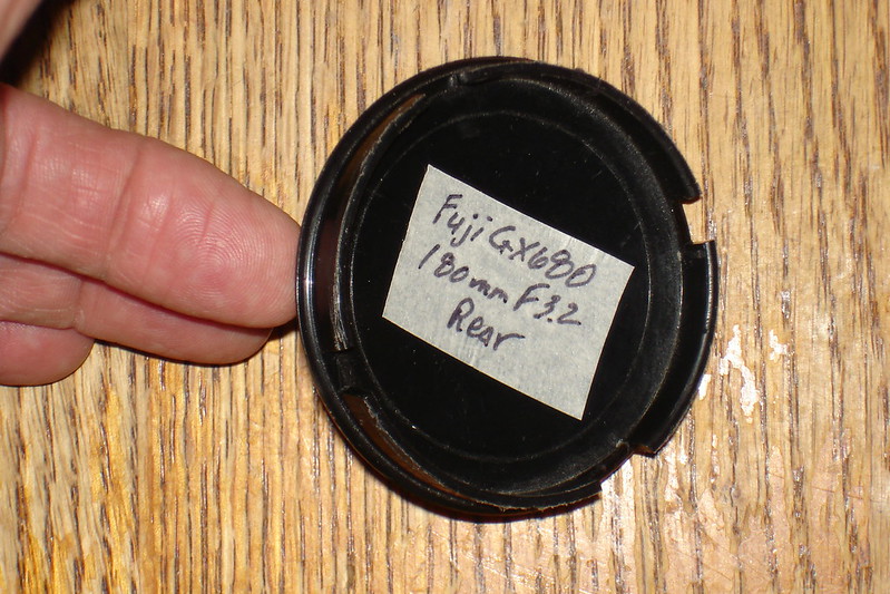

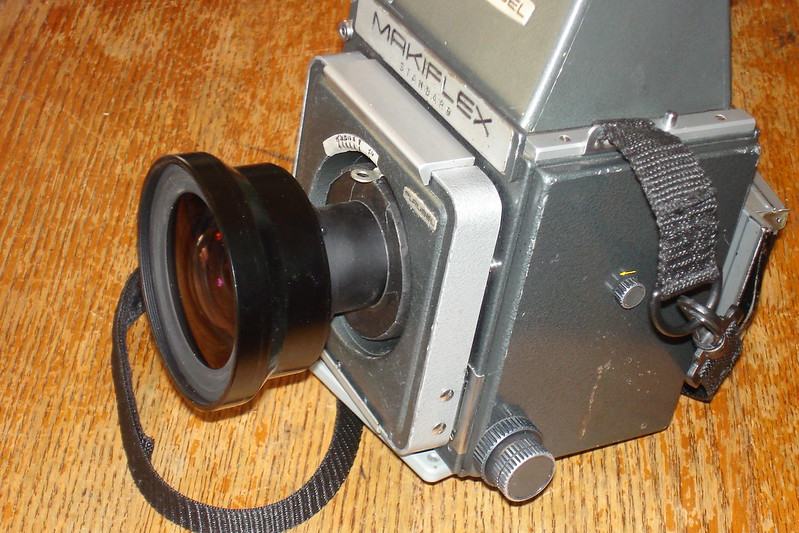

Did you ever find a premanufactured cap suitable for the 180mm 3.2 rear element (on eBay or elsewhere)?
Hey Dag.bb,
Not a premanufactured one, but I did make my own, after perusing my collection of over a hundred lenscaps. I ended up with a Schneider large format cap (marked SN 223/26-57@) which will almost fit into the interior rear threads and friction-fit tightly. Cut some slots with a razor blade, and it fits tightly. The extremely rear-protruding cell on the 180mm F3.2 made it necessary to get creative. :smile:
I dislike the Fuji GX680 front caps, they are cheap IMO and easily fall off, very aggravating. Threw them away, and got nice 86mm & 95mm black plastic clip-on ones from China for the front caps. I store my lenses in ziploc bags to protect them from dust and it does provide some protection from scuffing during transport to shoots.
Please post some more photos here. Always glad to get responses. What you are doing is very interesting.

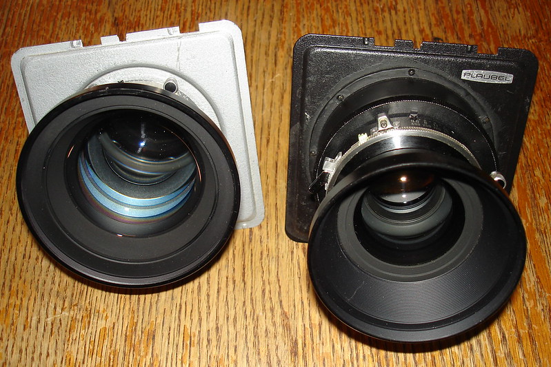

Not too much new to report. But today I did receive another Seiko Shutter from Japan. I will happily pay a hundred bucks for these. This one came with a 180mm F5.6 Fuji WS with bad front cell. I had difficulty removing the front cell it was really on there. With a rubber clamp set in my vise, I finally wrenched it apart. Now it holds the Fuji GX680 180mm F5.6, the f/stop band is perfect ready to go for this one. It's done and beautifully functional, shown on the right. Both of these lenses are useful to me.
On the left (for comparison) is the Fuji GX680 180mm F3.2, note the size difference of the front cells. The F3.2 takes a 95mm filter, most of the other Fuji GX680 lenses take 86mm's.

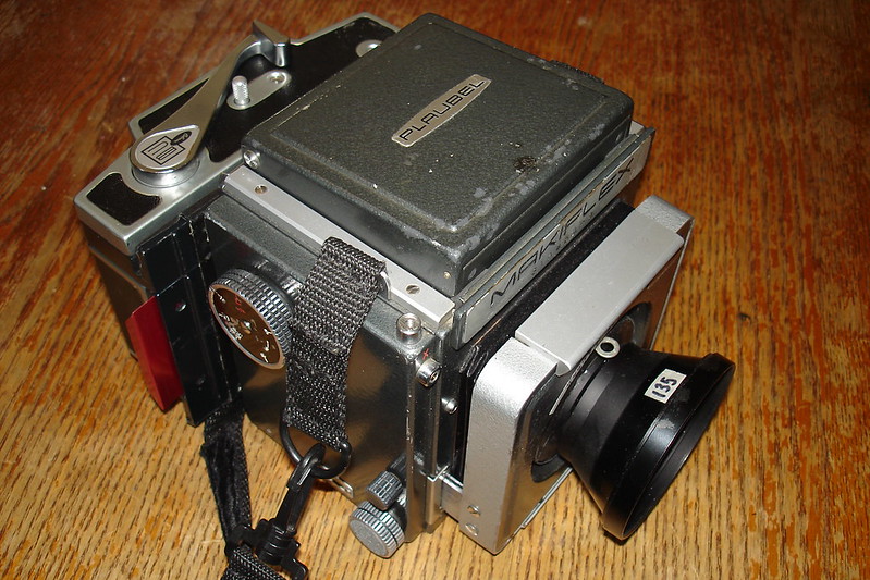

Here i have loaded my 70mm Beatty Coleman Transet Back. It uses it's own special film spools, which luckily are in the back. Instructions say you can load it in subdued lighting, but you will lose some frames. So I loaded it in the darkroom and it went OK.

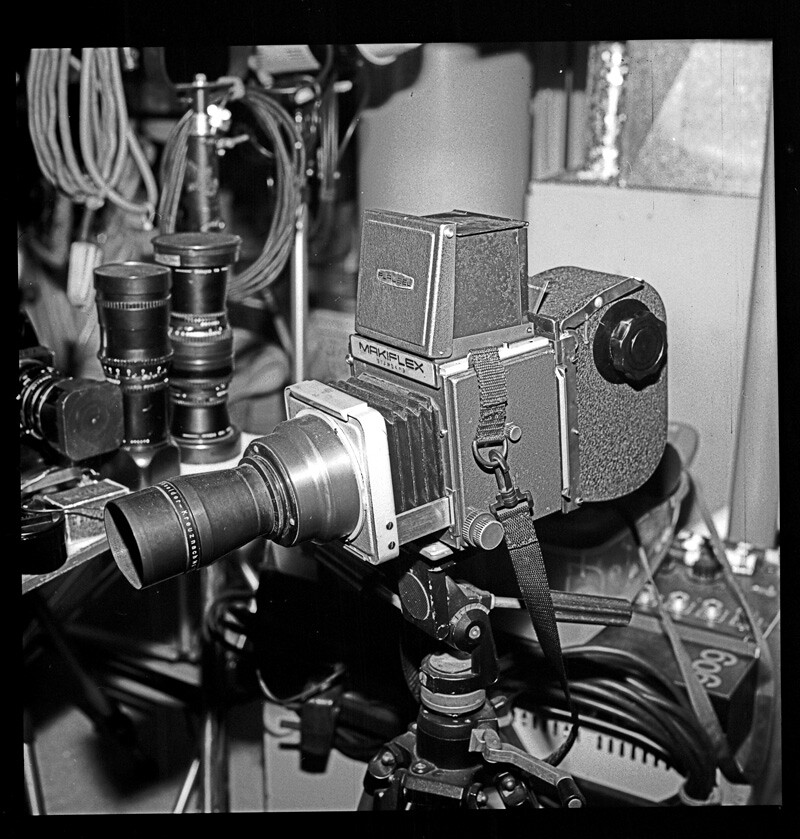

Here is the back loaded with 55 exposures of 70mm unperforated Efke R100. It is attached to my Makiflex Standard. The lens is a Fuji GX680 135mm f5.6 Fujinon which I hacked to fit the Makiflex cameras.
DSC05810 by Nokton48, on Flickr
Ready to use!! :smile:

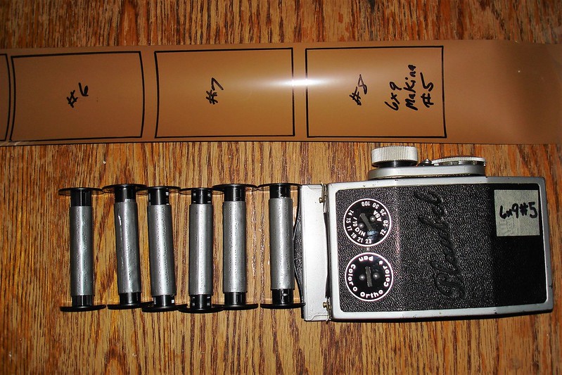

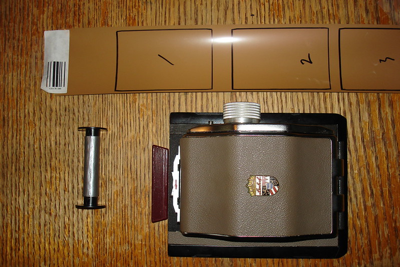

120 film spool wrapped with four go-rounds of plain old duct tape, results in perfect frame spacing with Plaubel Makina #3 roll back. An easy solution to a vexing frame spacing problem intermittent to the Makina backs. Sure hope this works with the 6x9 backs. Why wouldn't it?? :smile:
I intend to get out and shoot more as my life starts to settle down a bit.
DSC05851 by Nokton48, on Flickr
Same good result from my 4x5 6x9cm Linhof wind knob back. Eight perfectly spaced frames is the result. :smile:
These wind knob Linhofs are notorious for intermittent spacing issues. Duct tape comes through, again!
https://flic.kr/p/WXAL6v
DSC05849 by Nokton48, on Flickr
Here is the result of the duct taped spool, with one of my five or six 6x9cm Plaubel Makina backs. These are somewhat dodgy regarding frame spacing, so shoring this up, is HUGE for me. It's quite disapointing to have important frames overlap (especially when you are not expecting it!) The mechanism is rather primitive and archaic, as well as extremely unusual in design. But now it appears to be working beautifully so far.
Make a tick mark on the duct tape, with a sharpie marker, as you wrap it, so that you get the correct amount of tape on the spool. Easy to do.

The camera shown is one of my Plaubel Makiflexes, with barrel mounted 360mm Schneider Tele-Xenar. The film back is a Beatty Coleman, which will take up to one hundred feet of perforated or unperforated 70mm film, and produces a 6x9cm negative. Probably made for school camera photography. This will also fit my Sinars.
This is an old image, cause I sold the old old Tele-Xenar and replaced it with a much nicer 60s vintage chrome one. Better match to what I am fitting it to.

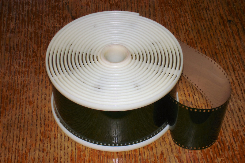

That Kindermann plastic reel seems to be a "plain" one, thus neither of the Jobo or Paterson type.
Thus it is loaded like a metal reel?
It is actually a " USA made dental x-ray 70mm reel" Only $9 US If you wish I will post the website They have a minimum $50 purchase
It loads as easy as the metal kindermann But only about ten US feet, not the full fifteen
Please post the website. Those of us with old 616/116 cameras always appreciate more options.
Thanks for the link!
Here's the nylon 70mm reel test loaded with some old Kodak Portra 70mm film
70mm Dental Reel by Nokton48, on Flickr
As you can see it will almost take a full fifteen roll of 70mm film.

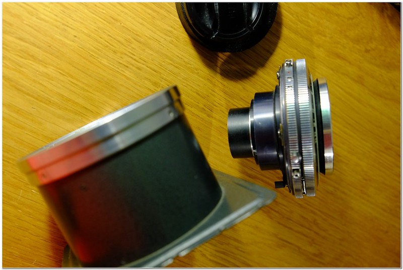

I just bought this ultra rare original Plaubel Makiflex Automatic Iris Schneider 150mm f5.6 Symmar lens. It is coming from Poland :smile:
In thirty + years this is the first one I have ever seen offered by itself. I have seen them seen many times offered with cameras before. This one seems only to be available in Europe; The Symmars are not in the USA Plaubel catalogs. Nor are the Auto Voiglander Heliars.
Makiflex Symmar 150mm f5.6 by Nokton48, on Flickr
Here is another view of my new goodies. The long prolongation tube with board will go on my longer automatic lenses, I can use another one. A very big bonus actually. The 150mm will go on a flat Automatic Plaubel Makiflex lens board.
Symmar Makiflex 150mm F5.6 Auto Iris by Nokton48, on Flickr
