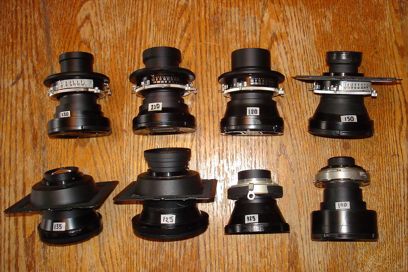

My bevy of Fuji GX680 lenses thus far, all converted to mechanical Plaubel Makiflex. I have not had time to work on these recently, but I did finish the 180 & 250 today. Haven't felt much like making pictures, recently. I need more Peco Jr recessed boards, I have -one- more coming all the way from Poland...... I waited two and a half months for more #1 Wista mounting plates to arrive from Singapore. Shipping snafu of some sort. The Peco Jr recessed boards can be rare and expensive. Still looking for the 180mm & 115mm F3.2 GX680 lenses (at low prices), & maybe some more wides, if they function properly on the Makiflex Standard. It's a bit of a craps shoot, no way to know for sure what issues will come up with these wide wide lenses.

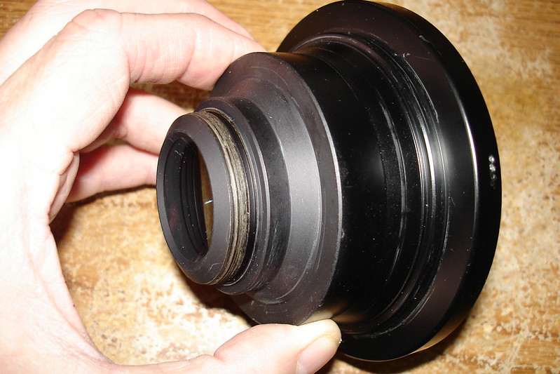

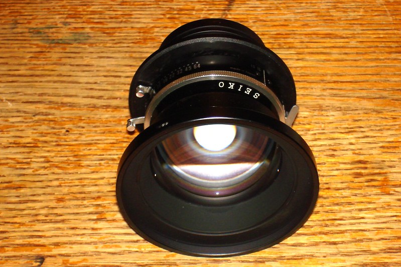

is there any published cross-section diagrams of the Fuji GX lenses? I am curious what the lens formula is for the 180/3.2 and the others. 7 element / 5 group for the 180/3.2, probably some sort of gauss derivative I'd guess, or could be Xenotar-ish. (or even Aero Ektar-ish).
I think I have all the GX680 literature, no pictures of the glass configuration. Yes seven elements in five groups.
DSC05667 by Nokton48, on Flickr
DSC05668 by Nokton48, on Flickr
You can see the glue on the threads, they are left-handed. This is a heavy lens; 36.3 ounces or 1030 grams That is a huge rear element To me it seems like a retro modern remake of a Xenotar, slightly longer and not as quick. This is good since we both have Xenotars 150mm F2.8 I'll bet it optically outperforms the Xenotar. And cheap as peanuts
All these Fujis are sealed, no way to take them apart. Elements seem to be glued in. Too bad as some of them are starting to fog inside. Surprises me they didn't care about that Throw them away I guess!
The Fujinon WS lenses 210mm and 250mm, also one of the 180mm lenses have the right Seiko shutter; Be careful to get the right one, there are several kinds!
