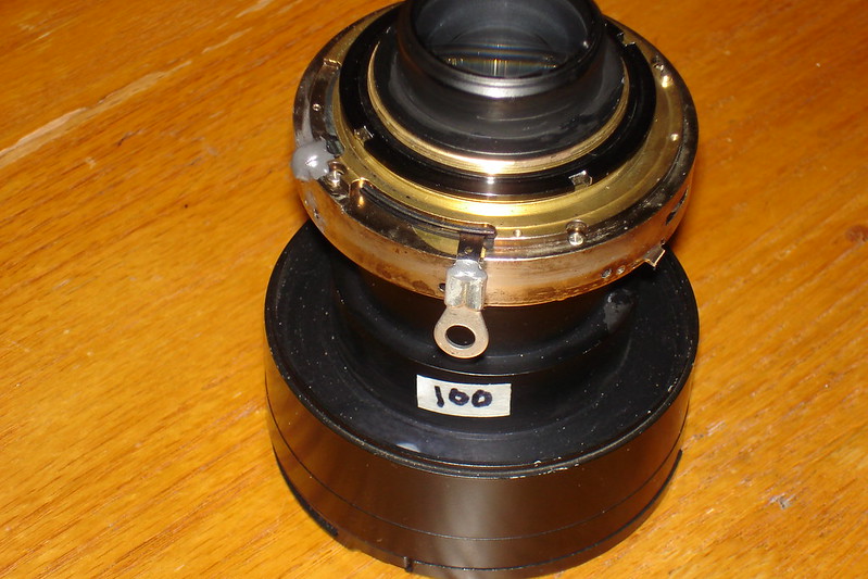

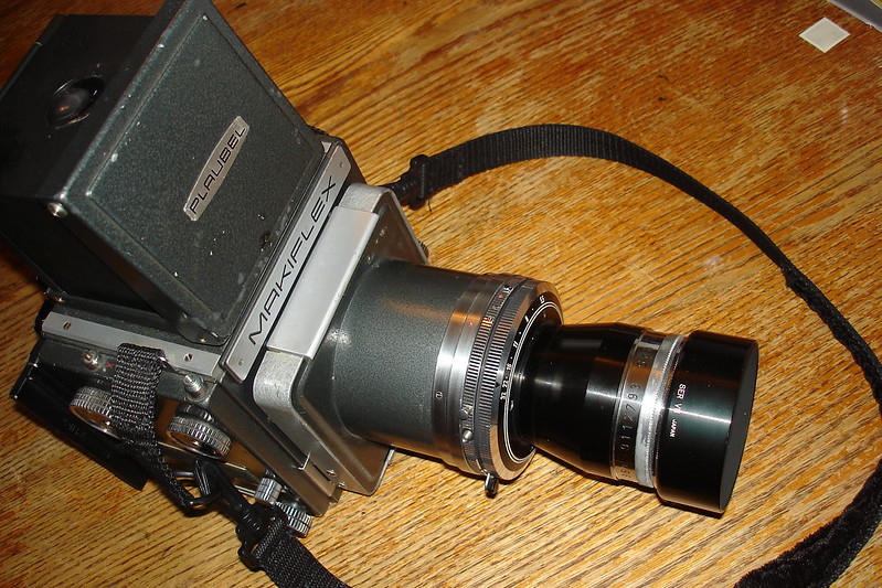

Today it has warmed up to spring like weather, so I am working on finishing the GX680 100mm F4. I removed an RB67 shutter from a 90mm F3.8 RB lens, it has a beefy heavy brass shutter perfect for this job. I stripped all the external linkages and ground down some high spots. Now I have JB Welded down the tab that presets the aperture (see the blob of grey on the back of the shutter, that's it) so it can't move. Next step is that I have flattened out an electrical connecting tab in a vise, and filled it with JB Weld. That tab is now drying (15+ hours) and then I will bend the tab and it this unit ready to use. Will cover the shutter with black photo masking tape to keep out the dust. This lens will go into my new Plaubel Peco Jr board that just arrived from Poland. Will need to add an f/stop band to the outside of the recessed board.
This is a very cool lens on the Makiflex, 100mm is significantly wider than the 120/125mm lenses that I enjoy using. Will test it as I have time.
DSC05683 by Nokton48, on Flickr
Here the tab is bent. Lens is now ready for final finishing. On to body and paint :smile:
DSC05684 by Nokton48, on Flickr
And here the shutter has been sealed with black masking tape, and the final painting is completed. So tomorrow when some touch up paint is dry on the lens board and some brass washers, I will final assemble the lens. Add the f/stop scale on the recessed board and I am done. Thought some here would like to see the final assembly process.
DSC05687 by Nokton48, on Flickr

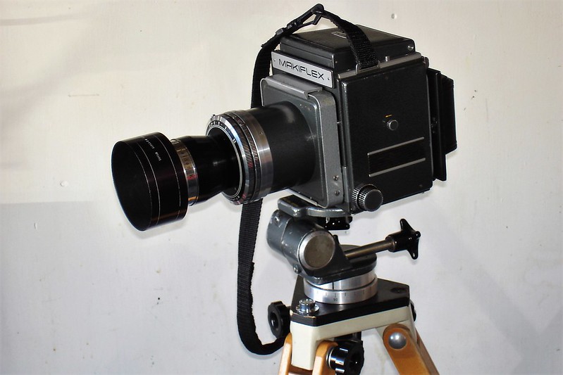

So Thanks to Igor in Cleveland I now have a working Pecoflex (made with the Makiflex/Pecoflex Adapter on the Auto Makiflex). Here is the 360mm F5.5 Schneider Tele-Arton, a lens I have enjoyed using very much on the Auto Makiflex. Now it is adapted to the Pecoflex, so I have full front movements to enjoy. Shown here focused at about thirty feet. This will get some use this year. This lens also interchanges with the 360mm F5.5 Tele-Xenar, which I also have in late vintage in barrel mount.
This morning it was extremely foggy and warm so I went out and tried a test photo with the new Fuji 100mm F4 wide open at 1/125 Ilford FP4+ on the Makiflex Standard (handheld!) focused at infinity

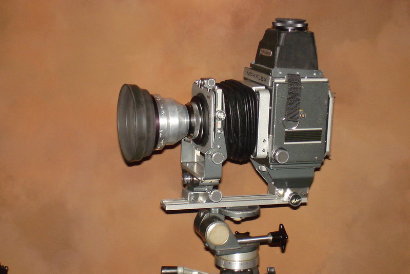

One thing I really enjoy is finding Makiflex cameras on the internet, and when I discover something I did not know, I try to implement the "modification" so that the camera is closer to originality as when it was new. The Pecoflex on Ebay.de has a rubber eyecup on the Makiflex Porrofinder, this I did not know about, it is such a rare item. So I set about to duplicate what I have seen, using a 38mm Rubber Lenshood, the interior ring removed, and the outer edge cut back with a utility knife, so it pretty closely matches what came from the factory. A bit more trimming, and some gluing with some clear plastic glue, and this will be good to go.
No more scratched eyeglasses. (I have brand new spectacles and I want to keep them that way).
I finished the Makiflex Porrofinder today. I added a couple of rubber plumbing washers to the eyepiece, it looks good, fits tightly, and is removable (I might change my mind later). I need to glue down one corner of the mirror, and it's done. I will probably use JB Weld. A few previous owner used some kind of white glue to repair it, which didn't hold.

My new Makiflex Auto iris Schneider 360mm F5.5 has arrived. The mechanism and lenses are clean and working properly. Another original Plaubel factory Makiflex lens. :smile:

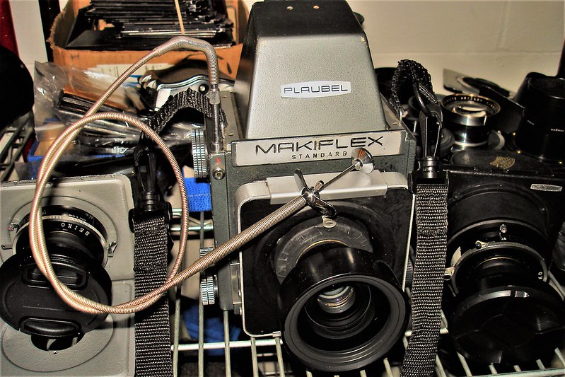

Also from the internet, Here is an original Plaubel Makiflex Single Cable Release MX1/501. As you can see, it is a special design. I would like to figure out how to make one of these. I wonder what parts I would need, can you Guys help identify? It is male threaded and goes into the socket on the Makiflex body.
If anybody knows where I can find one of these, Please let me know!
A while ago I took one of the cameras to Lowes and found the metric machine bolts that fit the Makiflex socket. Then I had a machinist friend drill and tap the bolts to fit a Sinar Norma Cable Release, which has an extra long throw. Simply screwed the bolt into the camera, measured the proper length, and cut the bolt with a hacksaw. Then I used red (semi-permanant loctite) to afix the bolts inside the Makiflex socket. Works very wall in years of practice. But I would still like to have the original Plaubel Releases.
Makiflex Bolts by Nokton48, on Flickr
nice work with the drilling and tapping - well done. Odd they used a non-standard thread on those cable releases. :-/

Here is the Norma Cable Release screwed into the Makiflex.
I have five or six of these cables around the studio.
