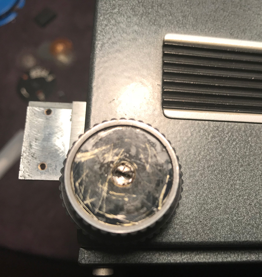

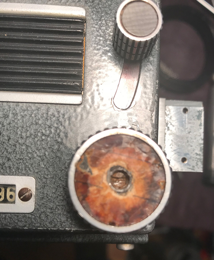

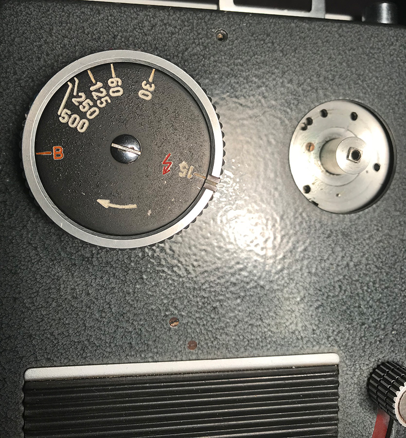

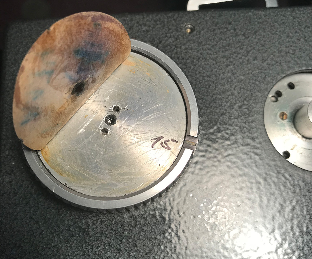

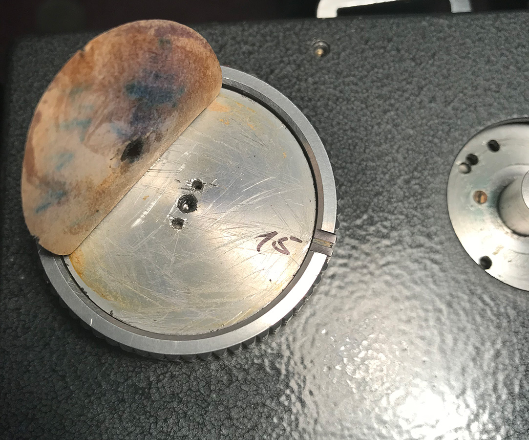

After a long search i finally got myself one. Now i want to open it for some CLA, but am stuck - can't remove the big speed dial and the focusing knob (see pictures). Any help with that is much appreciated.

Welcome ppp147! Thanks for your response. It is cool that you finally found what you have wanted. You will enjoy using this camera.
Regarding repairs, I myself will tackle some projects, but I draw the line at lens helicals, and camera shutters. Better to leave that to the more experienced. I am brave but not that brave.
Actually that brings up a very good point. Along with how to properly open this camera up (if you have experience please speak up here!) :smile: Who is experienced at CLAing these cameras?
Ken Ruth is a bit of a legend, and several years ago he CLAed my Makiflex Auto #2, which was rather sticky inside. The restoration took over a year, but was and is now like a new camera. Ken was a bit of a trip on the phone, he relayed to me that this was third Makiflex he had worked on. Based on those very pleasant conversations, I was confident to send him one of my prized cameras. I was not disappointed, it is now like new. But who else can do this work? Who has Makiflex repair experience? Anybody?????? Unfortunately Ken has retired............... Ken had somebody send him a Makiflex all the way from Italy.

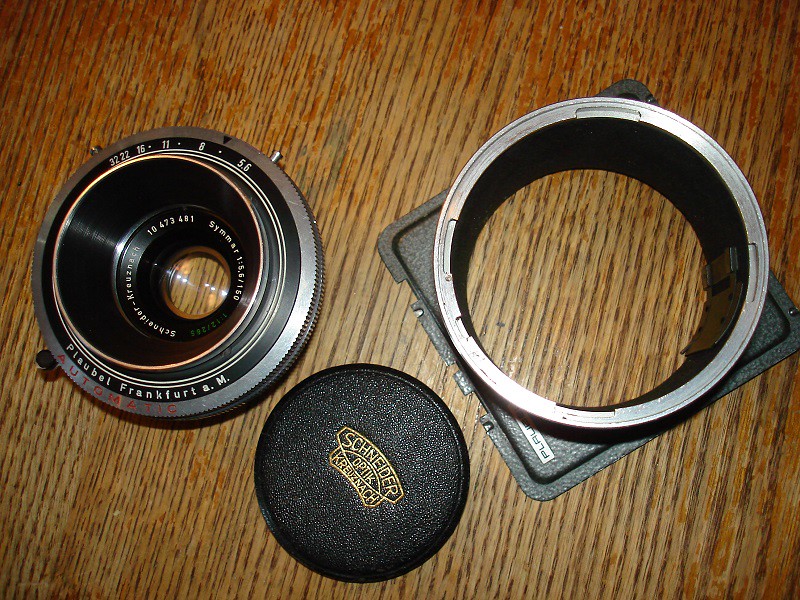

This is an example of the type of 120x120cm recessed lens board I am looking for. It was designed by Plaubel for the Peco JR View camera, but it also fits the Makiflex Standard and Pecoflex, but not the Automatic Makiflex types of cameras (due to smaller throat and cables inside the body), but is quite useful for mounting shorter than 150mm lenses. I JUST bought this one for 79 GBP from a dealer in the UK. Looks to be in beautiful shape, even has the original foam I think. Recovering the board with new strips of adhesive foam can be a real test of patience.......
Plaubel Recessed Board by Nokton48, on Flickr

How many actuations are on your camera? How many times has the shutter been fired?
I have one more thought. Try firing your shutter fifty to one hundred times. Perhaps the performance will improve and the inner mechanisms will "free up". You will not hurt the Makiflex by doing this.
OK your camera has had 48,000+ actuations during it's lifetime. So it has had a nice workout and that is good for it! Makiflexes are very tough cameras.
Plaubel is still in business, although they no longer doing repairs. But they may know of a local repairman for you!
I am told they are very friendly folks!

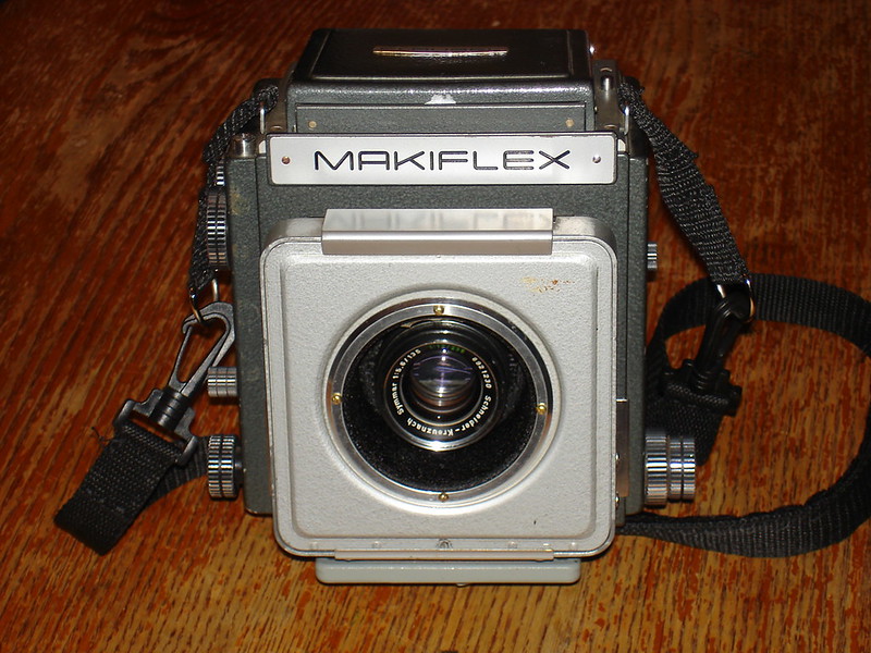

I've picked up a Fuji GX680 65mm lens cheaply from KEH. So my next project will be hacking that to the Makiflex. It will be interesting to see if it will work; The 80mm F5.6 ended up being usuable only in extreme close ups. The rear cell struck the mirror. So the lens is on it's way to me. The 65mm does not have a big rear cell. But it is big up front!
might be more usable than the 80. Has to have at least the same F-F distance...
That is exactly what I was thinking, too. I should have the lens in my hands in a couple of hours.
This arrived today in a package from Krakow, Poland. Delivery took about nine weeks, I was getting apprehensive! But now it is here and it looks absolutely brand new and probably never used. And the mechanisms are snappy and operating perfectly. Like it has been in a time capsule :smile: Even has a mint original lens cap. As previously stated, this lens for some reason was never imported into the U.S. but it's in the European Plaubel catalogs. Same thing with the Voigtlander Makiflex Automatic Heliars.
Symmar 150mm f5.6 Automatic Makiflex Lens by Nokton48, on Flickr

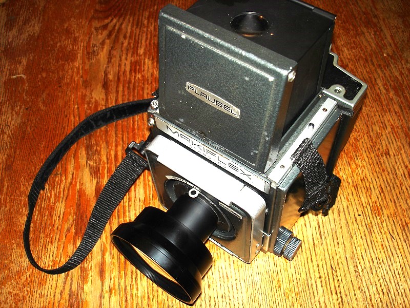

And here is the 65mm F5.6 Fuji GX680 lens hacked to the Makiflex. Amazingly it focuses easily to infinity, even well beyond infinity. But the rear cell is striking the mirror at longer distances. But as I focus forward, and get to about eight feet or so, I can fire the mirror. I can tell by viewing through this lens that it is a great one. I am so happy I have it in my collection!
65mm F5.6 Fuji GX680 lens on Makiflex Standard by Nokton48, on Flickr

Here are brief instructions on how to lube a Makiflex:
It's not hard to remove the back to access the rollers and the gears to the shutter can be seen a bit as well. There are six screws holding the back on. You'll need to rotate the back as you go to access all the screws. With the back off, squirt a mixture of naptha a few drops of watch oil mixed in, into the rollers where they meet the body of the camera. There are I think four rollers. If you don't see access to all of them because the shutter ribbon is covering them, cock the shutter to reveal them. Be careful not to get the solution onto the shutter curtains, though if a little gets on, no biggie. Squirt a bit of the solution into the gears that can be seen on the side through the slit on the side.
