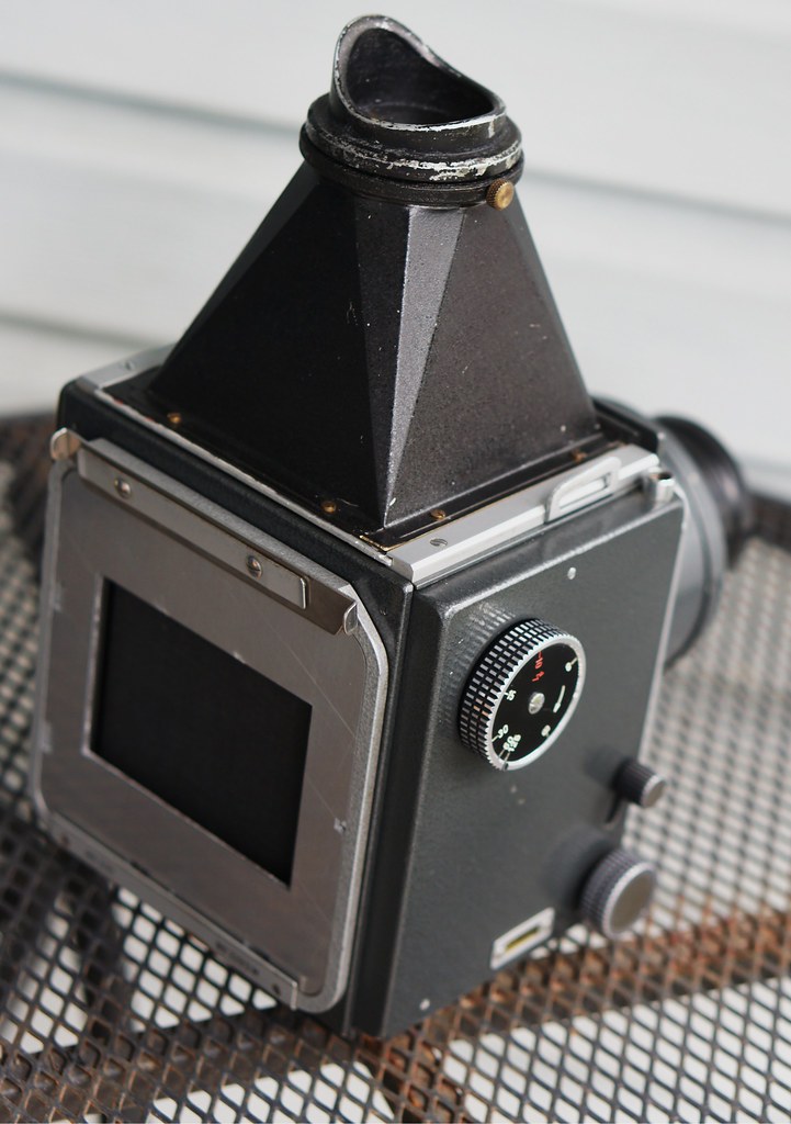

Hi~guys, I recently bought the Makiflex. It's so great~but I found the low speed dial doesn't rotate(I know the correct way to do that,but it didn't work),
has anyone else run into this issue before?Do you have any good way to fix that?Thank you~
This version,I 'm not sure what the exact model is called.
That's the Automatic. The Standard does not offer speeds above 1/125 second.
Just to be clear, the smaller dial is totally stuck? It does not rotate at all?
The smaller dial can rotate maybe 2-5 degree.My guess is that a misoperation caused this issue.
Camera Doctor (Frank Rubio) in New York City has repaired a non-working Makiflex for me. Ken Ruth (Photography on Bald Mountain) in California also repaired another Automatic Makiflex for me.

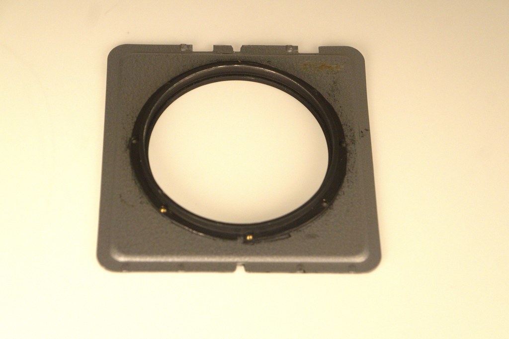

Wista Lensboard turned into Makiflex Lens Flange by Nokton48, on Flickr
I made a few of these and bought extra tubes to dedicate to certain olde lenses. Wista Lensboard cut down on my Harbour Freight Electric Scroll Saw. Hobby Brass bolts and nuts hold it together. Flat Black Krylon picked up small paintbrush touched it up. All sorts of different ways to stack the tubes for different lenses.
HiKing1983,
Welcome to the Makiflex fold here. You have the Auto Makiflex, an upgrade of the Makiflex Standard. More Slow and Fast Speeds, and Automatic Iris Operation (hence "Automatic").
"Every Studio Needs a Reflex Camera". So Plaubel said this in the early 1960's. How True! :smile:
You will need to find a competant local mechanic, depending on where you are located. Geoff Berliner gave Frank Rubio a broken Makiflex, right before I sent my Maki to Camera Doctor. Frank blew Geoff's camera apart and learned it. If Frank could do it, I suspect that other camera mechanics can learn the Maki too. It took about a year to get my camera back from Ken Ruth, he worked a few Makis over his decades of Repair Guruism.

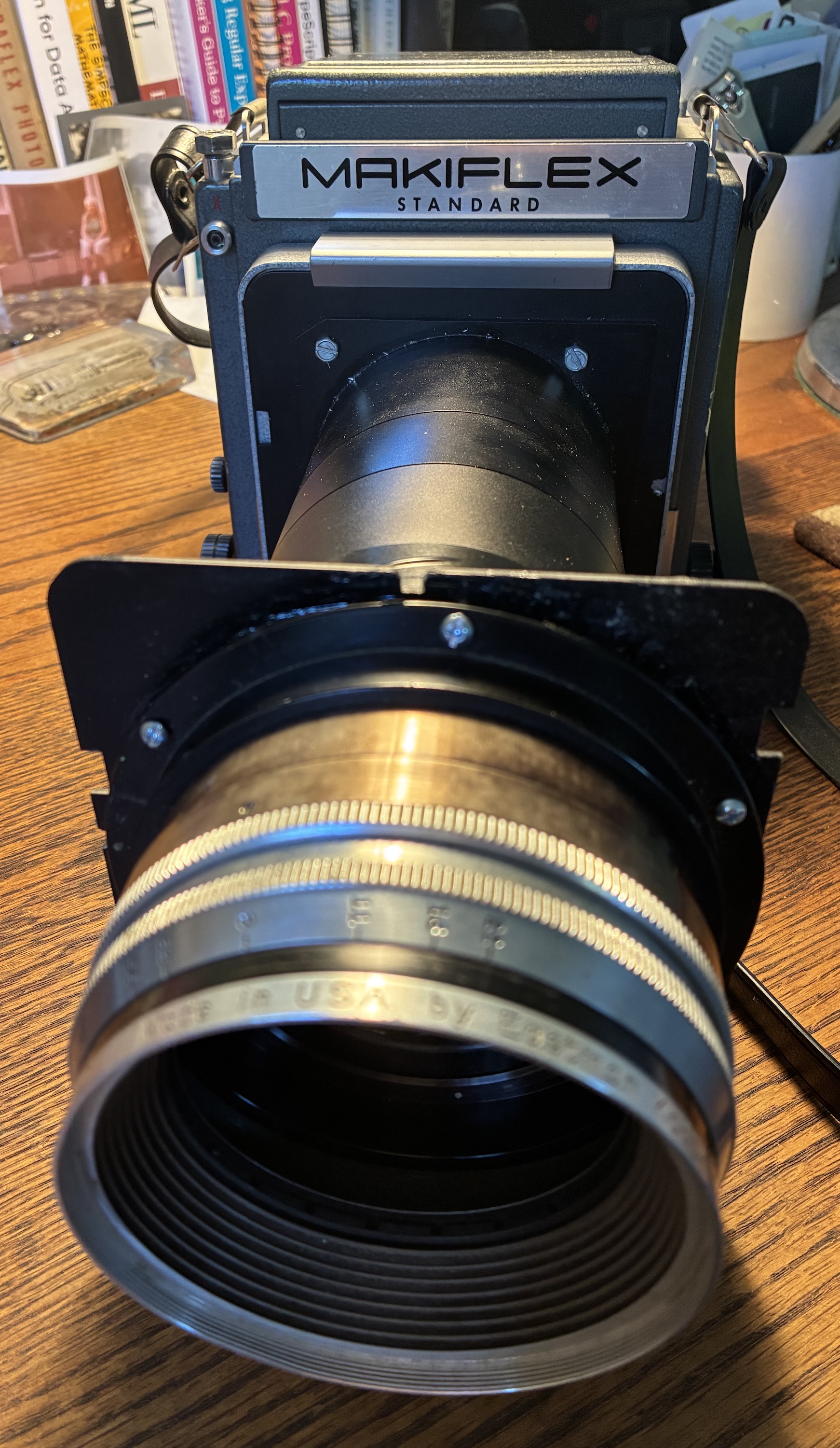

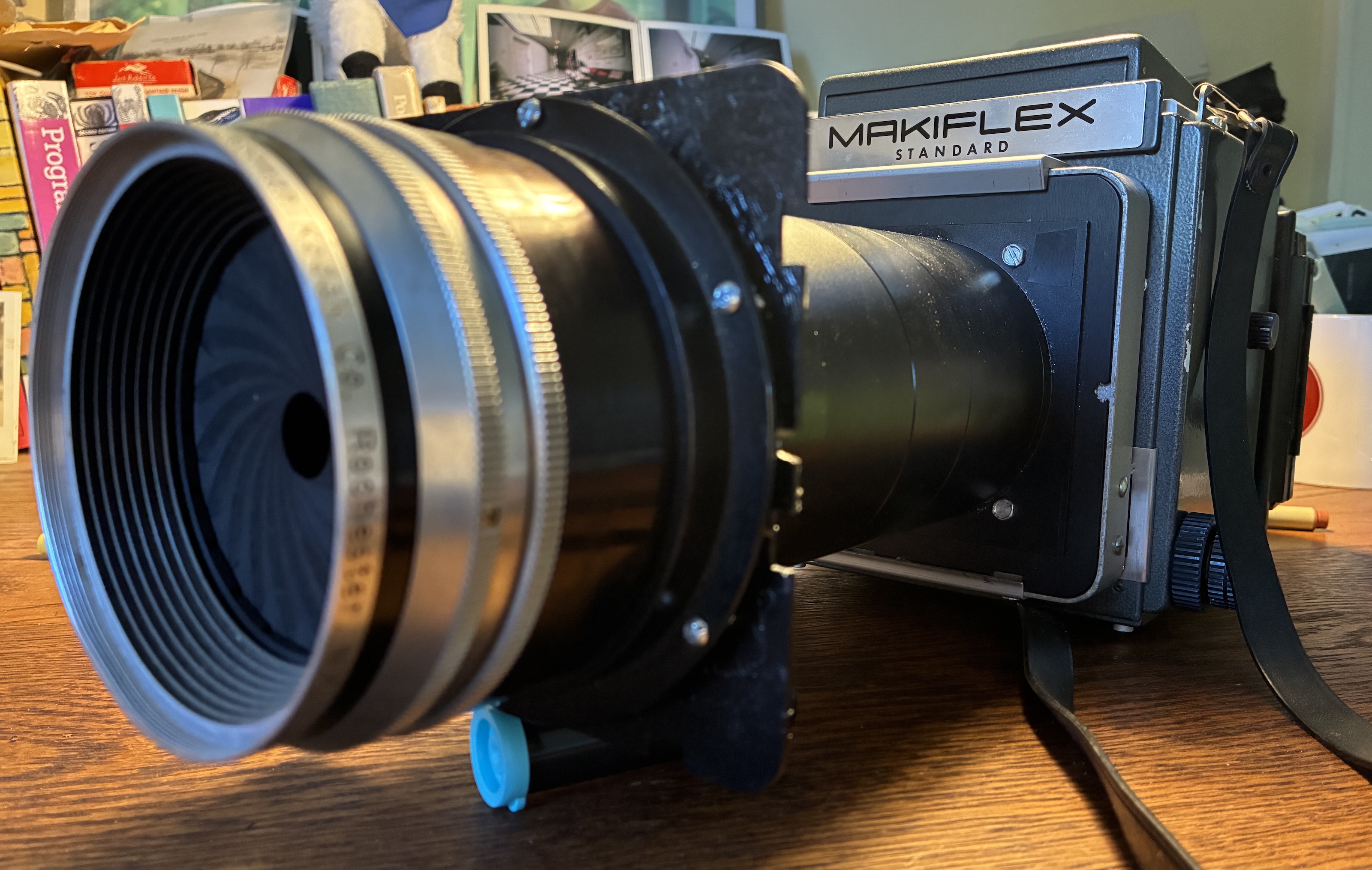

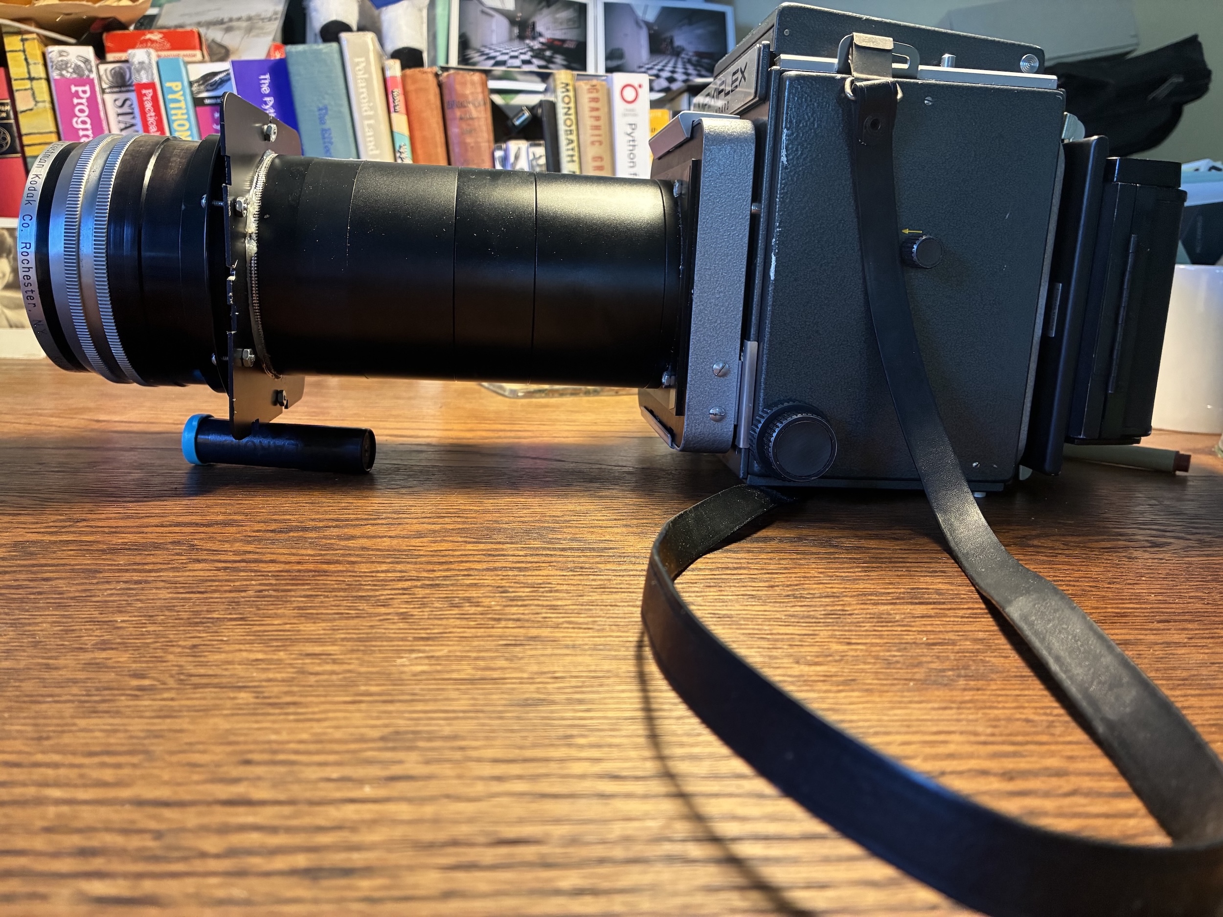

I finally managed to mount a 14" Kodak Portrait lens onto my Makiflex. I used the same Technika "top hat" modular extension boards available on Ebay that @Nokton48 has used, and two newly made aluminum Makiflex lens boards. The Technika board is bolted to one Makiflex board. Another Makiflex board is epoxied to the Copal 3 end cap of the extension board. The very large Portrait lens is bolted to the Makiflex board and end cap. I used a Makiflex board for the Portrait lens mount because it was the right size (albeit square) and strong, but mainly because I have more of them than I'll ever use.
Very Rube Goldberg, but it works!

Nice Job Orientpoint! How do you like the Portrait Ektar? It's not heavy, is it? Only two elements I believe, like my Imagons. I might add Black Flocking Paper to the inside of the tubes, once I figure out how exactly I want from all of them.

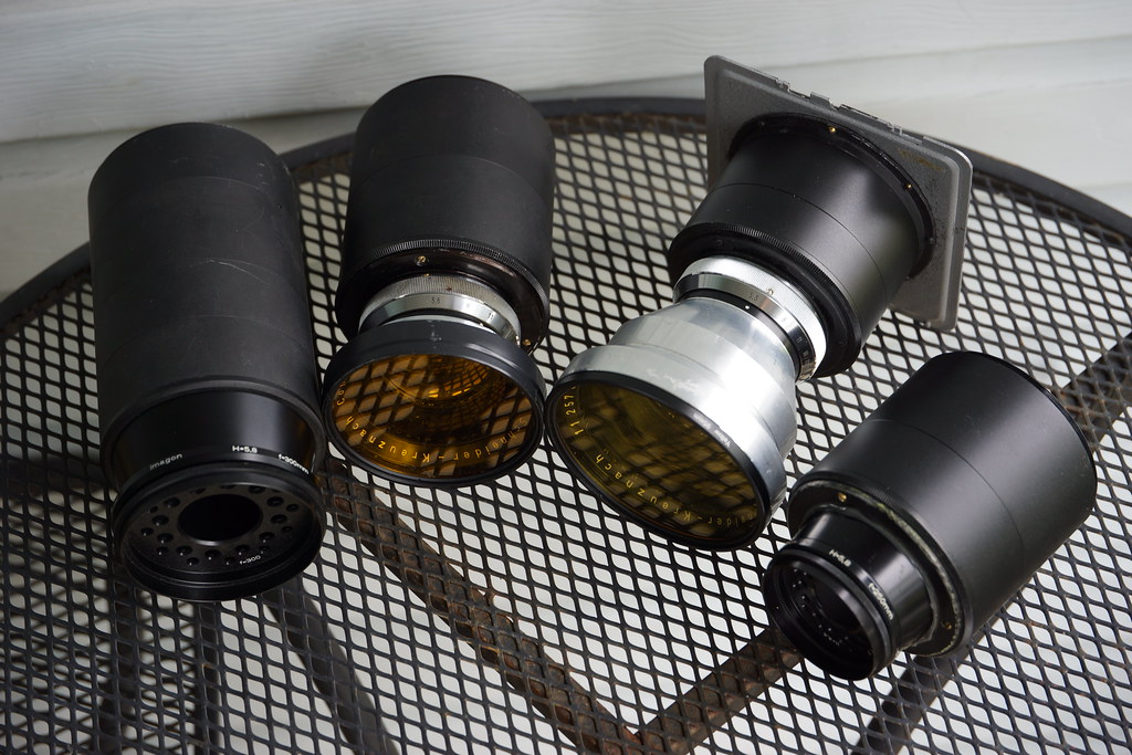

Four Plaubel Makiflex Lenses Wista Hacked by Nokton48, on Flickr
Using the Wista Tubes from China, I have hacked four classic German Lenses to Plaubel Makiflex mount. You stack the tubes until you get the focus where you want it; I usually set it so it goes just a "Smidge" past infinity. For closer shooting just add more tubes. Easy Peasy. From the left, the 300mm Schneider Imagon, then the Schneider 300mm f5.6 Componon, then the 360mm Schneider Tele-Arton, and on the right, the 250 Schneider Imagon. Need to use all of these lenses more on the Makiflexes. And I'd like somebody to 3D print simple circular (no petals) H/Stop Inserts for these. In Germany they are making STAR SHAPED Imagon Inserts. That would be nice to have :smile:
The Ektar Portrait is not insanely heavy, but it's bulky and of course the length of the tube makes it feel all the more heavy and awkward. Image quality wide open is very distinctive, stopped down it's nothing special. So that makes a bit of a problem as the Automatic has a top shutter speed of only 1/125th. I'm using a combination of slow film and lower light to allow for shooting wide open, for now at least.
I've been shooting Polaroids and film with it. No vignetting on 9x9, which was a pleasant surprise. I had expected given the length of the tube and the constraints on the opening where the lens is mounted (I had to keep some surface of the cap intact to take epoxy) that there would be some.
Those Wista tubes are not cheap, but they are really really convenient. Like you, I've stacked them so focus goes just past infinity. I had been planning to use PVC pipe for this, which would have been cheaper but in all other respects a real nightmare.
