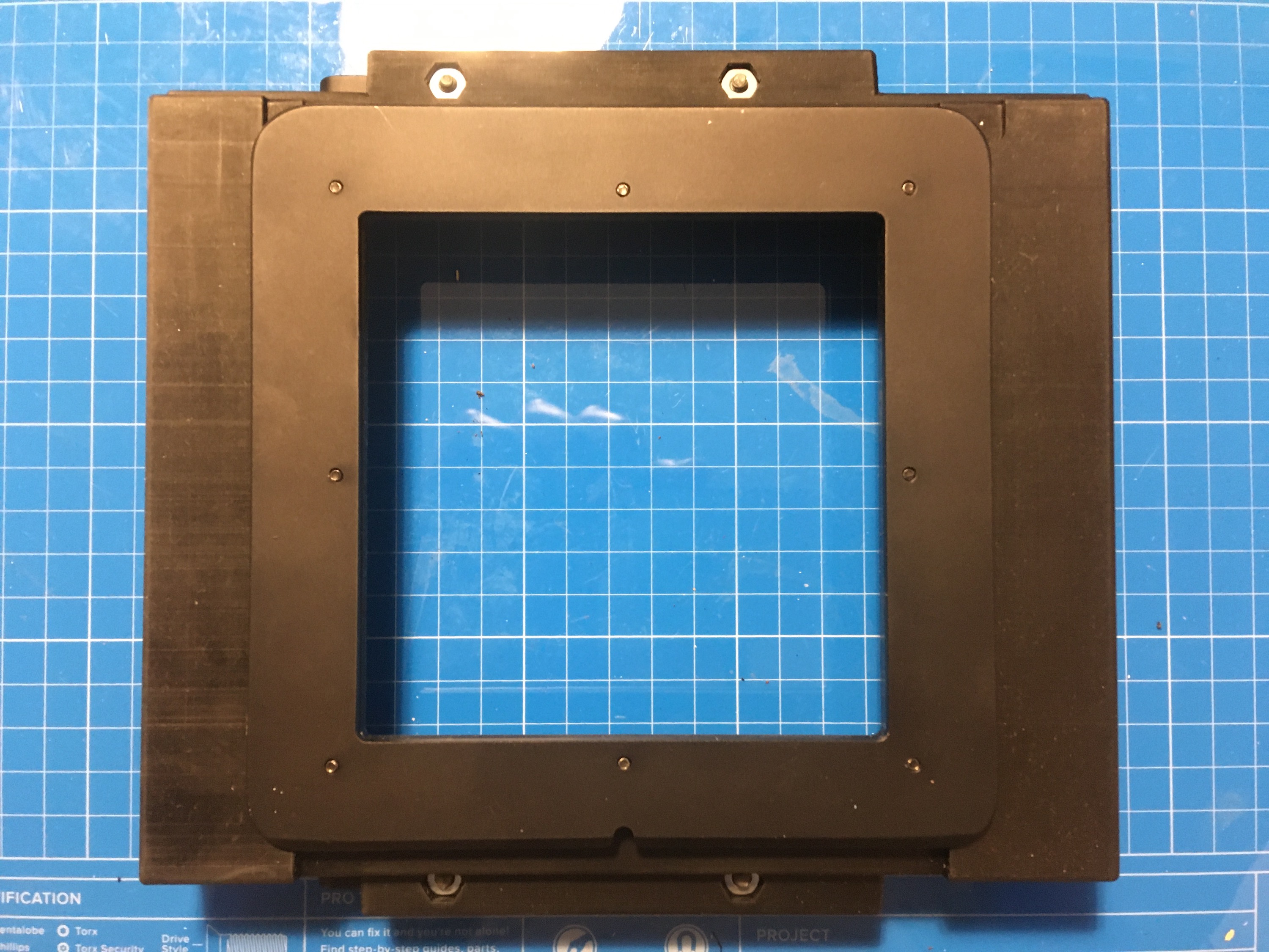

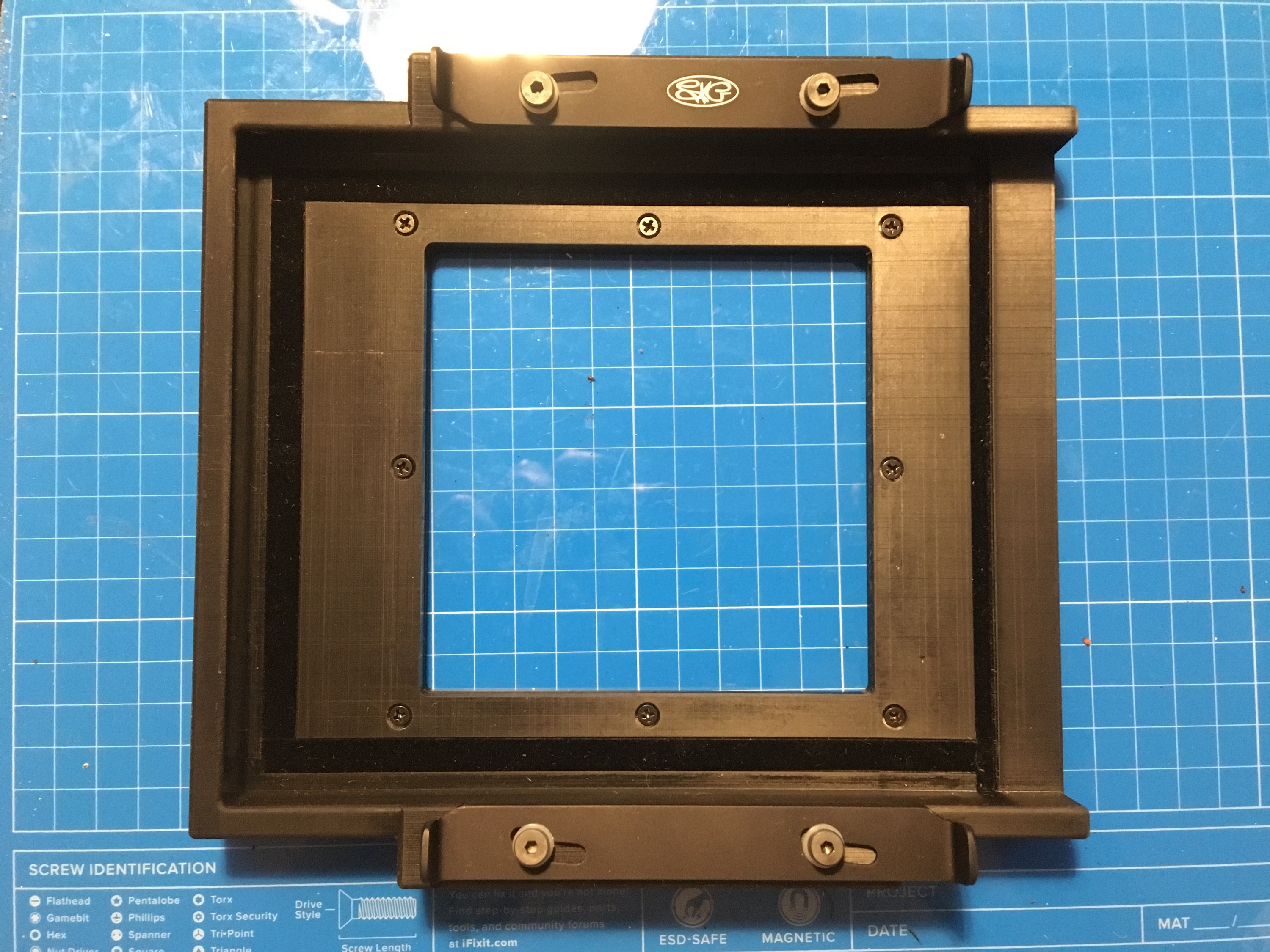

I delivered my Makiflex + adapter to SK Grimes today. We should know sometime in July what pricing and timing would be for a run of new production 4x5 adapters.
@lensretro @Nokton48 The new production adapters should be ready in a few days. Please contact me for details. If anyone else wants one we have a couple that are currently unspoken for.
Awesome! Great effort on your part. Useful and hard to find. Opens a lot of possibilities.

I picked up the Makiflex 4x5 adapters yesterday. Attached are photos front and back. It mounts nicely to the Makiflex. I shot a sheet of Polaroid this morning and was quite happy with the results!
I have sent messages to everyone signed up for one with payment and shipping details. We have one back still unspoken for. If interested please send me a message.

Gosh Those are Lovely! Can't wait to get mine. Folks the originals of these come by every blue moon or so, in my experience. Graflock opens a lot of doors to Makis. This is cool.
