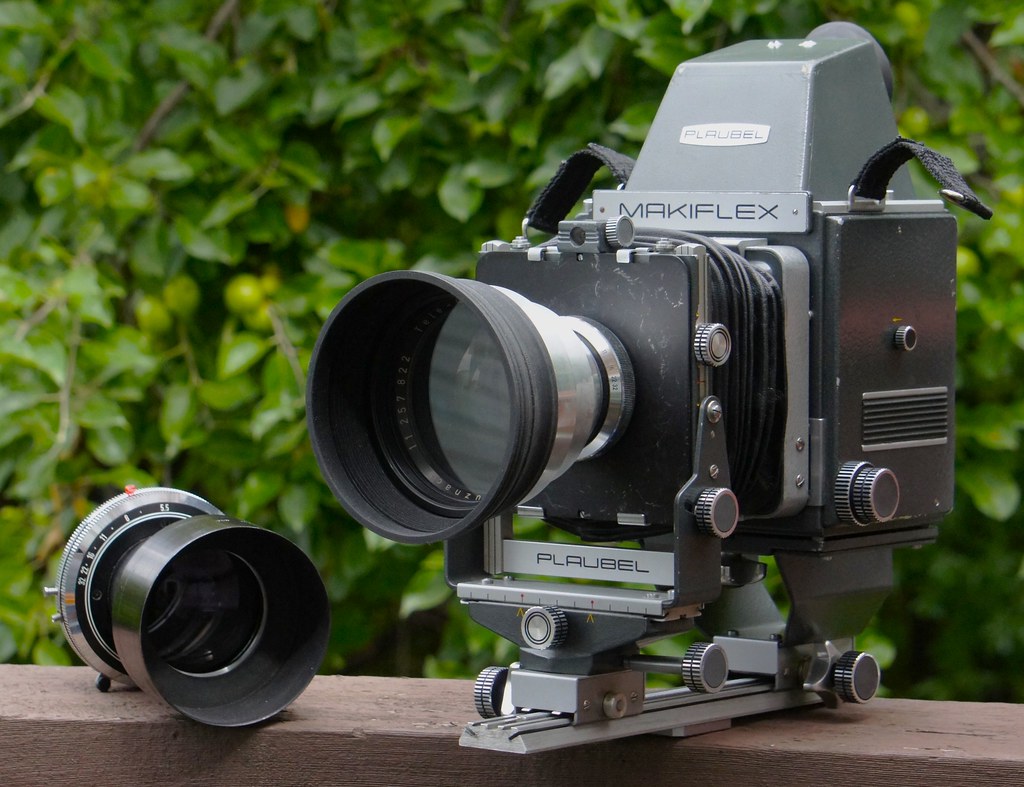

So what is new around here? Discovering the qualities and capabilities of the Pecoflex Attachment (for the Auto Makiflex). Firstly, what lenses work good with it? Well the Automatic Diaphragm 360mm F5.5 Makiflex, the full range of the lens can be utilized from infinity to super close-up. Additionally, yesterday I mounted up my favorite (barrel mount) 360mm f5.5 Tele-Arton, ditto it works with equal precision and ease on this camera. The flat board on the Tele-Arton come new from Tracy Storer at Mammoth Camera. Shorter lenses (shorter than 210) will only work in close-up mode, due to the additional extension from the Pecoflex Adapter. Plaubel had the PECOFLEX which works with shorter lens, it has a regular leather bellows glued to the camera front, you use the Peco Junior Front Standard to focus shorter lenses out to infinity. Sneebot has a PECOFLEX I misssed it when it came up on Ebay. So the Makiflex Automatic works good with 210mm Makiflex Automatic Iris lenses from 210mm to 360mm Tele-types. I tried the Auto Iris 270 Maki Auto lens I have, it won't focus to ininfity with the Pecoflex Adapter. But it would work good on the Pecoflex!
You have front swing, front tilt, front rise, and lateral displacement with the Pecoflex Adapter on the Auto Makiflex. So you can do view camera movements hand held, I have done it!

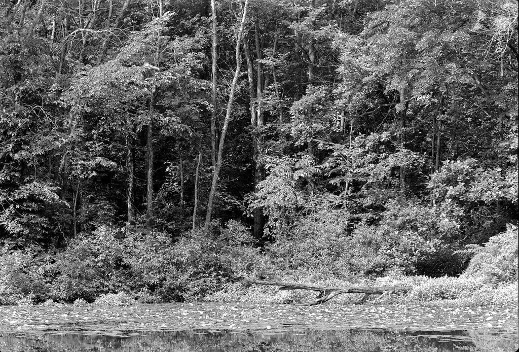

360mm Tele Arton Makiflex Agfa APX100 Legacy MicX by Nokton48, on Flickr
Infinity focus test of the 360mm F5.5 Tele-Arton on the Makiflex. A lazy Saturday morning at the local park, my wife and her birding friends were waiting for something to swoop in. Agfa APX100, Microdol-X straight 24 minutes at 18C Jobo Multitank 5 on a Unicolor Uniroller.

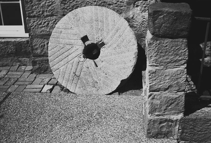

Makina3 #2 by Nokton48, on Flickr
Plaubel advertised the Makinas as "The Worlds Smallest View Camera". Using a Makina in some ways is like that in terms of use. Foma 200 developed in replenished straight Microdol-X. Exposure bracketed in half stops to give myself a choice. Plaubel Makina IIIR with 100mm F2.9 Anticomar Plaubel 6x9cm back Arista #2 RC paper Omega DII laser aligned Multigrade dev Omegalite diffusion head

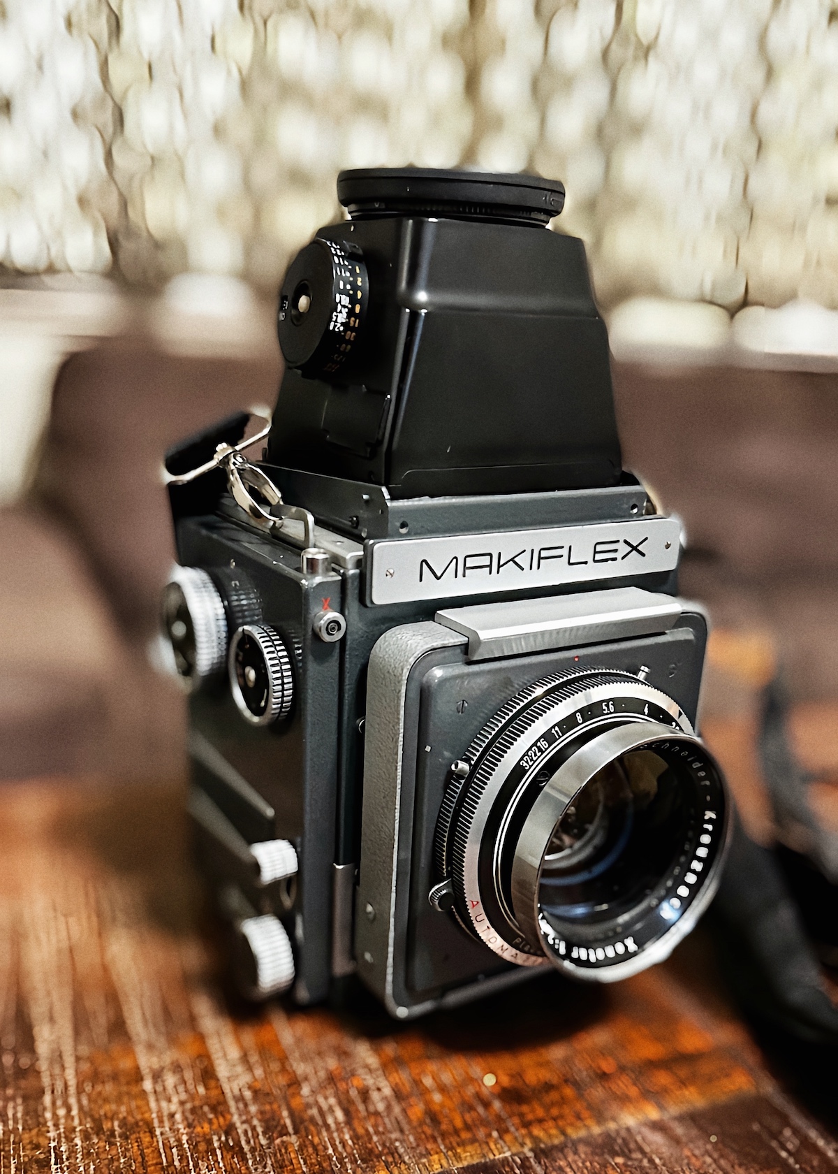

I have emulated Dan and successfully mounted a Mamiya RB67 chimney finder on my Makiflex. I chose to leave the light meter intact, and now I have a built in working light meter!
I ended up getting a very reasonable deal on this photodiode chimney finder on ebay - only $70USD. I then cannibalised a spare Makiflex waist level finder hood I happened to have. This was a destructive process, I don't think I'll be able to reassemble it again. However, I don't think I'll want to, this finder has a diopter, the built in light meter, and much better light tightness.
The only downside is it takes up a lot more room than a collapsed waist level hood finder. I will have to remove it for travel.
Thanks for the inspiration Dan!

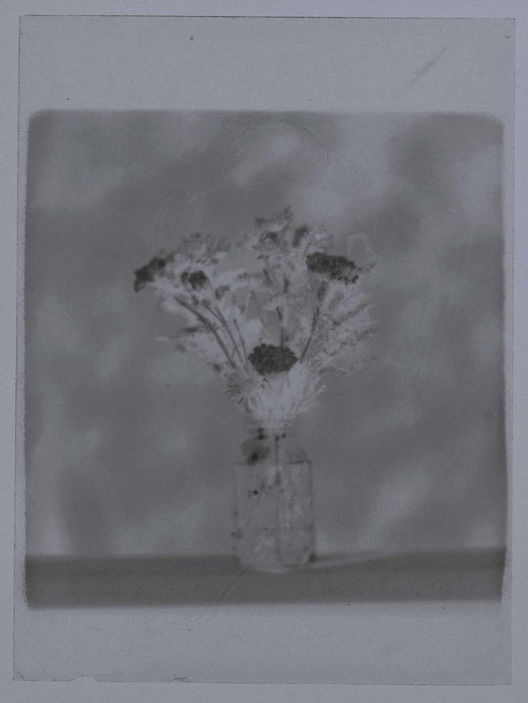

Makiflex JLane 9x12 Glass Plate EI 1 Key Day by Nokton48, on Flickr
Jason Lane Dry Plate 9x12cm Makiflex Plate Adapter Makiflex Automatic Key Day Full Sun. Legacy Mic-X tray developed under safelight. I'm in the process of setting up a film digitizing setup Minolta SRT Copy Stand Minolta Bellows Minolta 100mm F4 MC Bellows Rokkor at F13.5. Sony Nex 7 with SRT Adapter.

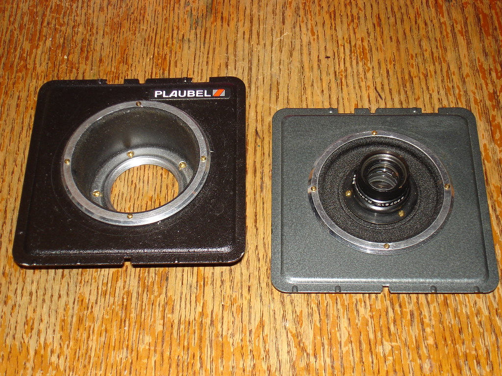

However, Durst made an enlarging recessed board, called the IXOTUB, which will fit the Automatic Makiflex bodies, I attached a few to slightly recessed 120x120mm Plaubel boards. It's very difficult to get your fingers in there to adjust aperture, but can be doable!

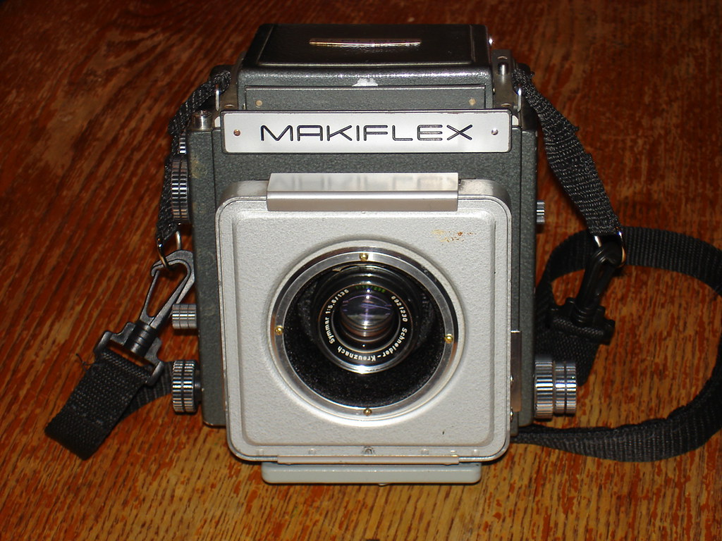

I have had good luck with a barrel mounted chrome 120mm f6.8 Schneider Angulon, it will fit the Auto Makiflex. This will work on your camera but it's about the only option I'm aware of. BTW the barrel Angulon is a great lens and usually not expensive.
Picture above shows a 135mm Symmar on Auto Makiflex, but the 120mm works and fits about the same.
Durst recessed boards and 150 Apo Ronar by Nokton48, on Flickr
These Durst Recessed Enlarging Cones work good for smallish barrel lenses on the Auto Bodies. The Durst IXOTUB is on the left, sometimes substantial metalworking is required to create your Makiflex Frankenlens. I told Geoff Berliner about the IXOTUBS and he bought a few I believe. They are great for building and not 'spensive
