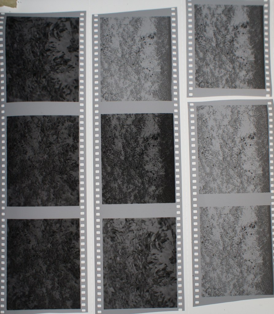

70mm Kodak WL Surveillance Film D23 1:1 20' 62F by Nokton48, on Flickr
Plaubel Makiflex Graflex RH50 70mm Back, Kodak Surveillance Film, D23 1:1 20 minutes at 62F. Two reel Paterson Tank Modded 70mm Reel holds 220 length, I like the WL Surveillance (bank camera film?) very high speed, pushes to 1600 EI with good results. As you can see I bracketed the roll to give myself choices in negative selection. 70mm HP5+ also available and has a different rendering than this stuff. The D23 provides a wide range of soft tonality that I kind of like. Previously I have been developing this film in replenished ADOX Borax MQ, which results in a much "beefier" looking negative. Good to have a choice

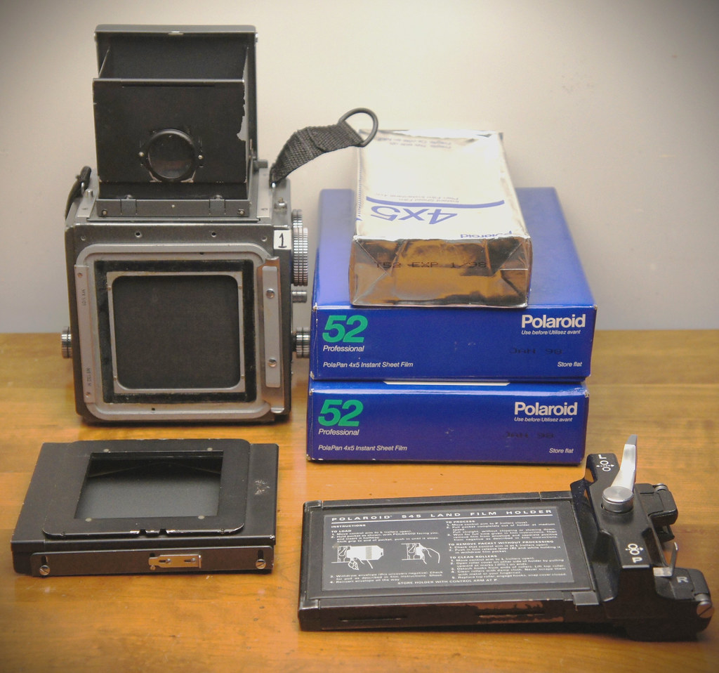

does anyone have a makiflex polaroid adapter they'd be interested in selling? The one for 4x5 pack film would be ideal, but I'd take a regular pack film one as well. I just got a makiflex in pretty good shape and a dying to shoot my pack film stash with it.
amerz,
Welcome to Makiflex! My favorite camera to use
They made a Graphmatic Back which holds Polaroid Holders, they are kind of rare but they do pop up. I have a Back for Graphic/Linhof 4x5 Sheet Holders, that will take the single shot 4x5 Polaroid. I have a small number of sheets of Polaroid #52 B&W with negative, that I am holding back for special use. Perhaps somebody here can sell or trade something for what you need?
How about a picture of your new treasure! Congrats What lenses are you planning to use? Limitless possibilities
I've been looking for 5+ years and have yet to see a Makiflex Polaroid pack film back. I'd love to get one as I too have type 600 packfilm to shoot.
I've see a few MX 1/126 6x9 cut film holder backs over the years but that's pretty much it. They seem to be the most common. All of the others are seemingly non-existent. The back you really want is the MX 1/539, which will mount 4x5 graflok type backs, including the Fuji PA-45 and Polaroid 550 4x5 pack film backs. I was fortunate to find one of these about 3 years ago, but it was the first and only time I've seen one for sale. It's just a bit of metal, but the spacing and sizing is tight so it is not an easy thing to hack together if you're not a machinist. Maybe someone could 3d print them, but I'd say the Makiflex market is quite small so it probably won't happen :-(
In sum try to find (or make) and MX 1/539 as that'll let you shoot 4x5 film (including Polaroid) as well as 600-series pack film (via a 4x5 405 back).

I was gifted some Kodak Readyload TMX100 and also some Ektar Readyload 4x5 film. I've been shooting up the TMX100 with this setup. The Plaubel Makiflex Adapter for Linhof and Graphic Film 4x5/9x12 Holders. Works good. This will also work with the Fuji Quickload 4x5 Backs. A flip of the switches top and bottom, and it goes from WIDE Linhof, to NARROW Graphic holder widths. Here it's set for Graphic Holders.
How does that old Polaroid 52 work? I have some 10 years younger than yours and while it works, it pretty much black and white and nothing in-between.
Last time I wasted a sheet it looked pretty good.

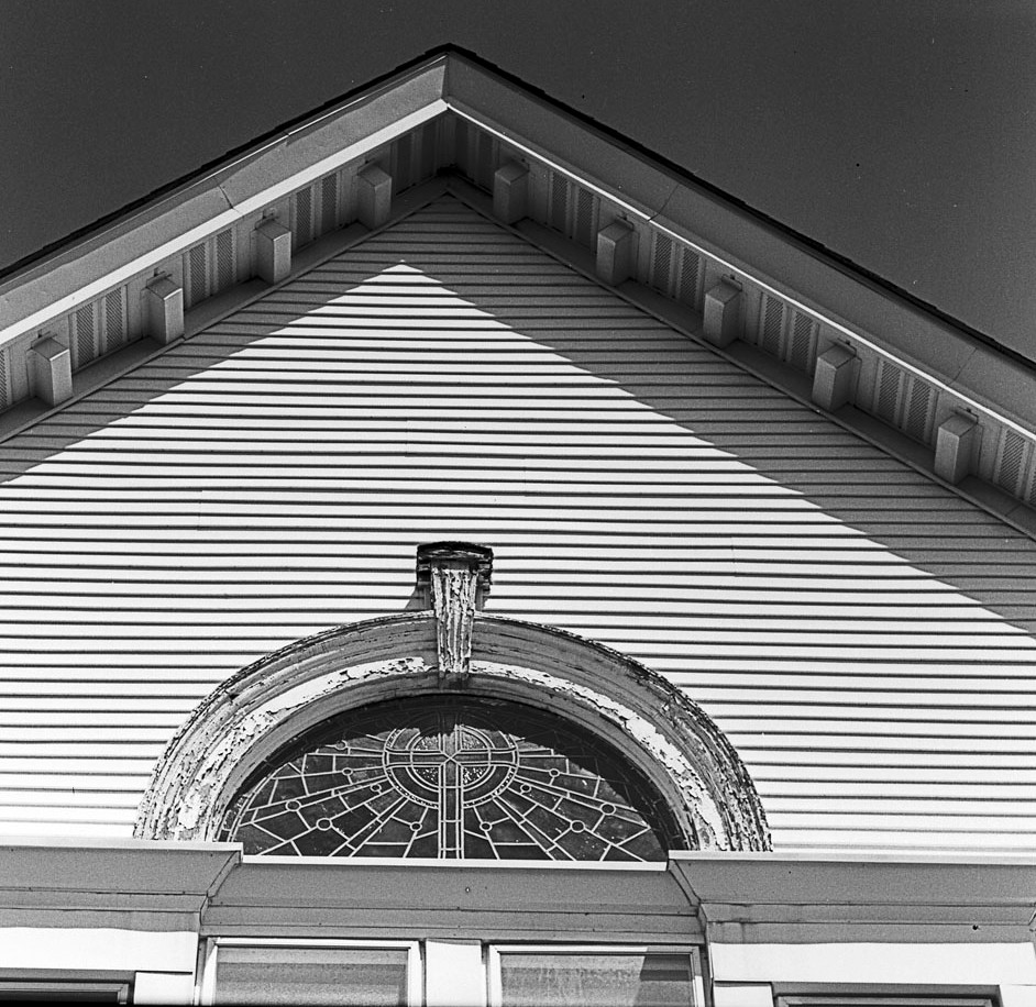

Scan-150209-0001 by Nokton48, on Flickr
Plaubel Makiflex Automatic, 180mm Schneider Xenar Plaubel Automatic lens, 1/60 at F9.5, EFKE PL100 9x12cm film. Developed in ADOX Borax MQ developer. Scanned on Epson 4490 Scanner. Handheld image

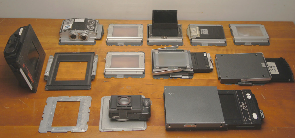

My collection of Plaubel Makiflex Film Backs. Here also is the highly desired Plaubel Makiflex Graphic Graflock Film Back, with the Graflock Clips. BTW all these holders are loaded with film ready to go. And one is 9x12 glass plate. As you can see the most plentiful back is the Plaubel Makina Double Rail Back. The 6.5x9cm film plate holders are fun to shoot, but are heavy to carry around. Good thing they came out with roll film :smile: European shoppes sell the planfilm

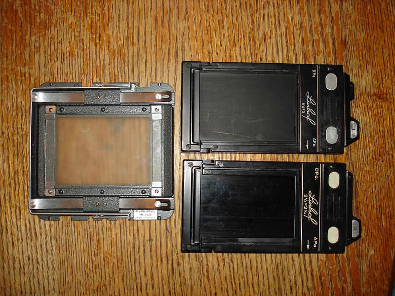

2x3 & 6x9 Holders Makiflex by Nokton48, on Flickr
Also this Makiflex Back will take the 6.5x9cm and 2x3 Linhof Plate Holders. Will hold film or glass plates. The Guy at the local hardware store cut the glass for me and did a great job.

SONY DSC by Nokton48, on Flickr
Thanks, this is very helpful to see! The Graflok back is on the left, middle row, next to the roll film back, correct?

Yes the Graflock one is on the middle left, next to the Graflex 70mm Film Back. The thing in the middle front is a Sony Nex3 Digital Body, JBWelded to a Plaubel Makiflex 120x120mm Lens Board. So I can shoot digitally with the Makiflex.

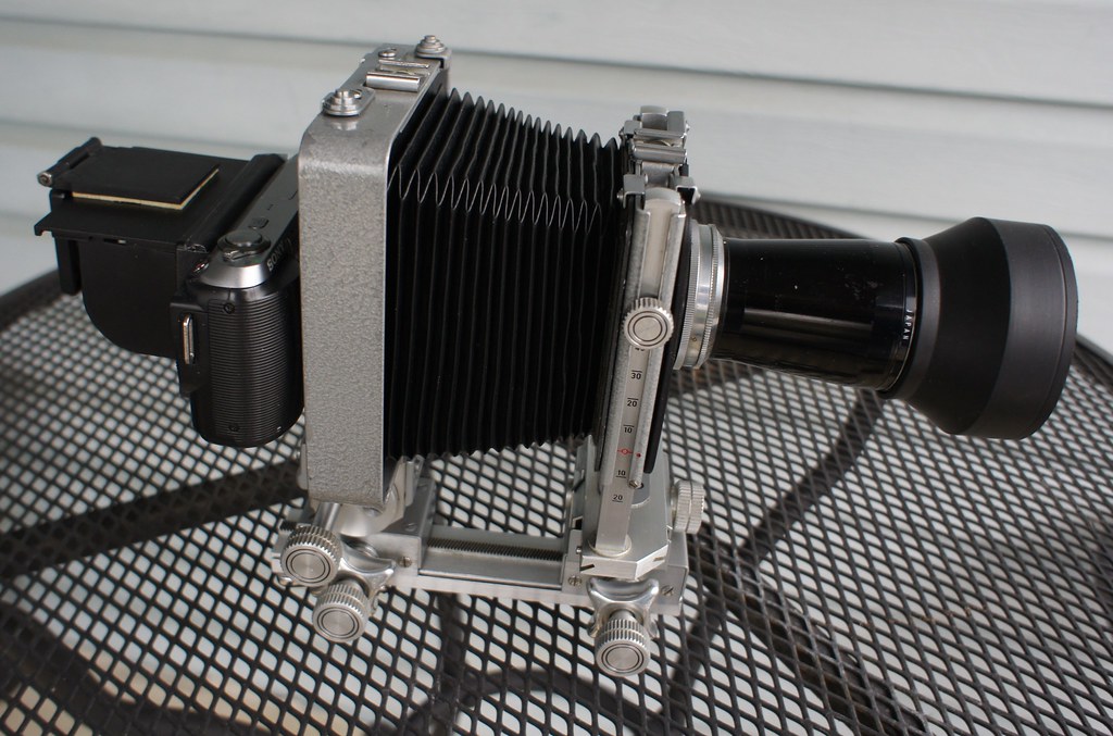

Initial test of Makiflex Digital Back! Auto Makiflex #1 150mm f5.6 chrome Schneider Symmar Auto Iris Plaubel Makiflex lens mount. Key Day F11 Easily hand holdable, great way to test all my lenses. Much fun ahead. If I want I can switch to film in 30 seconds, although the camera needs totally reset in that case. But so versatile.

Thanks. The point is it's a lot cheaper (and different) from pulling test "roids. So since all you need is a PJ1 Makiflex Board with proper sized hole, and a mirrorless digital body (I chose the "E" mount Sony cheapo, bought used from World of Used Photography for Sixty Bucks. Lots of digital fun with Plaubel Maki lenses for very little money.
This is rainy foggy day handheld digital view camera photography. Plaubel Peco Junior with 240mm Schneider black barrel Tele-Arton wide open. Handheld exposure NexC3 Digital Back. I like the bokeh and lower contrast rendering, thanks to the olde Tele-Arton formula. Making up this digital unit enables me to use this lens for the first time :smile: Lens mounted on 3D printed board from Italy, I added light foam trapping and it works OK
