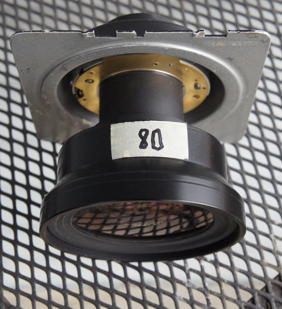

It's been a while since I have worked on my GX680 Maki Hack collection. Yesterday I cut a larger hole in this Peco Jr recessed board, to fit this GX680 80mm lens. Putting it on my Maki Std, it is a closeup only lens, with dramatic wide angle perspective on the full 9x9cm format. Beautiful bokeh. I also have the 100mm setup this way, which will work for out to moderate closeups. I mean the lens is about a foot from the subject with the 80mm to be in focus. Worth havng this.
To finish the lens I will need a broken RB67 shutter which I usually get from broken 90mm or 127mm lenses. This is a Seiko shutter of the correct type that the GX680 cells front and back are properly spaced. I remove the shutter blades as I only need the barrel and the iris. Then put an f/stop scale on the perimeter of the board and she's done

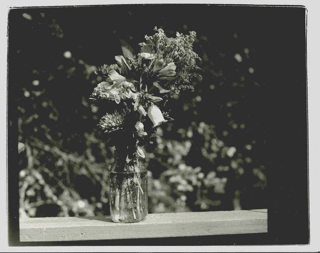

Makiflex 9x12 Voigtlander Plate Holder Maki Plate Back D23 by Nokton48, on Flickr
Makiflex 9x12 Maki Plate Back Voigtlander Plate Holder 9x12 ORWO22 D23 Omega DII laser aligned Arista RC #2 Multigrade dev. This plate holder is prolly a hundred years old, yet it works! I was enjoying morning coffee and sunshine when I exposed this one
Makiflex TMX100 Kodak Readyload 545 D23 by Nokton48, on Flickr
TMAX100 4x5 Readyload 545 Back Makiflex D23. Omega DII with Omegalite laser aligned Arista RC #2 paper Multigrade dev. Digital background shot by Tim Layton and enlarged at Cosco. Studio overhead lighting. 150mm chrome barrel Schneider Xenar that I bought for fifty bucks. Great lens.
Petzval type unmarked brass projection lens Makiflex No iris by Nokton48, on Flickr
Unmarked Petzval type beautiful brass Projection Lens vintage late 1800's? Central stop removed, very swirly beautiful bokeh. I'd guess 200mm focal length, I wanted speed and I'd guess about F3.5 wide open. Sharpest in the center, central bouquets were focused on and are sharp! Depth of Field is near nil. Orwo NP22 9x12cm I bought in bulk from Bulgaria. Voigtlander Makiflex Plate Holder pretty good match. RADA made plates for Plaubel and were hooked up with them for a good while. These tend to light leak and I've retrapped a lot of plate holders, could maybe be improved? Yes. I also have some French and Russian Plate holders that seem to work as well.

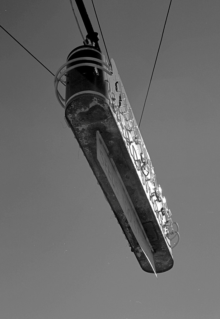

To shoot this image of Connell's Hardware sign, I was crushed up against the front glass window, in order to shoot at this obscure angle with tripod. The Fuji GX680 100mm F4 optics, transplanted into a recessed Plaubel Peco Jr lensboard, then onto the Plaubel Makiflex Standard body. Ilford FP4+ 6x9cm Makina rollfilm, processed in Legacy Mic-X straight and replenished. Scanned on an Epson 4490 scanner
The GX680 100mm F4 is a great lens on the Std Maki, but only for closer shooting, the rear group focuses to infinity, but unfortunately strikes the mirror, so the camera won't fire. But it works great for closer-in shooting and WOW it's wide on a Maki!
According to Plaubel back in the day, 125mm was as wide as you could go with Makiflex. Not so with modern Fuji optics :smile:
