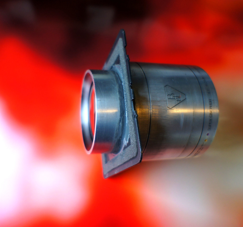

First test roll of hand spooled 1992 vintage 70mm Kodak 400 Tri-X Professional Unperfed film. Rated at EI 400, extremely dark stormy rainy day on my back deck. Camera was Plaubel Makiflex Standard, lens is Bausch and Lomb Super Cinephor 159.1mm F2.0. A movie theatre projection lens intended for projecting 35mm and 70mm movie film in cinema houses. Film back is Graflex RH-50 18 shots bulk loaded. Film processed in D23 1:1 12 minutes at 74F in single reel Paterson dev tank. RC 8x10 print Arista #2 Matte developed in Multigrade. Omega DII laser aligned 180mm black Rodagon lens. Camera was handheld at the Makiflex Standard's top speed of 1/125. I really like the "look" I am getting with this extremely unusual lens. It's quite a heavy rig so I get a gym workout to boot. I am really diggin' all this 70mm stuff at this point. 18 6x7 exposures fits into two Vue-All 70mm pages when cut into threes.

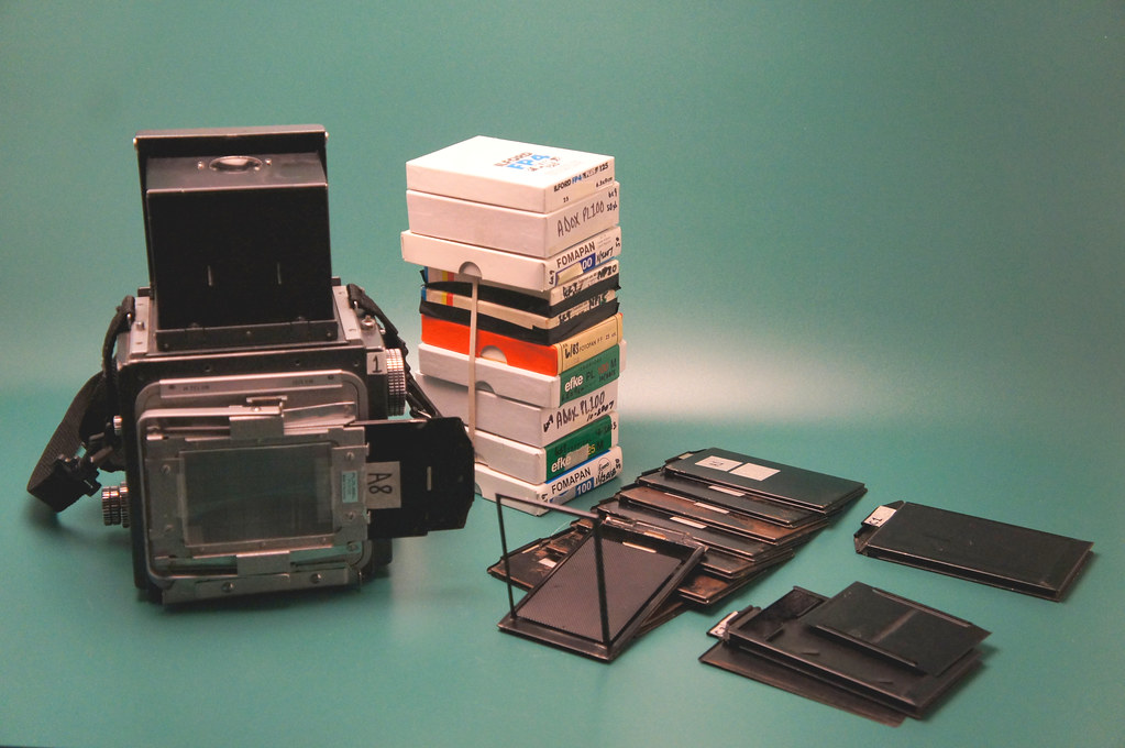

Plaubel Junior 6.5x9 Monorail Makina Backs by Nokton48, on Flickr
Have 50+ Makina 6.5x9 planfilm holders, and about as many RADA glass and film holders. Also have a good supply of 6.5x9 Makina backs in 6x6cm and 6.5x9cm. Many lensboards here Peco Jr which were my mistake, this stuff looks kinda identical some times. I do have a Pecoflex Adapter for my Makiflex Autos, it's identical to the front end of the Peco Jr so I already like the handling. I have most of the original lenses in the catalog, just need more Peco Jr 95x95mm boards to move them around to. Starting with the 47mm chrome Super Angulon, up to the 180mm chrome Symmar. Should be another interesting system which fits in with my other stuff. And I am contemplating a medium format digital back in the far future and this could very well be the ideal platform for it!
