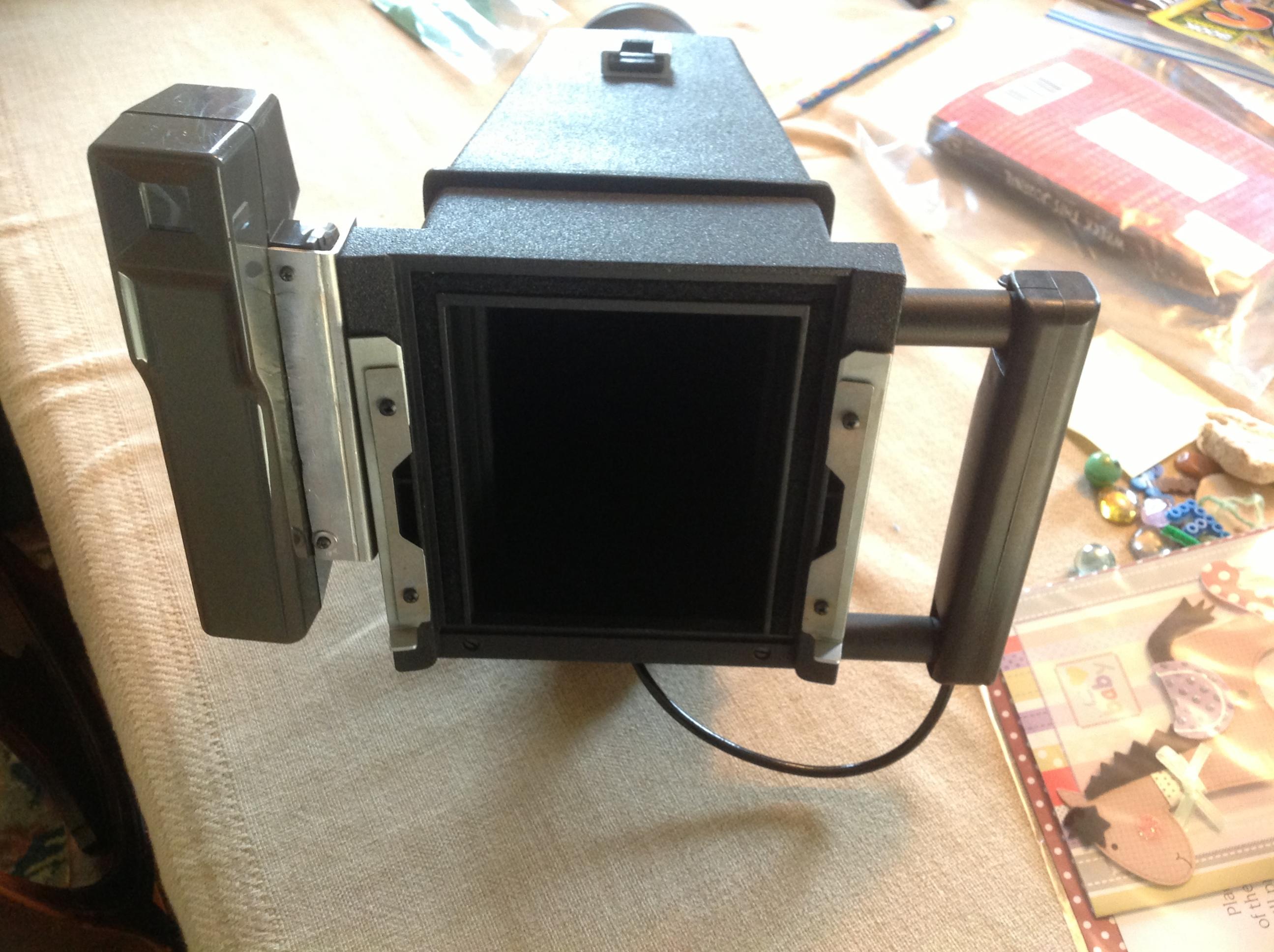

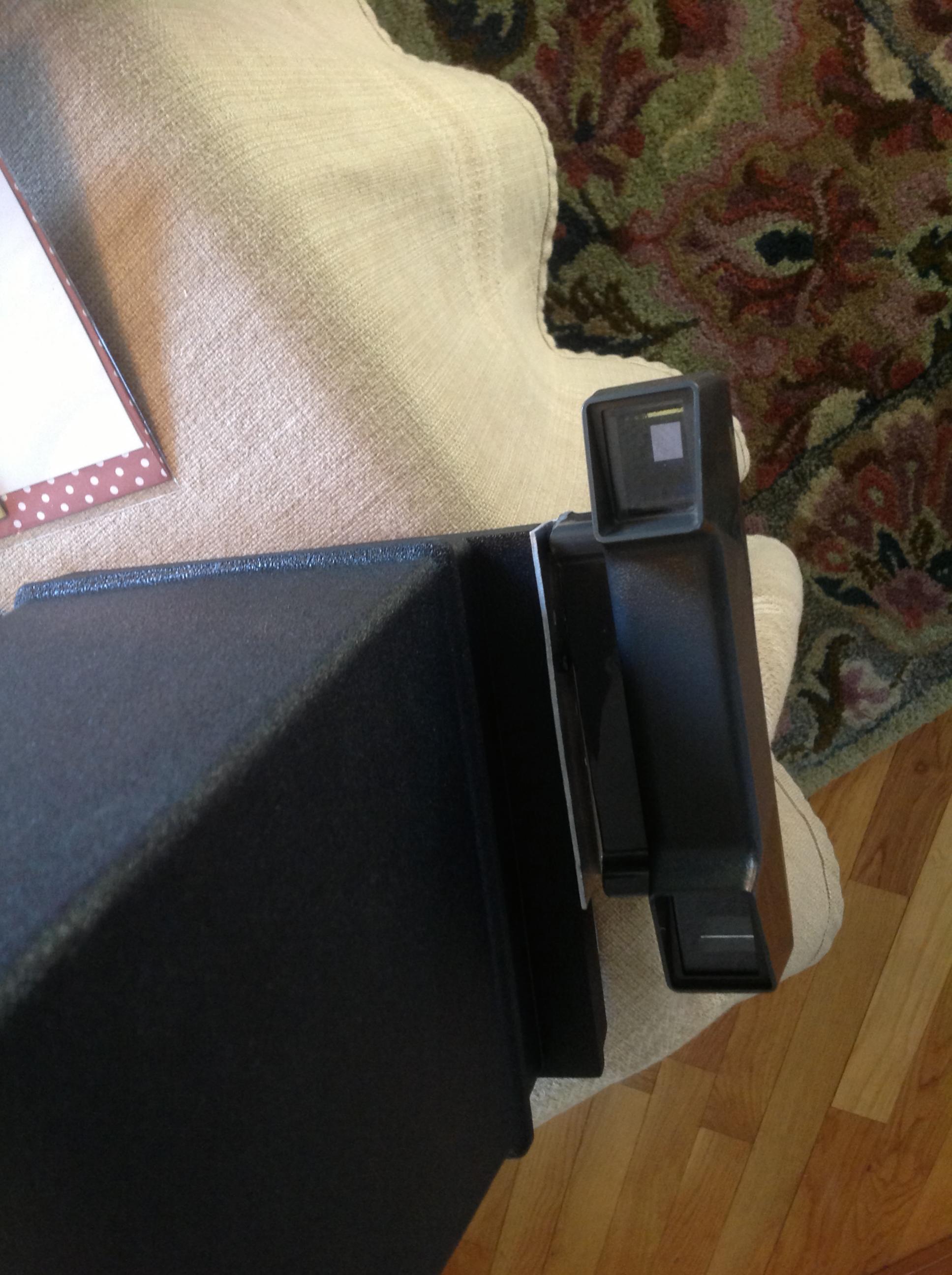

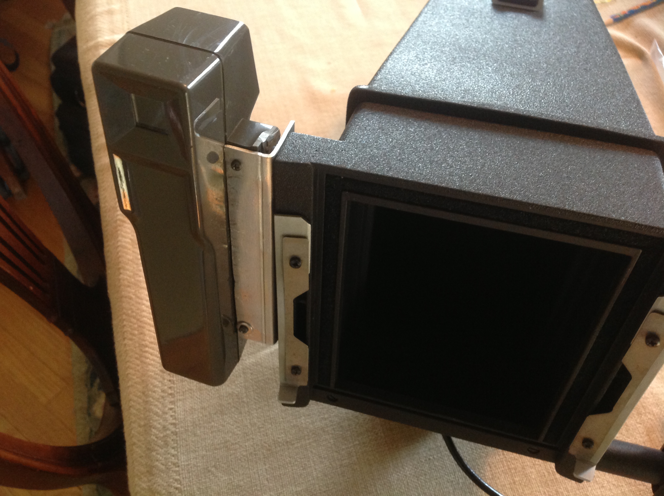

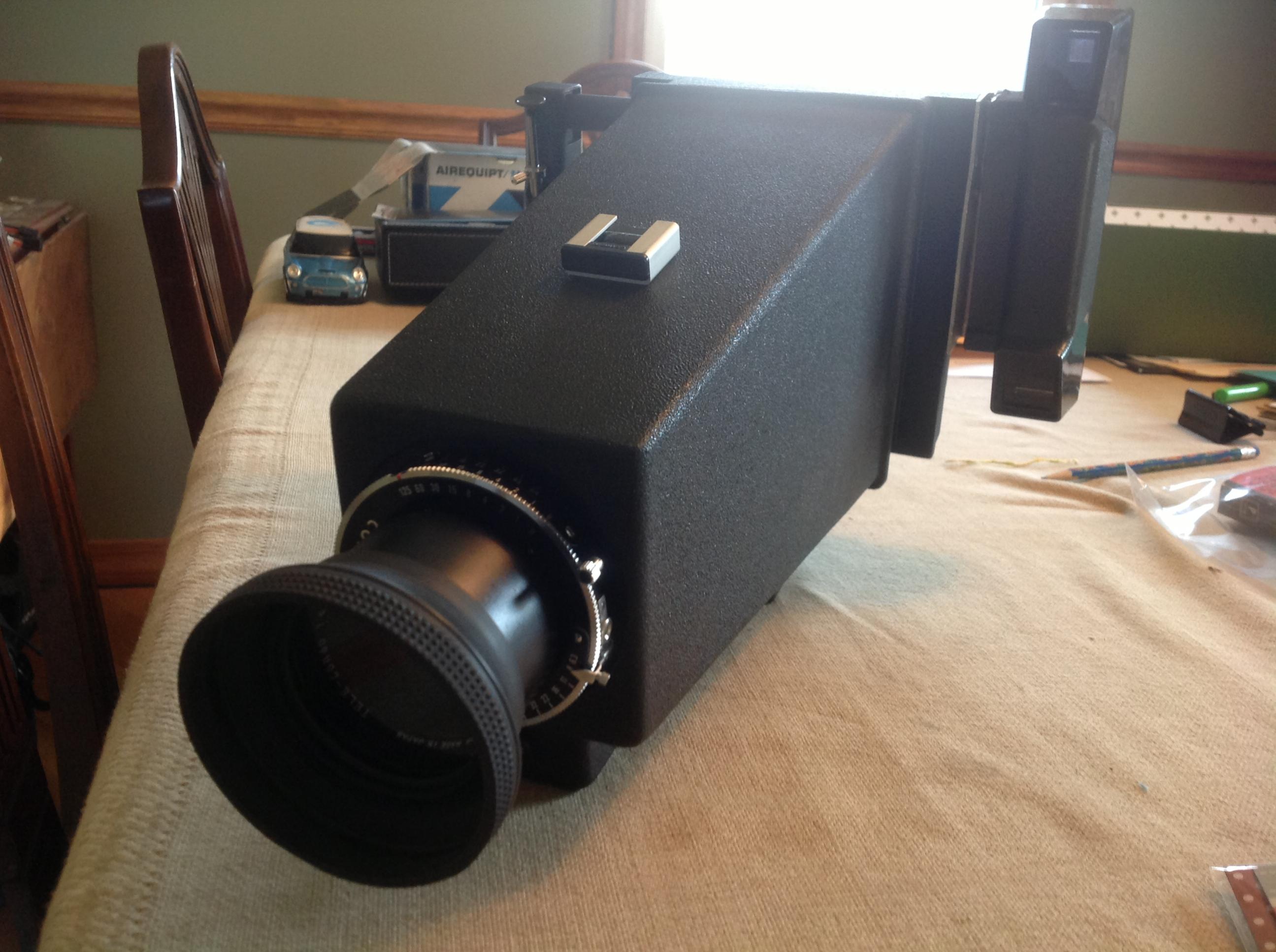

I fitted a rangefinder from a Polaroid BigShot onto a Cambo Maxiportrait. It works great, perfect for hand-held head-and-shoulders portraits. Credit goes to Misko for the idea! I have another Maxiportrait and Bigshot that I will combine similarly soon.
Hey Ed!
How you've been?
I've just yesterday tested my Cambo Maxiportrait with it's "string" focus :smile: and realized it works!!
I've also ordered the Lomo rangefinder to attach to the camera for faster focusing.
As I see you did what we discussed before on Large Format Forum (thanks for the credit, so sweet!). Can you tell me if the "framing lines" are correct when Big Shot's RF is used? Our idea is so much nicer than my route, since View Finder & Range Finder are combined together, but I don't have an extra Big Shot on hand & ordering one from US for me comes way too expensive to justify cutting it's RF for this purpose. Wish I was living in US just for all those dream cameras!
Is focus good enough for wide open shooting?

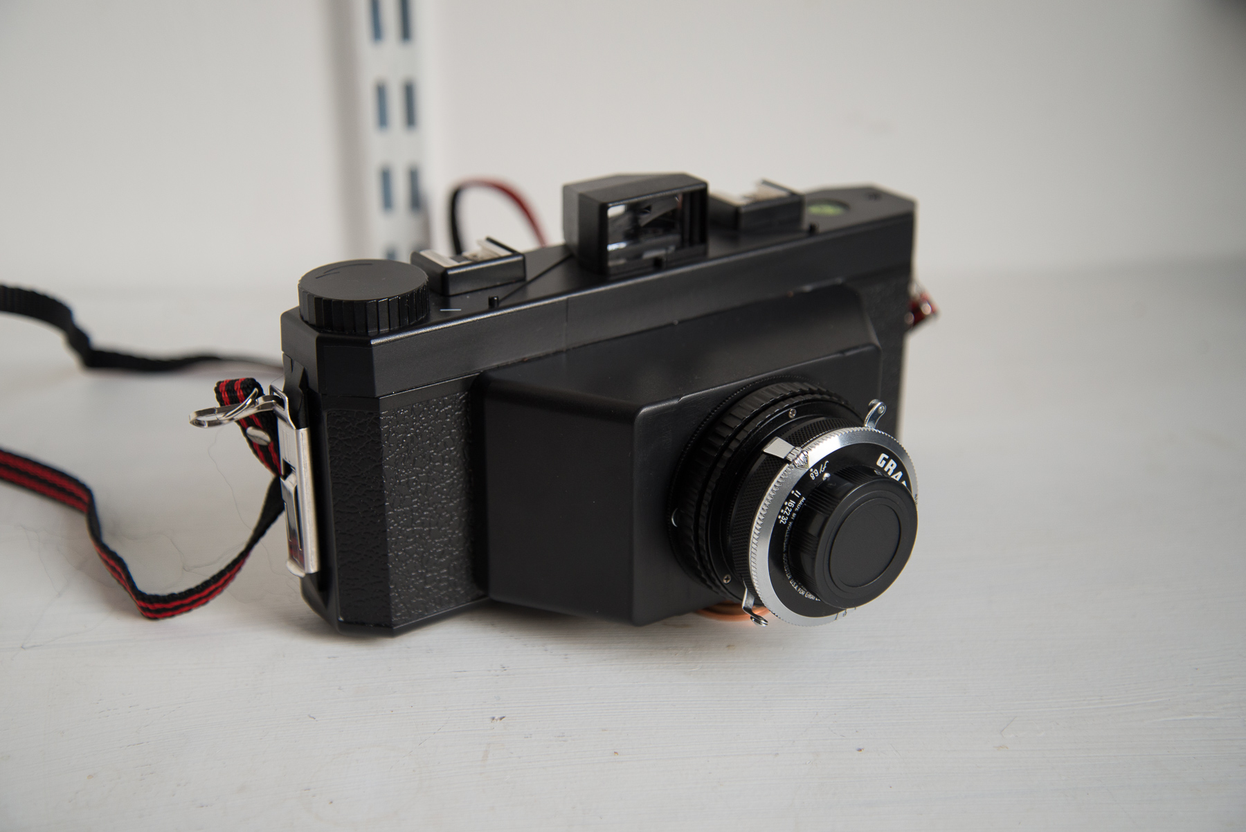

Hi all,
So I had a go at putting a large format lens on the Holga 120 Pan body. I was following the 'Making a HolgAgon' pdf guide that I downloaded ages ago, I've lost the original source but there's a copy on my blog post about the mod.
It was all pretty smooth sailing apart from focusing. I used a Graflex Optar instead of the Schneider Kreuznach 90mm mentioned in the pdf. I don't know if the flange distance is different between the two lens but what I think is that with the 12-17mm focusing helicoid and the lens cap/adapter that the lens would sit 2-3mm too far forward so it focus's too close at 12mm.
I tried with a 7mm macro ring instead of the helicoid and the lens then sits too close the film plane, so I reckon I'll go with the helicoid but try and move the M42 mount back a couple of mm, I'm just afraid the front of the camera is going to get messed up.
There's a few more pictures of the build here, along with several photos taken with the macro ring and helicoid at different f-stops showing the forward and back focusing problem.

Finished camera for now, until I have to chop into the front to try and move the mount backwards.
Focusing Helicoid at 12mm, f22

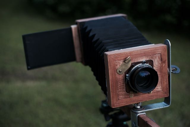

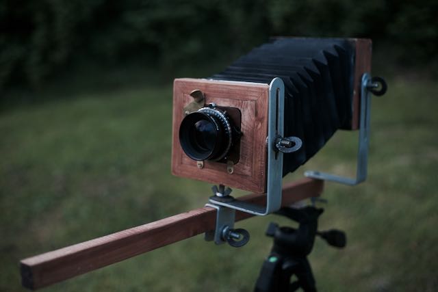

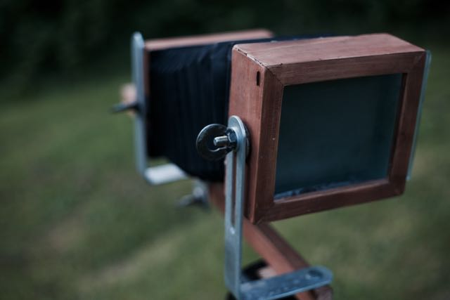

Just finished building and testing a 4X5 sliding box camera with front and back tilts.It utilizes the lens board and lens from my Crown Graphic and is somewhat smaller and lighter than the Graphic(one of the reasons it was built,LOL!) Here are some pics:
Sorry second image was supposed to be the other side,not 2 pics of the same side.Having some issues with photobucket.

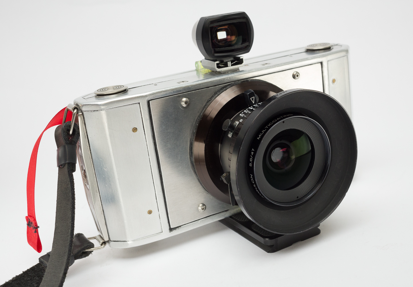

Hi all, my first post- It's cool to see this thread, got me excited.
Here is a little custom 645 I've been working on using some old parts from a Mamiya I once owned.
I do CAD/CAM at a CNC shop and have after hours access to a HAAS mill. The first roll I shot is in processing right now, I'll update some photographs once I get the scans.
Also- I've made a few camera grips and this little bellows lens for my Sony A7.
Thanks!
As promised here are some first shots... A couple modifications need to be made. Even with felt in places the interior still has some reflection going on. I missed every focus, so Im making a ground glass back for it to swap on and off to check focus.
I also started designing a new body.
As someone who works in a tool and die shop, this is so cool to see! Makes me wanna design a RF 35mm with exchangeable film backs...not that this hasn't been done before, just that it was never made the way I envision it...
What did you use for the parts? seems aluminum? Did you machine all that from solid stock? Around these parts all that aluminum stock and machining hours would cost me more than I paid for most of the gear I own... Wish the Boss would let me fiddle with the equipment after work, especially the wire EDM, it can make some really neat stuff...
For those reflections: Do you have access to a bead/sand blaster? that could help, just blast away in all the internal areas that are not critical (mating surfaces etc). Maybe spray it matte black too. I would design avoiding the need to add light seals, making the body itself light tight upon assembly.
Good luck, this is great stuff!
PS how good is that CAM? Around here the preferred tool is machining strategist. Can't do real 5 axis but that has not been a prob so far.
Yes, Aluminum 6061 Bar Stock.
It is designed to be light tight, but I believe when the lens opens the reflective interior causing some ray scattering. Next steps are to both beed blast and matte black paint the interior features.
Im a stake holder in the shop- we machine so much aluminum it's dirt cheap. We also allow all employees to learn CAD/CAM/Machining as we believe they should have access to these tools if they so wish. Company philosophy.

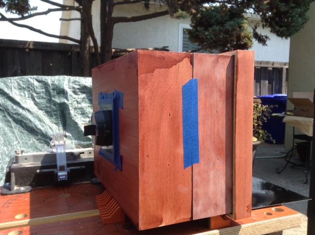

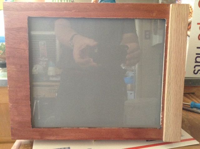

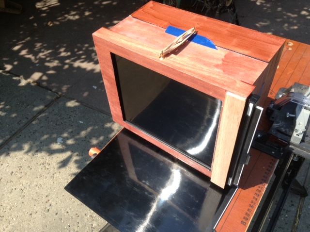

I finally had some time to build my 8x10 box pinhole camera. No CNC aluminium for this one - it started life as a couple of wooden paper file boxes. These are from the first light tightness test - unfiltered RC paper, 5 minutes with a 0.3mm pinhole at about 175mm 'focal' length.
As the ground glass hints, this camera will also have an alta ego involving a short bellows, some rear tilt and swing, and a 270mm G-Claron...

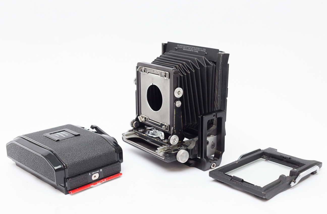

a couple recent builds, some have write-ups on my blog.
my Flickr has more pictures and more cameras:
https://www.flickr.com/photos/dirkfletcher/albums
View attachment 162208 View attachment 162209 View attachment 162211

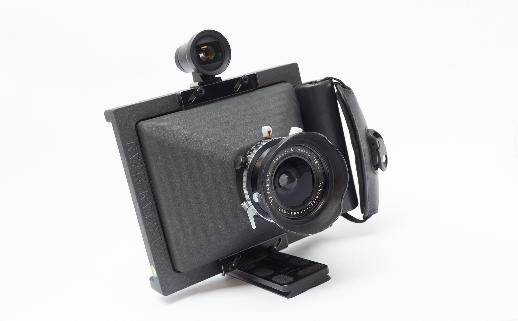

Hey Ian and Dan,
Thanks for checking out my camera. We were using it set up with either the 35mm Rodenstock and a roll film back or the 28mm Schneider with a PhaseOne back and wanted something that was small and could be quickly pulled out, shot and and stuffed back in a camera bag as we were using it addition to digital and 4x5 cameras. Being able to quickly focus 'inside the box' when shooting handheld is tricky and time consuming. Cutting it down made it crazy quick to shoot with and in all honesty, a heck of a lot cheaper then an Alpa which we just couldn't afford.

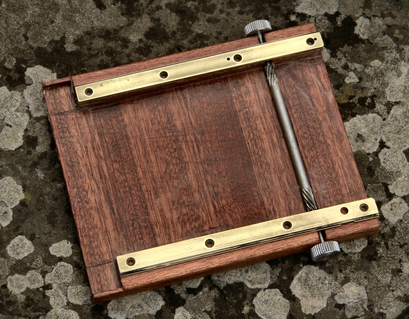

First though, if I can make it in time it'll be a 6x7/6x9 camera similar to Dirks, I could do with it to take to Canada in two weeks. The base is made, next the back which will rotate, if I run out of time I'll take one of my Mamiya 645s. I've just restored a Pacemaker Speed Graphic (for another APUG member) and fitted new bellows, I can use the old ones on a temporary basis until I make new.
Here's the base for the track etc, I decided the guides would look be better plain brass.
It's covered in wood sealer at the moment, then when the rest of the body is made it'll be french polished probably after I return to the UK mid September. Next I'll make the back.
Because I rarely use rise but use front tilt a lot I'll offset the back slightly higher to compensate.

Dirk, you've really inspired me, or more honestly given me motivation.
My new build 6x7 camera is now well over 50% made More like 75%), now, the back takes RH10 roll film holders and is rotatable, something lacking on Graflex cameras until the Super Graphic. I've built the back so the Pacemaker standard gives rise ansd fall which means it'll work well with front tilt the main movement I use a lot.
