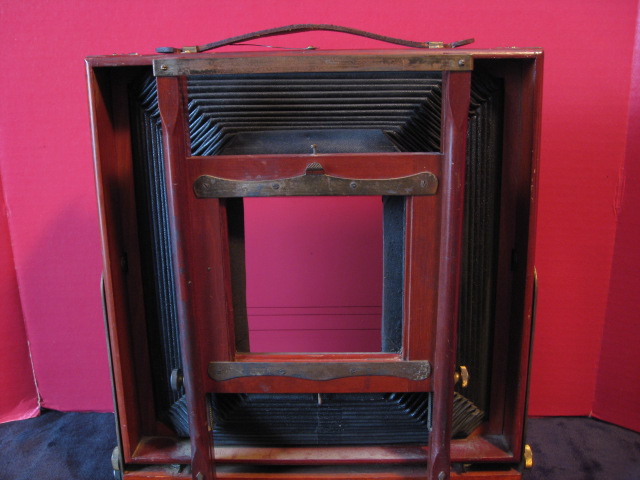

The metal pieces that hold the lens board onto my Speed Graphic have gone walkabout.
Is this the bit you need?
If so, if you send me your adress I will post it to you.
Steve.

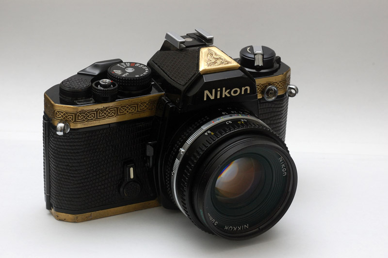

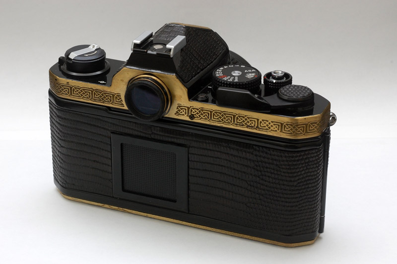

I decided to mod my beat up and brassed Nikon FM. Make it a Nikon FM Celtic Limited Edition.
Sorry if it hurts your eyes :tongue:

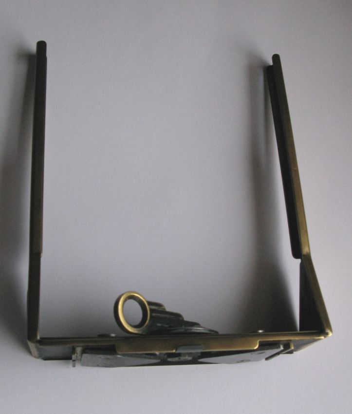

I think she means the two sliders top & botton
I think you're right. I have those too. They will also be cheaper to post! (only the top one slides, the bottom one is fixed).
Steve.
Wow that's really beautiful!!
~Stone
The Noteworthy Ones - Mamiya: 7 II, RZ67 Pro II / Canon: 1V, AE-1 / Kodak: No 1 Pocket Autographic, No 1A Pocket Autographic
Thanks!
It doesn't hurt mine. What method did you use?
Steve
I removed part of the coating and used Ferric Chloride etch, Edinburgh Etch to be exact.
