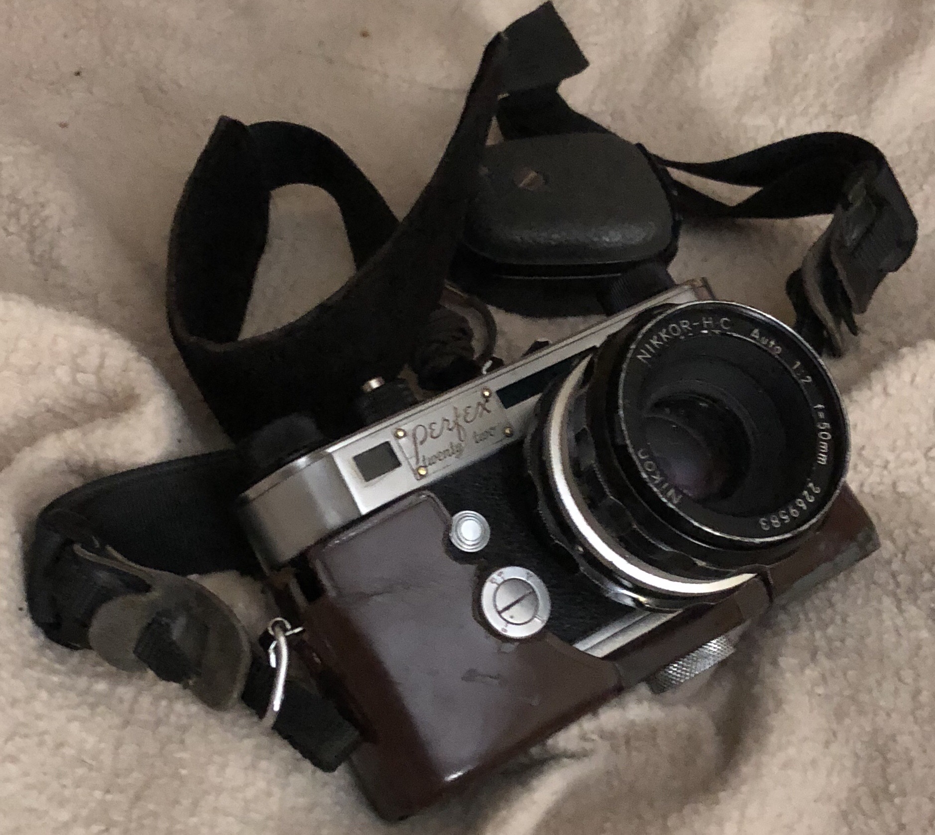

View attachment 327312Well, it’s a Perfex 22 with a Nikon F2 50mm ! Crazy Glued! To the focus flange. The Sucker takes Awesome photos, as you’d expect from the f2.

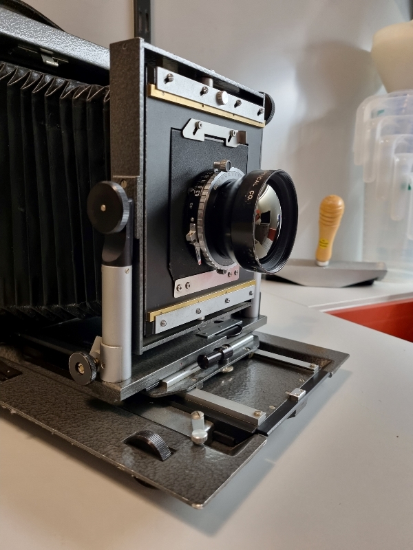

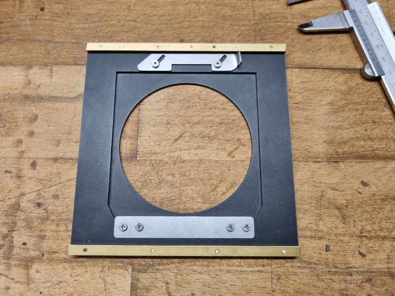

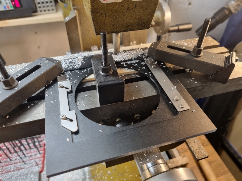

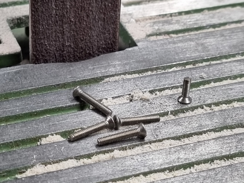

A lensboard adapter for my Mentor 13x18 to fit the Linhof boards.Starting point was a chinese adapter from Sinar to Linhof which I milled to size first.
After that I had to mount two brass bars to match the thickness of the original Mentor Boards. Shortening M2 screws was fun... .

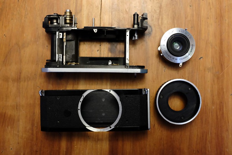

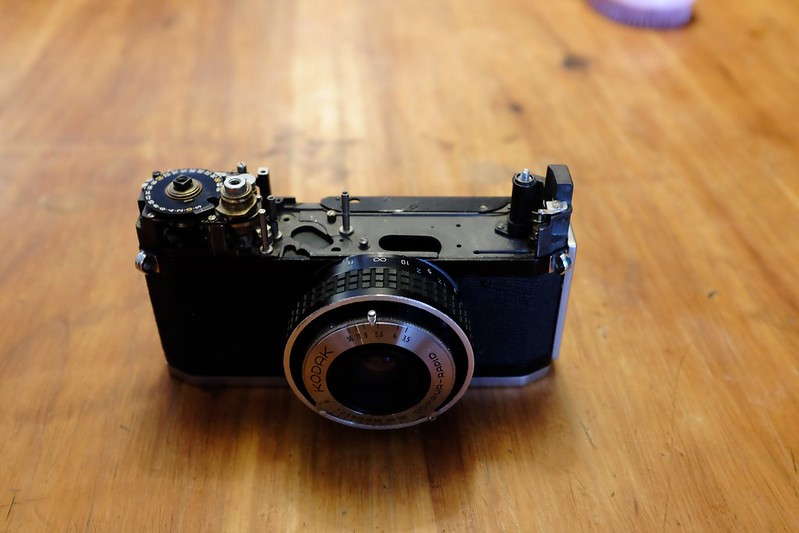

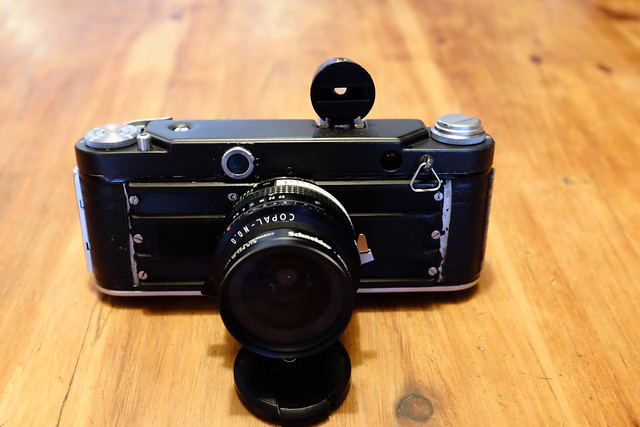

Here is a WIP. Canon 7 with 63mm wide frame, new pressure plate and "corrected" film advance. Front plate machined for a slow-pitched helicoid (Hoya 28mm) with a Fuji 45mm f5.6 (from the GS645W) mounted on a #00 shutter from a Kodak Retina 013. Next I'll try to couple the rangefinder.
Canon 7 panoramic mod by Olivier, on Flickr
Very cool Oliver. I have a parts Canon 7 body if you need any parts.
Thanks @Patrick Robert James ! I've recycled RF units from another Canon 7 and a Zorki 6 so I might take you up on it.
Previous iteration of this build used a Bronica 50mm 2.8 which has a much longer back focus. I stole the RF unit from it.

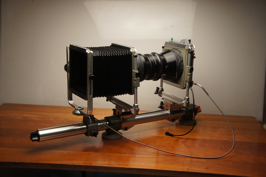

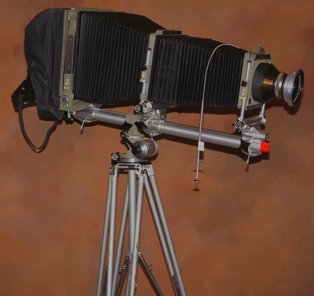

Sinar Norma Handy ready to go. On the back is the rare Sinar Norma Monocular Rubber Bellows, with the Norma Monocular Viewer. With a short locking cable release, I can view through the lens if I need to. I can also insert Sinar Norma 4x5 Meter Cassette, with Sinarsix, deadly accurate TTL metering eliminates a lot of exposure variables, some of which can compound. So uber versatile. The strap is a 1.5" Domke Black Gripper, the strap lugs are Pentax 6x7, I drilled and taped the Norma Auxiliary Frame. Devil Cal on RFF kindly supplied the stainless steel bolts holding the strap lugs. I bought the Graflex XL Grip (Norma used this) from Glenn Evans, I'm not using the Grip for now. I can nicely handhold this all day long

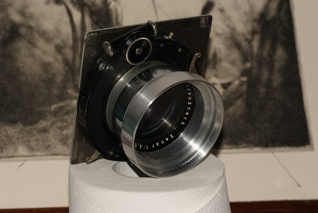

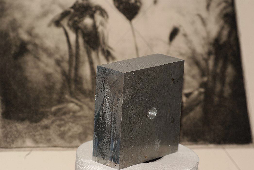

Michelangelo said that he has seen his sculptures within blocks of stones - he just had to remove needless stone.

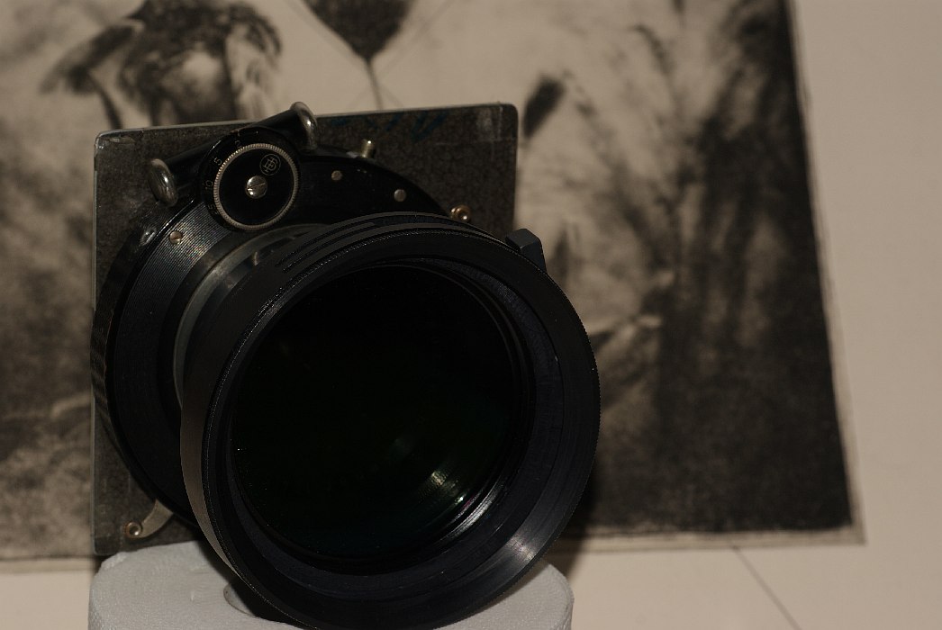

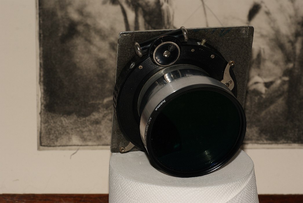

I do believe him and found myself a multiple filterholder within a block of aluminium.
The Xenar now easily takes glassfilters, plus my Linhof filter holder.
Luckily the filterholder-holder fits to my Imagon, too.

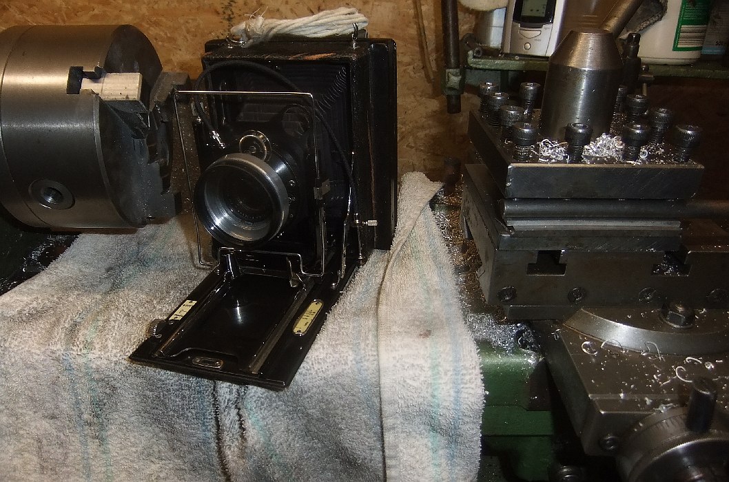

Filterholder for the good old 9x12cm Plattenkamera, locked with a screw instead sticking of the threadless 135mm lenses:

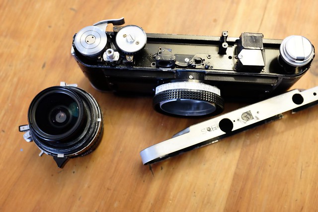

Here is the new cam follower with it's own bearing roller and eccentric. Everything seems to check out and hopefully it'll pass the film test. I detected a light leak from the leaf shutter but the test condition was far from normal practice. Shutter speeds are 1 to 1/2 stop slow.
Canon 7 Panoramic mod by Olivier, on Flickr
Wait... you are basically building your own X-Pan?? Very cool! I'd be curious to see how you link the lens shutter to the shutter release if that is part of this. Or will you use a knob on the lens itself.
Also any hints on modifiying the lens body cam follower to work with the rangefinder... Or did you go for modifying the body cam?
@Dan Daniel the shutter is controlled via the knobs. A previous version (with Bronica 50mm f2.8) used a self-cocking shutter which was nice but required a loop of cable release.
The cam follower on the body was replaced as you can see in the pic above. It's a bit shorter than the original. I screwed a protrusion (a flat cam) on the "lens board" which translates linearly via the helicoid and contacts the roller on the cam follower.
The RF expects a 52mm lens which translates 3mm from infinity to 1m. The key is finding out how much the new lens moves for the same distance range. Then the cam on the lens or the length of the follower must compensate for the difference. The movement of a lens f from inf to D is approx f2/(D-2f). Often the marked focal length is not exact but close enough.
This is my 6th or so pano build (check my flickr). I used mostly retrofocus lenses before and this is so much cleaner.

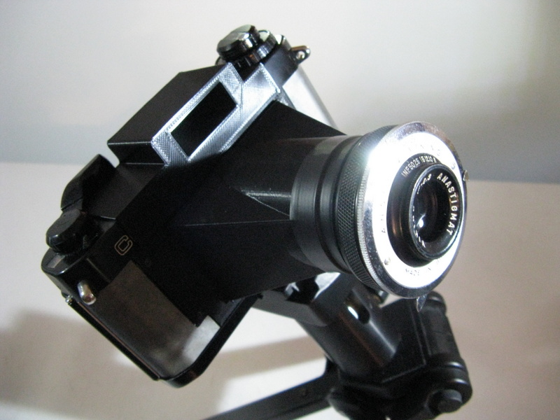

Reminds me of my DIY X-Pan

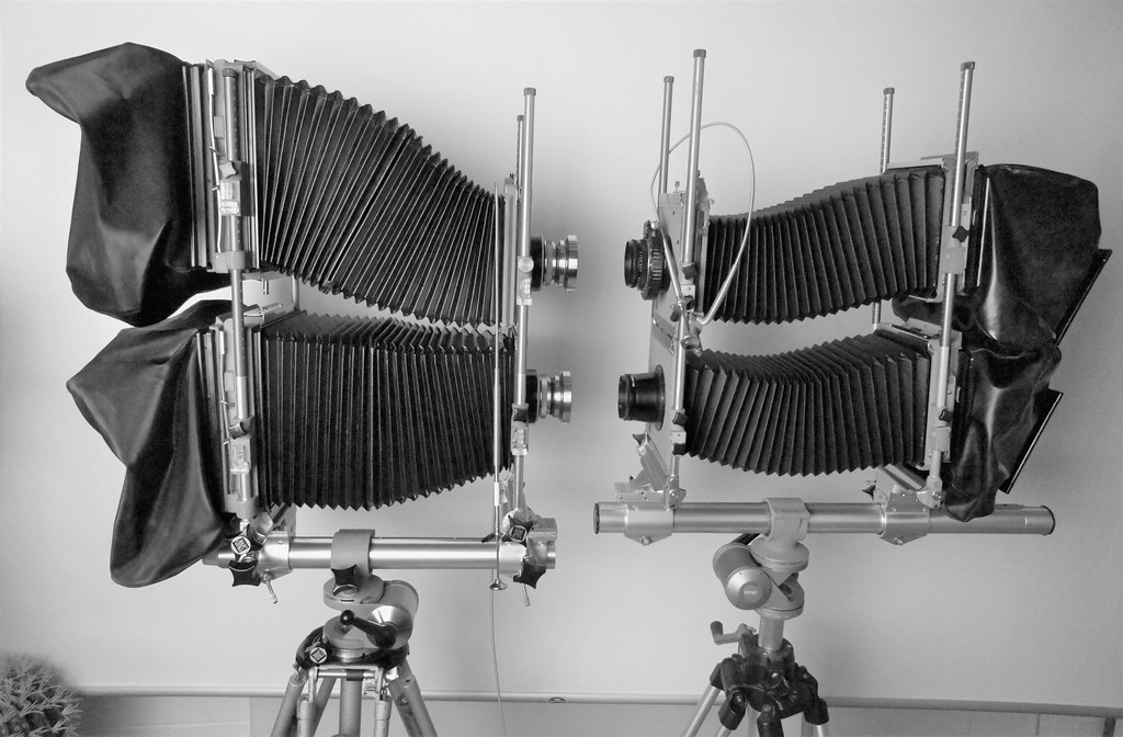

5x7 and 4x5 Sinar Norma TLR's by Nokton48, on Flickr

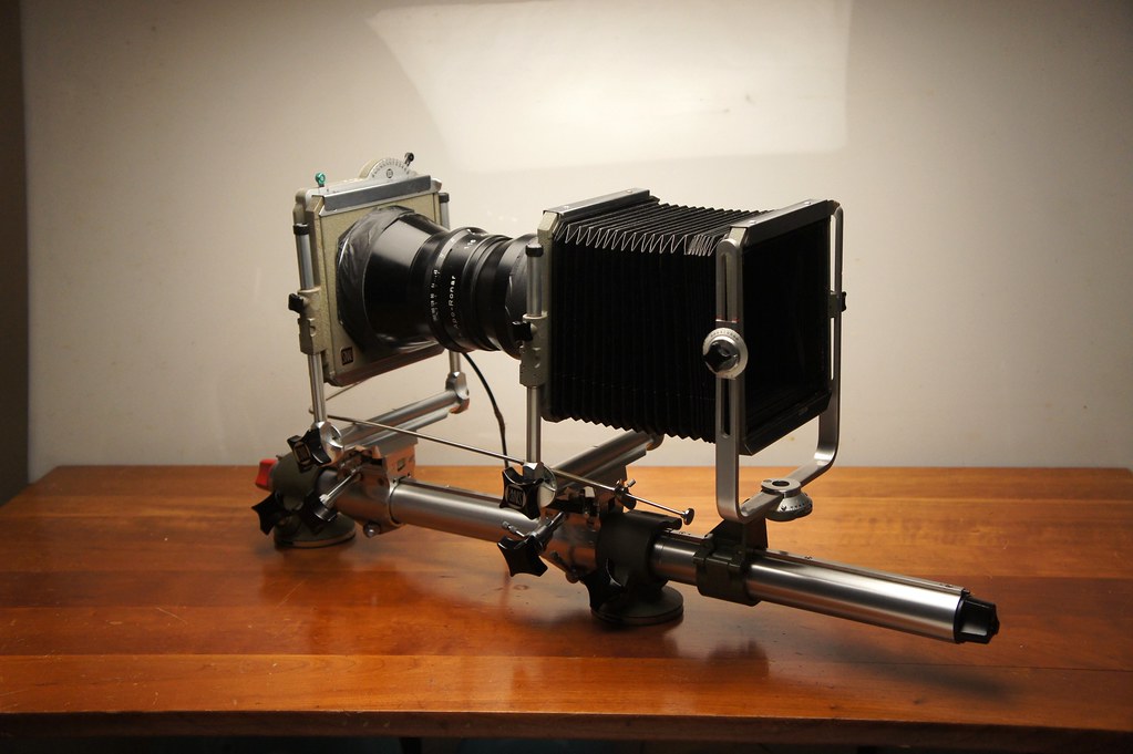

"Construction Unit Design" allows me to upsize the camera to 13x18/5x7. Nice to have the larger format, I am just getting going with 5x7. 240 Componons on the left, 250 Imagon pair on the right.
For some reason I'm thinking Gowlandflex...
All it really needs is a reflex hood for the top one
