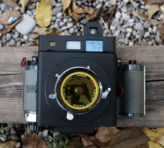

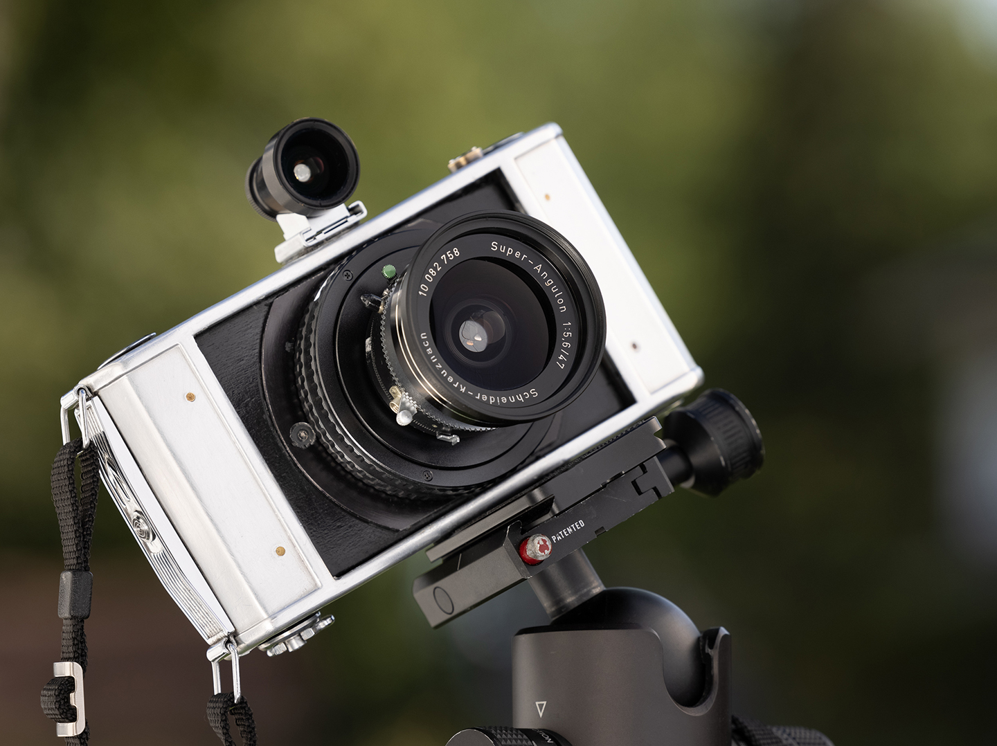

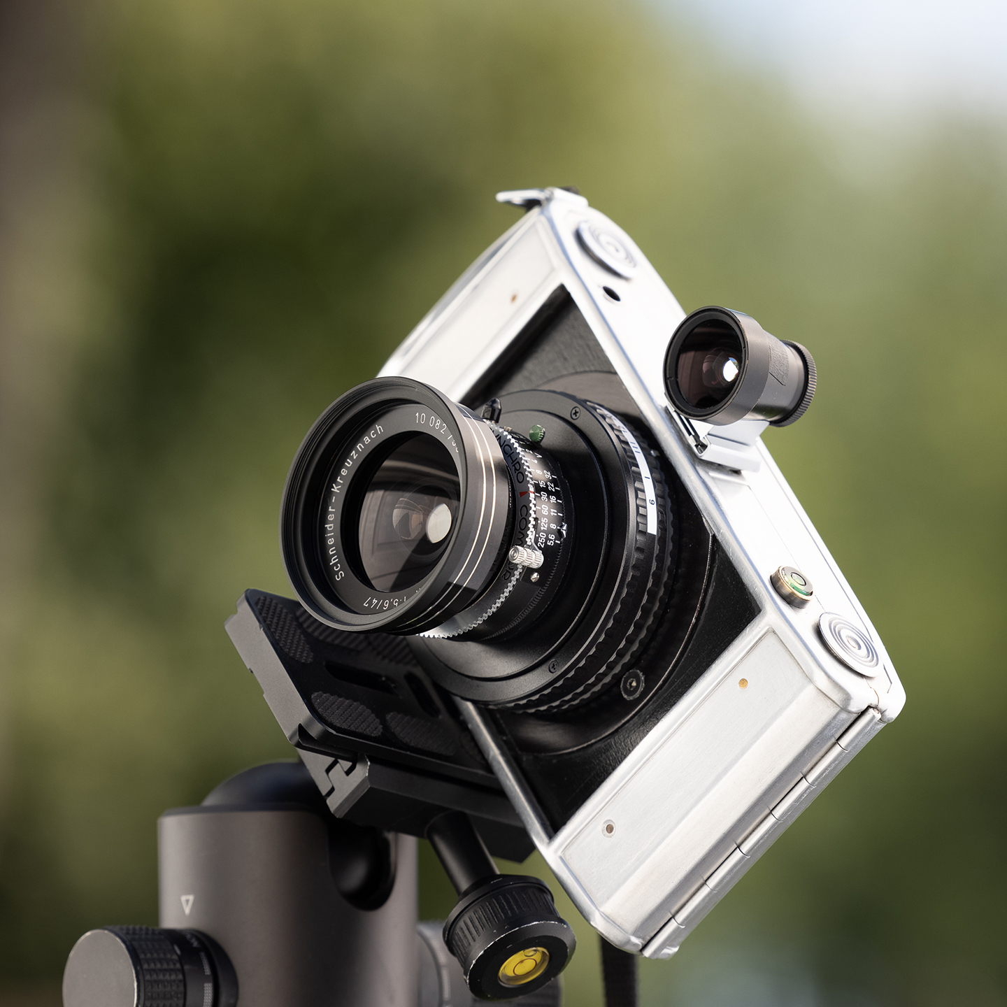

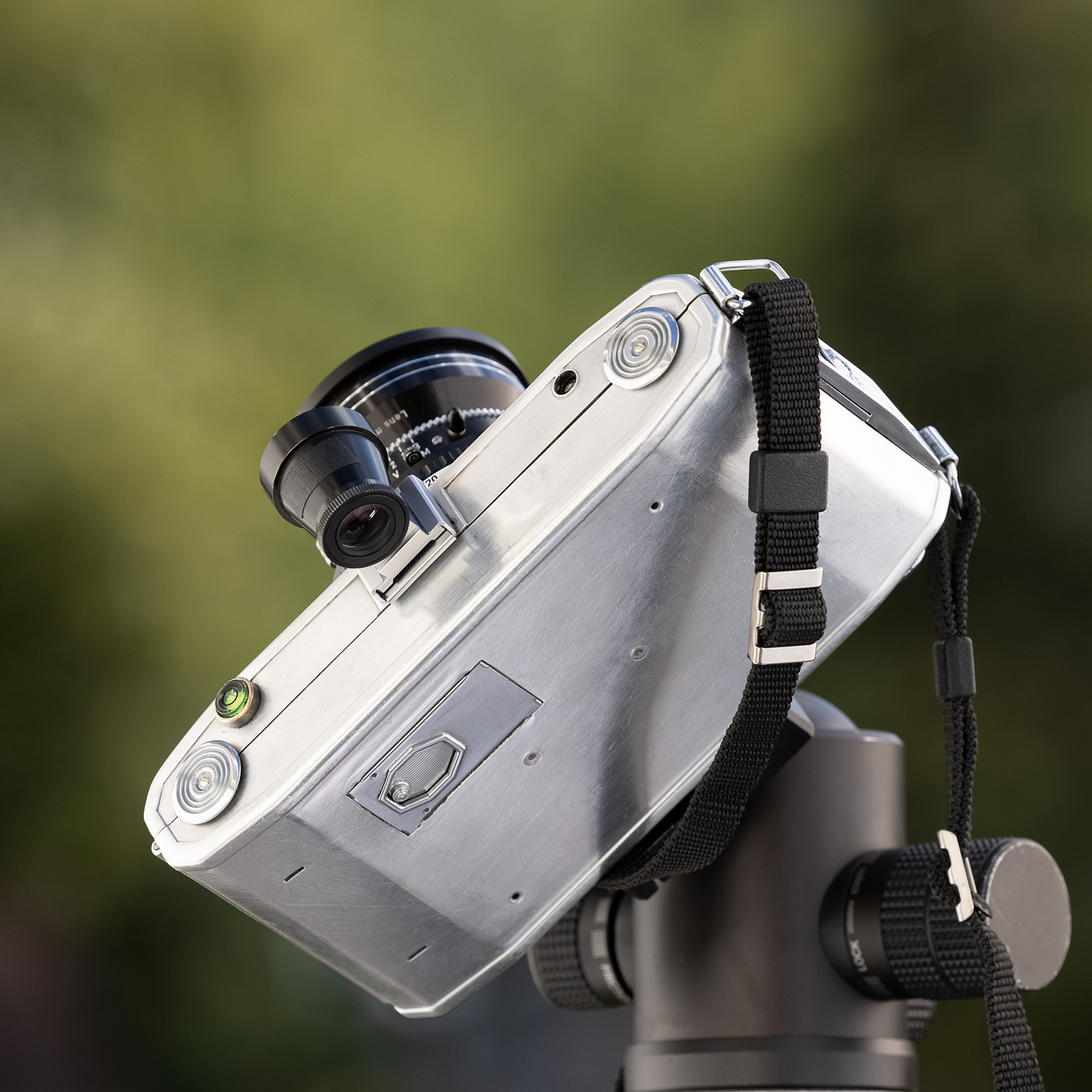

After making the last 6x9 Zeiss conversion with a 65mm lens for someone, I realized how cool these little Zeiss conversions are. I had long wanted a ‘smallish’ camera with a ‘largish’ neg which would be ideal as travel companion (if we ever get back to traveling again…).
At first I was thinking about using a 6x9 Graflok back, but by the time you added the roll film back, the camera becomes more like a cube or box due to the way the film plane is directly in front of both the feed and take up spools. Using a Zeiss camera body with the film plane at the back of the body and the spools to the sides (and kinda in front) really helps the finished product be a bit less boxy and a little more ‘camera’ shaped.
To keep the camera as small as possible and ideal for handheld shooting, I used a single coated 47mm f/5.6 Super Angulon, this lens is remarkably small, especially compared to the modern, multicoated 47mm f/5.6 (non-XL) Super Angulon. The older single coated version was only designed to cover 6x9 which I have to assume keeps it nice and tidy. The front filter thread is only 49mm and the rear element is small enough to fit inside a small focusing helical. This was key as the lens board had to be recessed inside the camera body a bit for the focus to be work, the larger helical that I usually use would not fit into the smaller 6x9 camera body. The camera will focus from infinity to well under 6 feet!
After stripping off the 85 year old paint and leather from the camera, a gorgeous stamped steel camera body emerged. It was just too pretty to cover up with fresh paint or new leather so I gave it a good cleaning and buffed it out as best I could. The black accessories and lens mount look great on the polished silver camera body, I could be more happy with how this camera project turned out.
I’m looking forward to shooting a bunch of 6x9 this fall and winter.
There are more pictures of the camera and some other test shots on Flickr if you want to check them out: https://www.flickr.com/photos/dirkfletcher/albums.
View attachment 284569 View attachment 284568 View attachment 284570 View attachment 284566 View attachment 284567
Hi Dirk,
Inspired by your great conversions I've sourced a Zeiss Nettar and a 47 SA and have begun building. Looking at the photos of your camera it looks like the lens is mounted in the center of the new lens board. The Nettar's film gate is offset down effectively giving you front rise on the lens if the lens is in fact centered on the front. If this is right is it intentional or just how the helical needs to fit? It would seem to me with such a wide lens some front rise is not a bad thing to avoid excessive foreground.
How did you mount the front lens panel to the camera body? I'm thinking of using epoxy to glue it in. If your are not wanting to give away all your secrets, I understand.

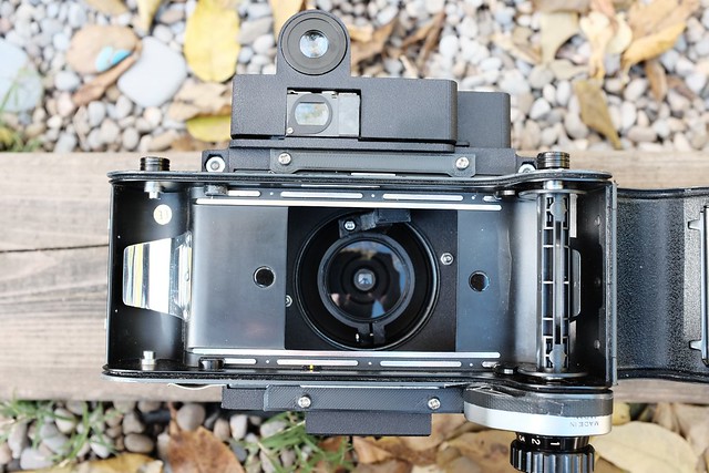

Nice work again. How did you couple the range finder to the lens gear on this one?
Thanks! On the 2nd pic you can see an attachment on the rear lens group. There is a little plate that contacts the cam follower. Had to extend the latter because it expects a shorter lens.
Do you have a picture of how you attached the cam to the helical gear?
No sorry. There is a ring clamped on the rear lens group, to which the "cam" (just a flat plate) is attached. It doesn't turn with the helical but translates linearly with the lens. I had to modify the rangefinder cam follower for the coupling to work.

Hi Dirk,
Cheers
Rick
RICK!! So sorry for the delay, I missed your question. You are totally correct, on both the 6x9 and 6x12 bodies I'm centering the helical (except for one 6x12 actually at the customer's request) which gives you a tad more than a 3mm rise. The very first 6x12 camera I made was for myself because I couldn't afford the original 6x12 Technorama with a 65mm lens and a built in 8mm rise, so I opted to go with the 3mm rise on just about all the subsequent 6x12 projects.
You need more than epoxy, I make four angle aluminum brackets (one of them needs to be sidestepped a bit) and anchor to the top and bottom of the camera and and the face of the panel. Once the panel fits well and is square to the film plane, I metal epoxy over (and under) the brackets and all around to seal it. While 3D printed cameras are fantastic and offer so many affordable options the conversions that I make are truly built to withstand daily professional use if exposed to it. Let me know if you have any more questions, looking forward to seeing your final camera!
