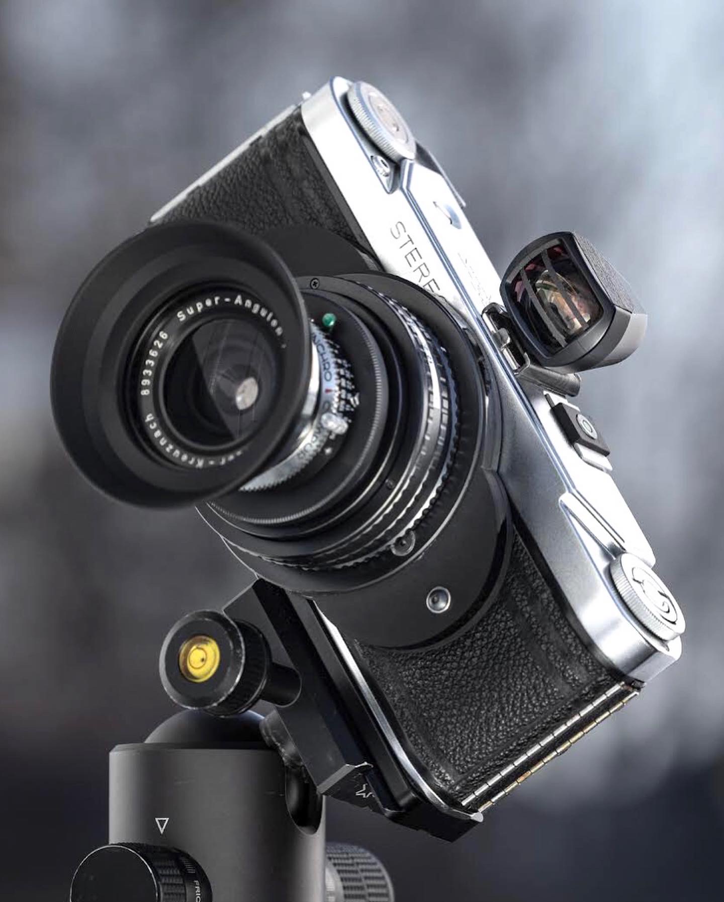

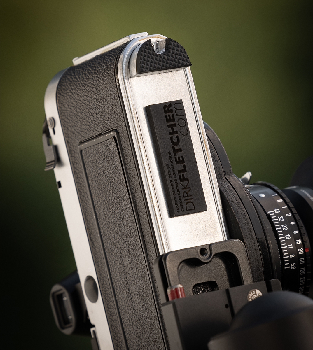

This is the first camera conversion that I’ve made using laser cut parts. Both wood and acrylic for the nose piece were used. It looks SO much better than my first couple attempts at the front plate. I’m super excited how the entire camera turned out.
14 shots per roll of 35mm with a film gate of 35mm x 85mm. A bit wider than the traditional 3:1 aspect of a 6x17 camera and a full 20mm WIDER than an XPan. With a considerably smaller price tag!

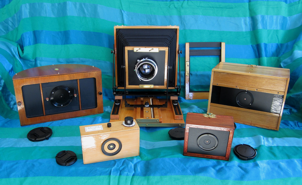

A quick pic of my current home-mades. L_R (back): 5x12 curved film plane pinhole; 5x7 folding field camera with extensive movements, and 4x5 reducing back; 5x7 sheet film pinhole. Front: 6x6 rollfilm pinhole; 2x3 sheet film pinhole.

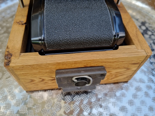

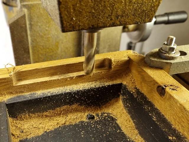

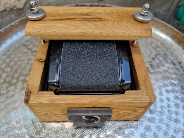

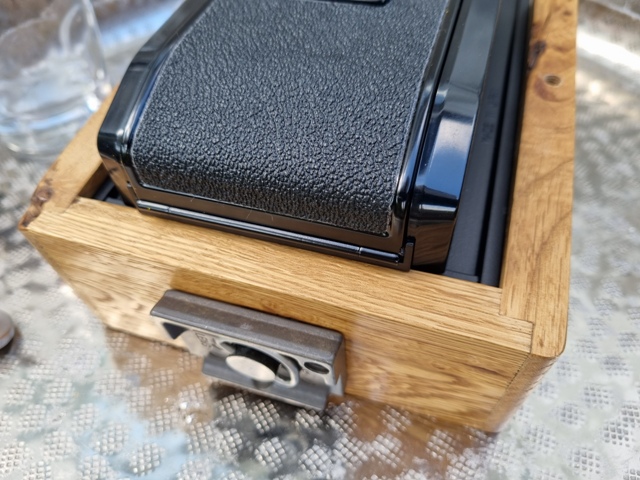

I want to use a Horsemen 612 rollfilm back in my RSS 4x5. The extra problem next to the short fixing screws - it does not fit at all:
So a bit of machining was needed:
Screws replaced by longer threaded rods, now the roll film holder fits:

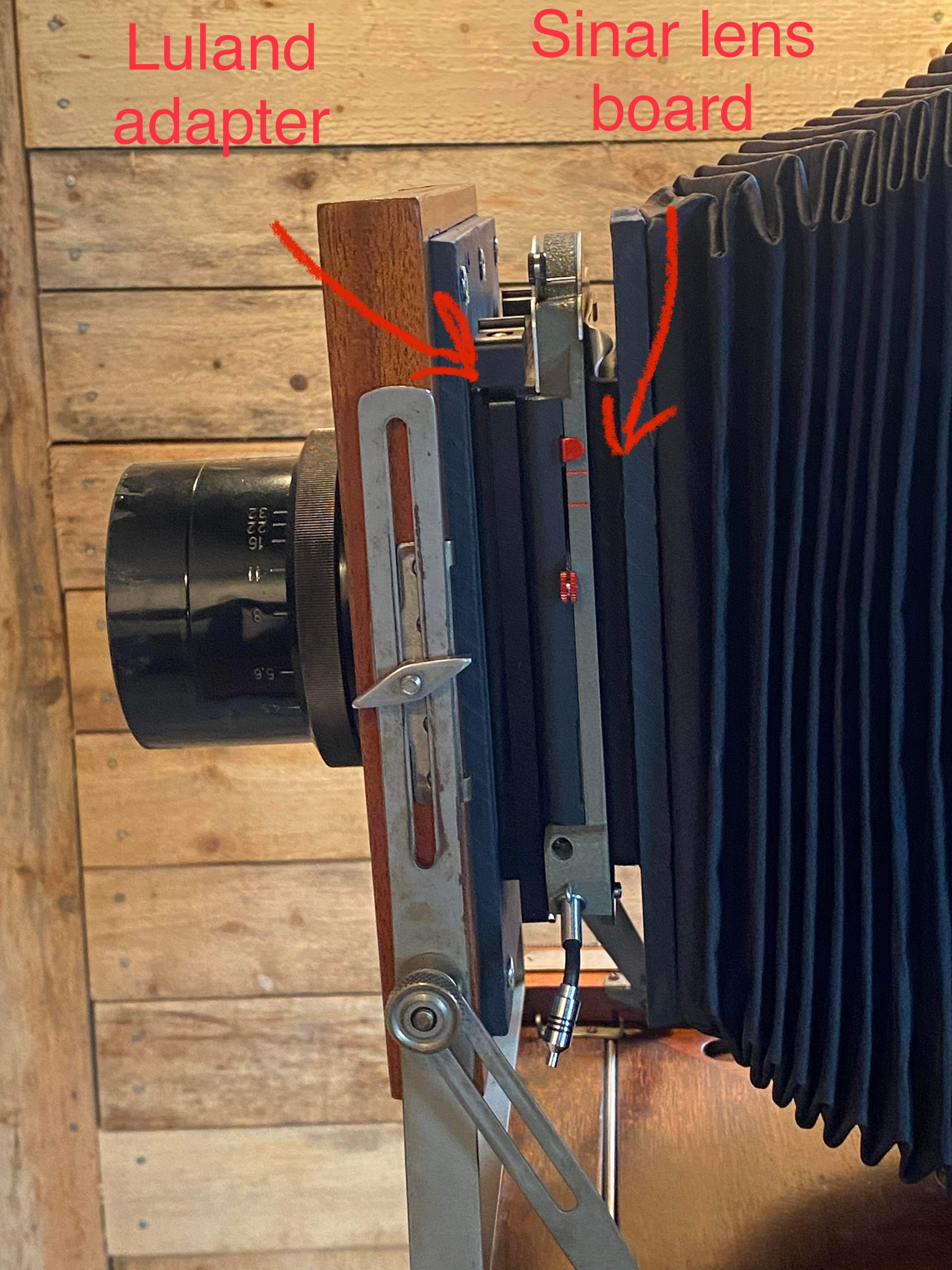

I've only seen this mentioned once or twice before, so in case it's useful to some people: here's how to adapt a Sinar Copal shutter to a view camera, behind the front standard. That makes it a lot easier to use old heavy barrel lenses in and outside the studio.
I've used a Luland Sinar shutter adapter (from eBay) to hold the front of the shutter to the front standard of the camera, and a Sinar lens board allows me to fix the bellows to the back of the shutter.
This is a prototype, not meant to be pretty. I managed to put that together using only the existing screw holes that held the bellows to the front standard, and everything can be reverse if needed.

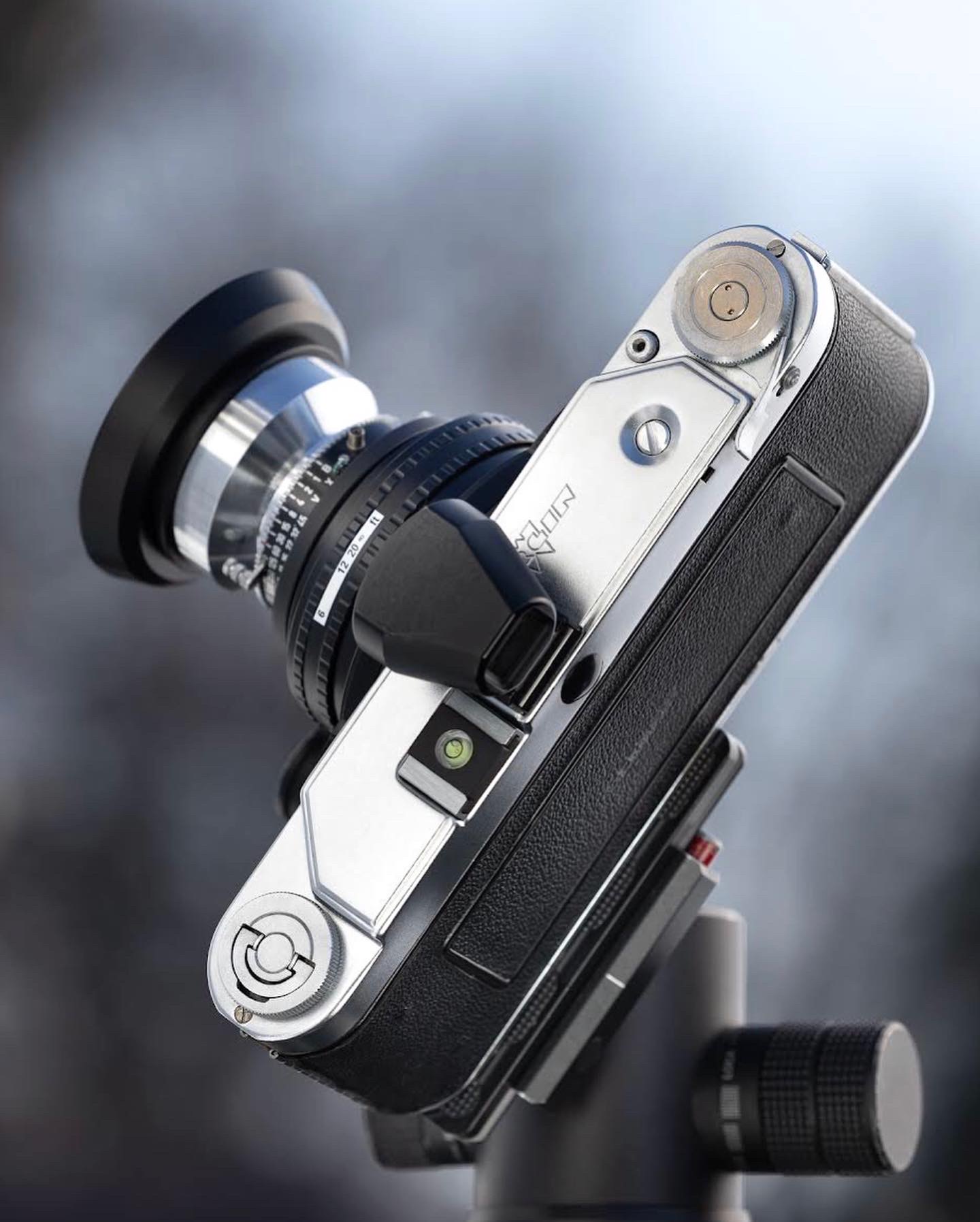

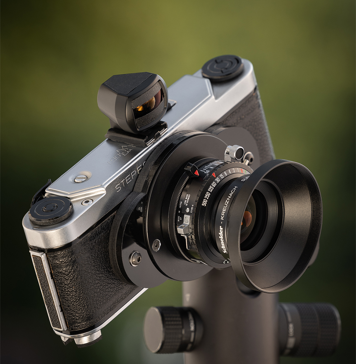

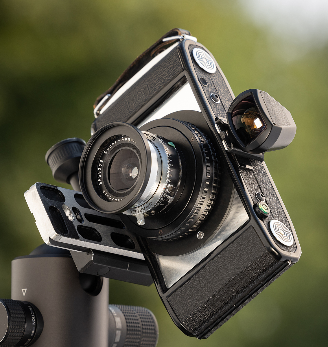

Couple conversions I've recently completed. The smaller one on the right is a 6x9 w/ a 47mm f/8 in a focus mount. Enjoyed playing with silver accents on this one including taking down the Arca plate to silver with black detail.
The Wirgin conversion has a fixed focus modern 47mm f/5.6 SA with an 18mm Voigtlander finder that is masked down to match the field of view of the camera. This is the third Wirgin conversion that I've built and the first one where I rolled the left side of the Arca plate to match the curve of the camera body. It wasn't sitting flat so I added a shim on the bottom so the camera doesn't sit at an angle when you set it down. Each time I build one, there are little improvements that I realize would be helpful.
