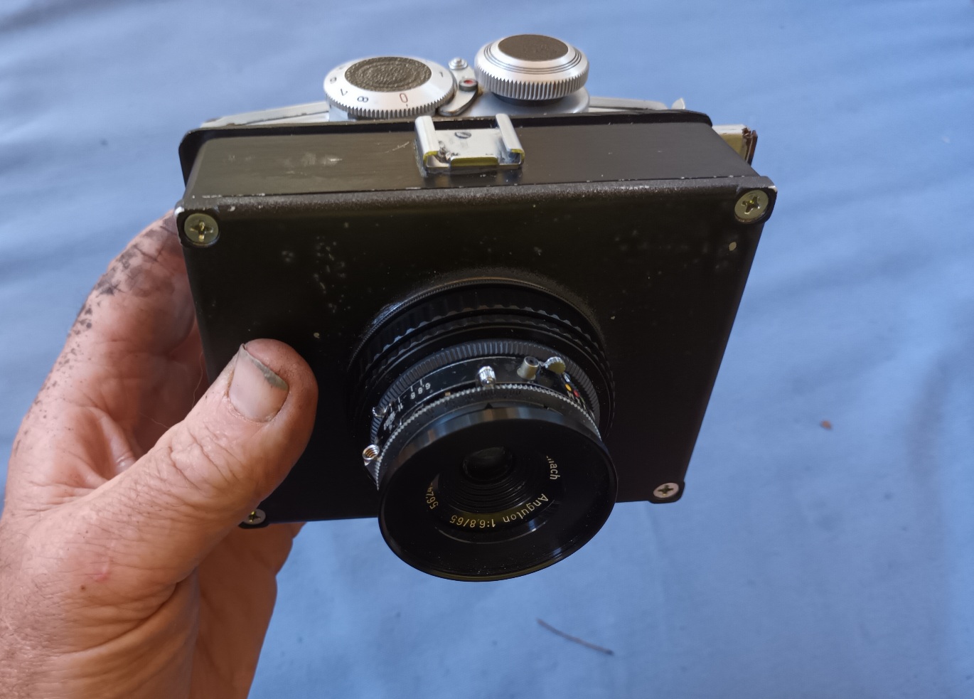

I'm going to make a compact 6x9 using a film back and a little 65mm Angulon. The helicoid I ordered is M42, but only has 5mm of focus, hopefully it will be enough. Don't need to focus anything more than a meter.
Actually Dirk I was wondering how much focus you get from infinity?
Hey Paul, That should do it, just spend some time and get it placed at the ideal distance so you can use the entire 5mm of movement. I’m using 17mm helicals but I don’t always hit infinity perfectly at the end of the focus mount. This camera in particular will focus past infinity and it will actually focus much closer than 6 feet but I only indexed it to 6 feet. I feel like I’ll shoot it mostly at infinity and 12 feet a majority of the time.
Dirk
Thanks Dirk.
It just arrived and looks like it will do the job.

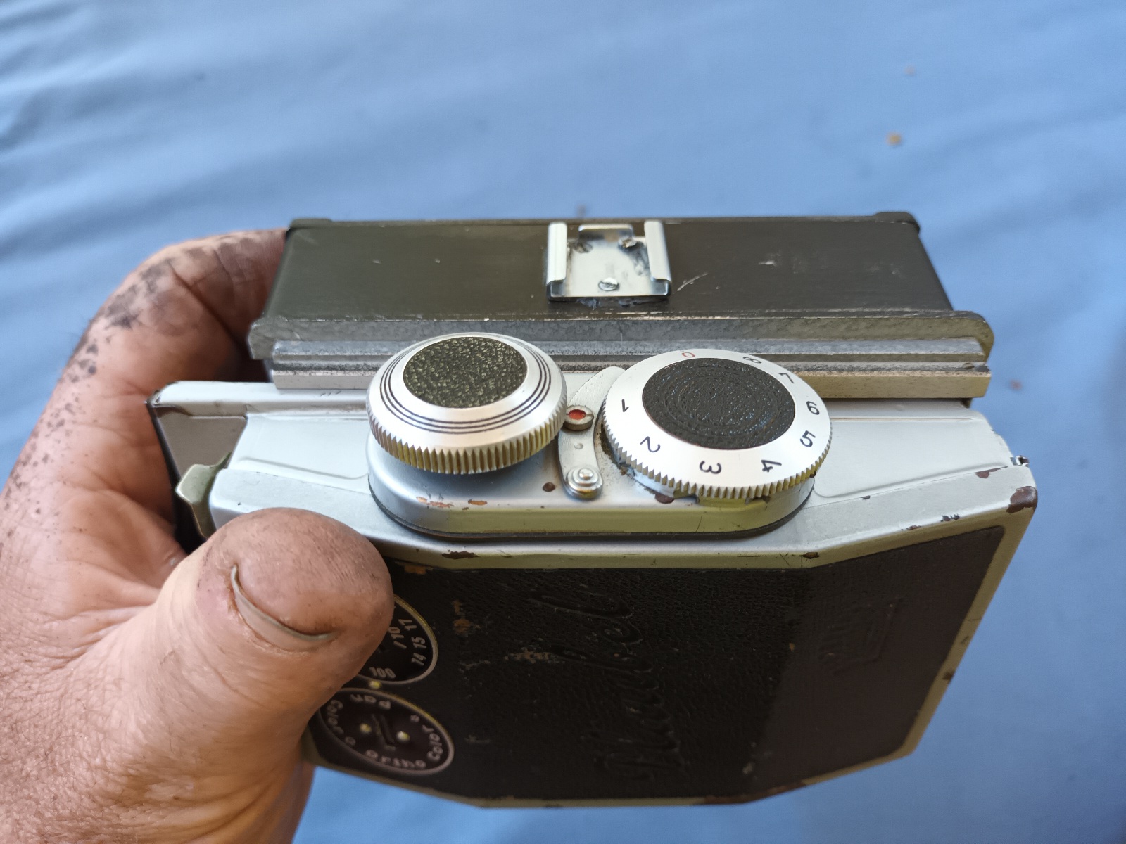

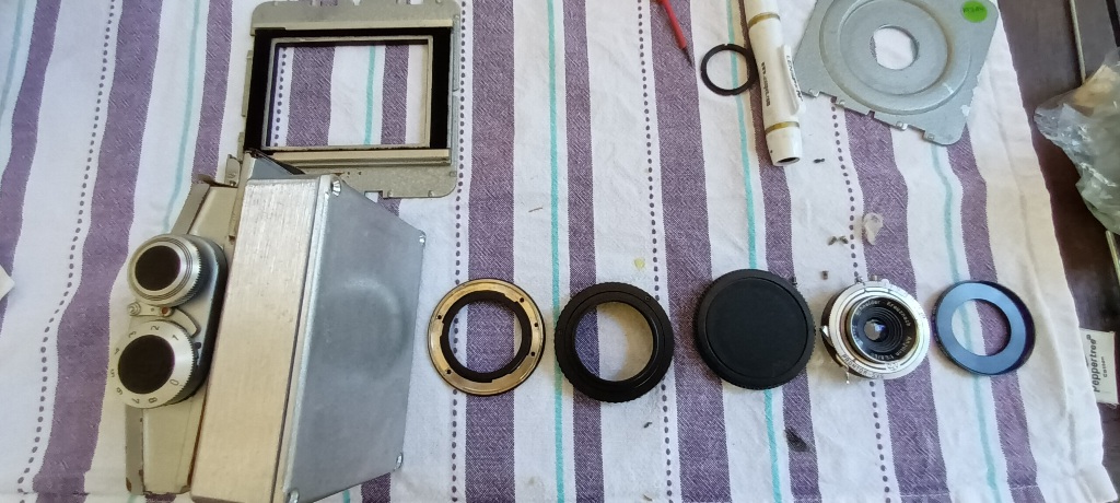

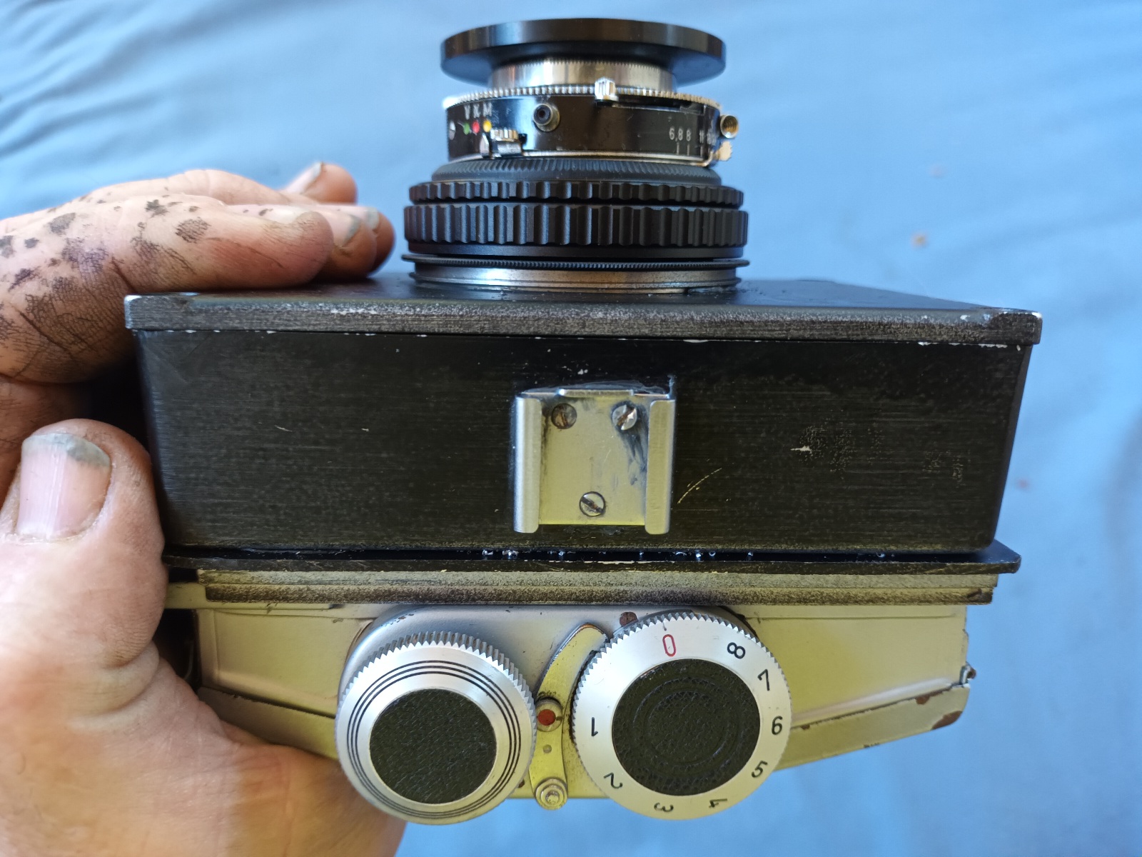

I have a Plaubel roll film holder and adaptor plate I will refit to a aluminium box. Then have several options to fitting the helical, then a M42 body cap I will fit the little 65mm lens to.
Figure I will shim to get to infinity, then I will have 5mm of focus. Good thing is it only has a quarter turn throw. I was worried it would need more than that.

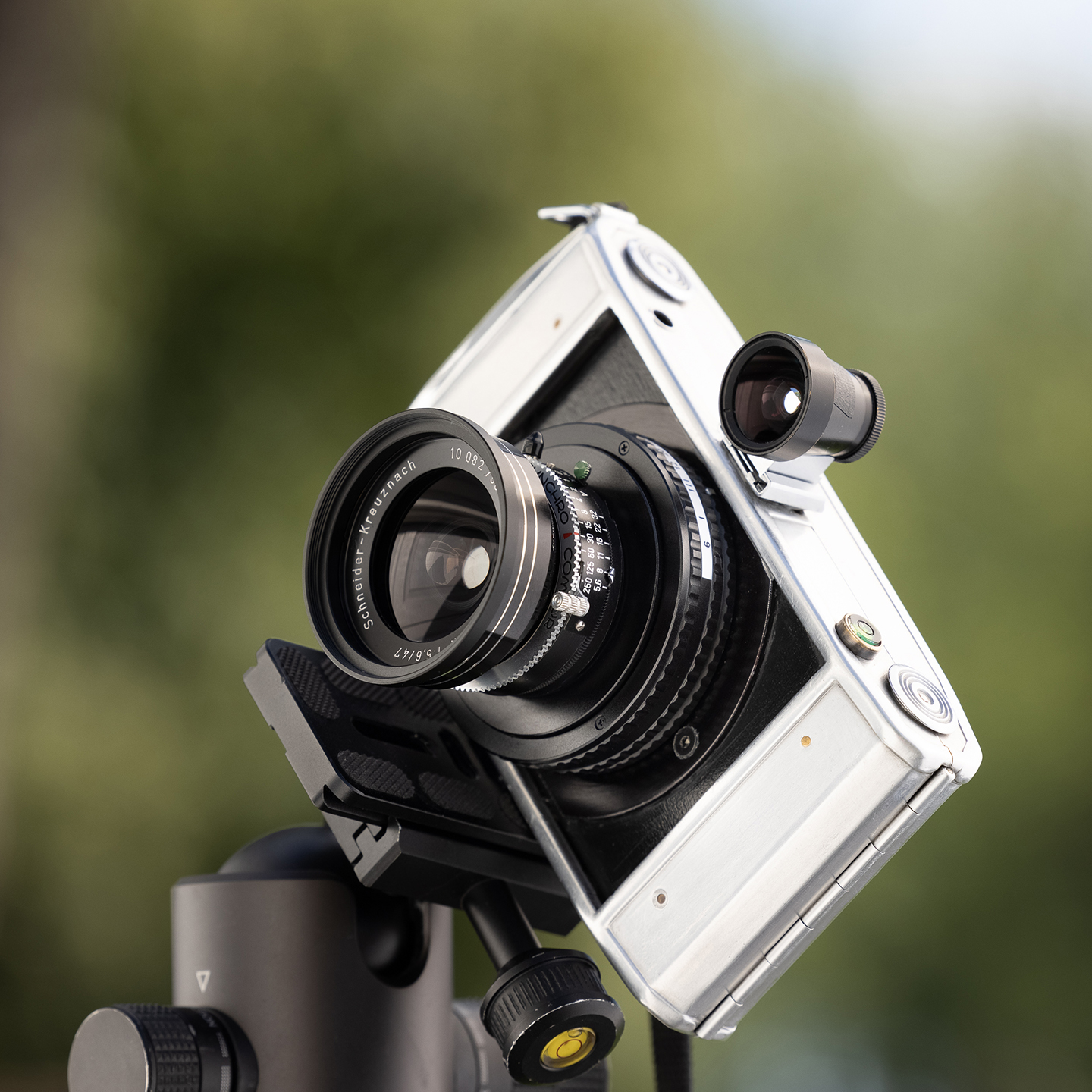

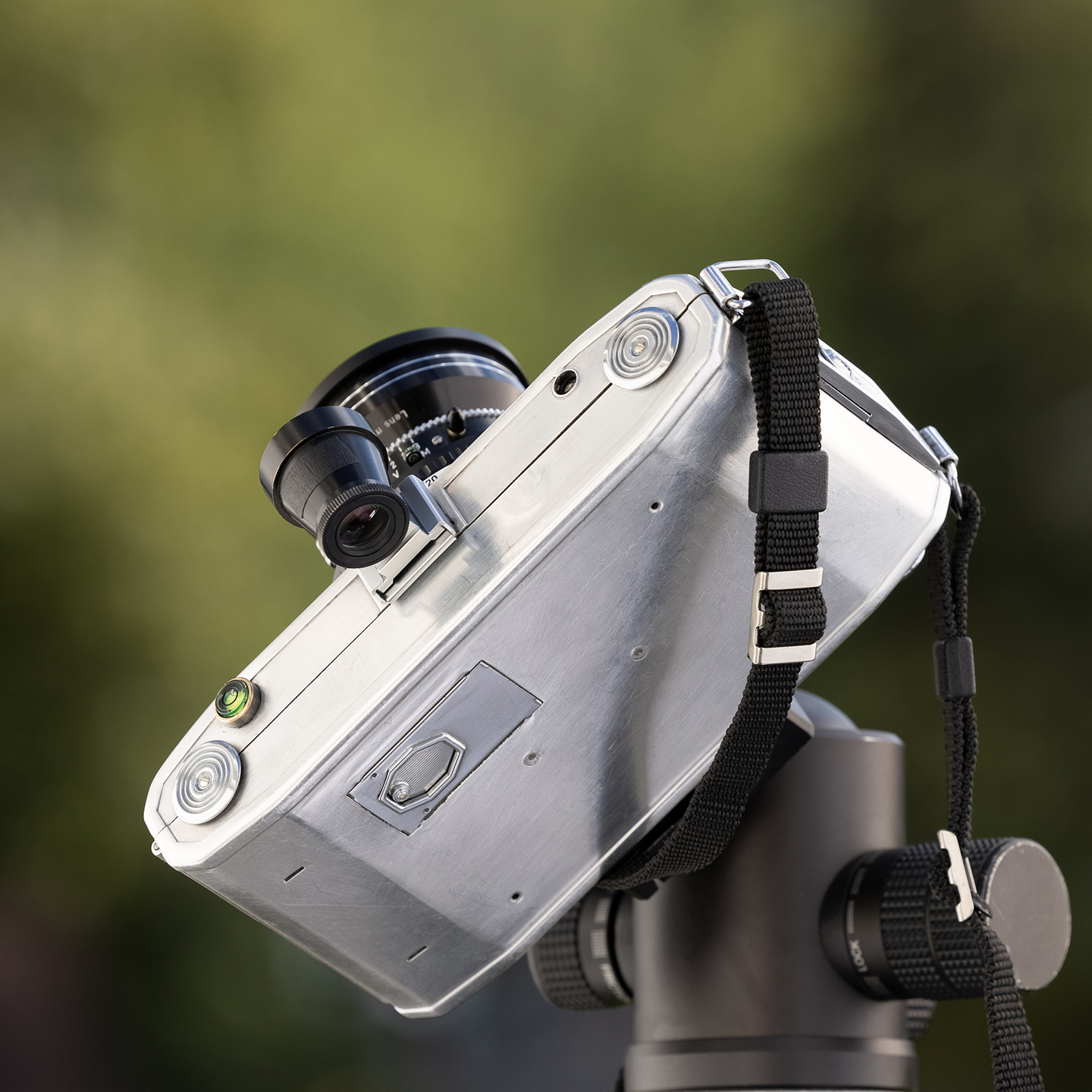

After making the last 6x9 Zeiss conversion with a 65mm lens for someone, I realized how cool these little Zeiss conversions are. I had long wanted a ‘smallish’ camera with a ‘largish’ neg which would be ideal as travel companion (if we ever get back to traveling again…).
At first I was thinking about using a 6x9 Graflok back, but by the time you added the roll film back, the camera becomes more like a cube or box due to the way the film plane is directly in front of both the feed and take up spools. Using a Zeiss camera body with the film plane at the back of the body and the spools to the sides (and kinda in front) really helps the finished product be a bit less boxy and a little more ‘camera’ shaped.
To keep the camera as small as possible and ideal for handheld shooting, I used a single coated 47mm f/5.6 Super Angulon, this lens is remarkably small, especially compared to the modern, multicoated 47mm f/5.6 (non-XL) Super Angulon. The older single coated version was only designed to cover 6x9 which I have to assume keeps it nice and tidy. The front filter thread is only 49mm and the rear element is small enough to fit inside a small focusing helical. This was key as the lens board had to be recessed inside the camera body a bit for the focus to be work, the larger helical that I usually use would not fit into the smaller 6x9 camera body. The camera will focus from infinity to well under 6 feet!
After stripping off the 85 year old paint and leather from the camera, a gorgeous stamped steel camera body emerged. It was just too pretty to cover up with fresh paint or new leather so I gave it a good cleaning and buffed it out as best I could. The black accessories and lens mount look great on the polished silver camera body, I could be more happy with how this camera project turned out.
I’m looking forward to shooting a bunch of 6x9 this fall and winter.
There are more pictures of the camera and some other test shots on Flickr if you want to check them out: https://www.flickr.com/photos/dirkfletcher/albums.
View attachment 284569 View attachment 284568 View attachment 284570 View attachment 284566 View attachment 284567
Great looking camera, love the silver and black. I have an old Kodak 616 folder I could convert, will be close to 612 aspect ratio......just need to save up for a 47mm lens.
The photos are awesome, even better with camera you made yourself.
Thanks for your kind words on the images. I’m really excited about this camera. Your method is exactly what I do, build it a tad short then shim the lens into the perfect spot. Good luck on the camera, share some pics of it when it’s done, I’d love to see how it turns out!
Dirk

How do you call this camera? The Angula ?
And I wonder where that box originates from. Art first glance it made me think of an electric-connector box, but then I realized it is from 3 not 2 parts.
The only thing I dislike are the cross-heads of the screws...
Hows "Plaubelang 69"?

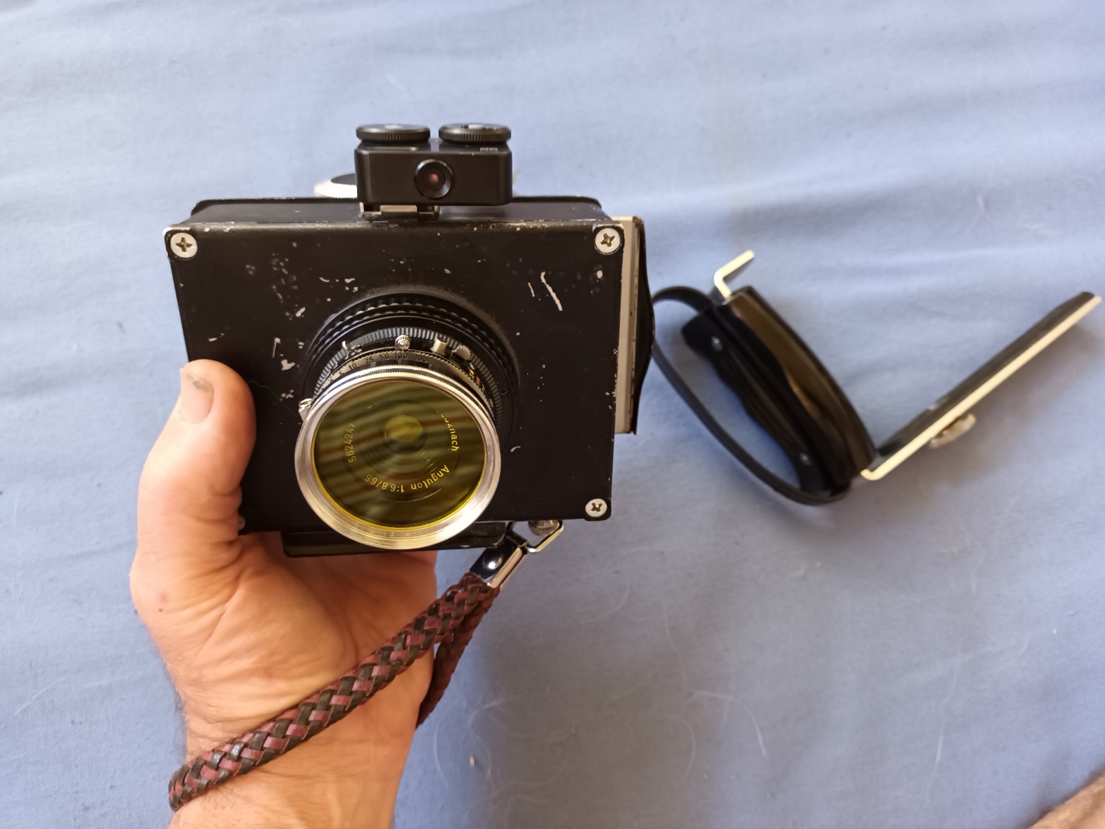

Yes went to the local electronic store and bought an appropriate sized box.
If all works OK I might pretty it up, but I kinda like ugly cameras. The good thing is it's small and compact and very easy to handle.....and cheap.
If you decide to pretty it up, all it needs is a couple of camera strap holders on one end and you've got a good copy of a Horseman 842 Convertible there. If you equate simplistic or functional with pretty, then that camera was gorgeous. Otherwise, not the sexiest camera ever produced. Definitely a "beauty is in the eye of the beholder" type of design. I like big negatives from small cameras so yours qualifies. I like it!
It's what's on the inside that counts...hopefully that doesn't include light leaks.
I added a wrist strap and a tripod plate. Have a hand grip I could use and will need to make a adaptor plate to fit a view finder, but for now will keep it minimalist. The lens functions are all easy to see and accessible, can operate apperture, shutter cooking and firing just with my pointy finger.
