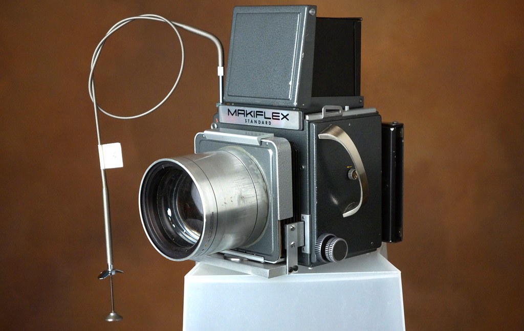

Makiflex Standard BandL Super Cinephor Linhof Graflex Back by Nokton48, on Flickr
This is my second Makiflex Standard, bought from a shoppe in Vienna. It has been heavily, professionally modified. Note the custom Side Handle. The Front Standard is HEAVILY MODIFIED, note the precison machine werk. Quite a bit of the camera has been removed! Right under the lens is a LENS SWING MECHANISM, which has a ball detent (NICE) and swings the front standard on the optical axis of the lens. Quite a bit of Swing is possible, seems very sturdy and built to last. The cool thing about the Standard Makiflex, is that the inside throat is more spacious, and has no cables getting ini the way of BEEG lens. This boat anchor of a lens, is a Bausch&Lomb Super Cinephor, 159.1mm F2.0, which is outrageously fast. It looks great I think on this camera, and it will get some use this Spring, I can tell you. It's going to be FUN. This is a olde lens meant for 70mm and 35mm Cinema Projection, like in a commercial theatre. Cool that it fits the Standard, but won't fit my Automatic Makiflex, for the above reasons. So this lens is an Uber Speed Light Sucker, great that I can swing the front, say like, when doing a portrait or still life. On the back is the Makiflex 4x5 Holder that takes Linhof Plate Holders, or Graflex Graphic Holders, with the flip of a couple of switches top and bottom. Linhof Holders are much thicker, and can also take planfilm or glass plates. They are mucho Deluxe :smile:

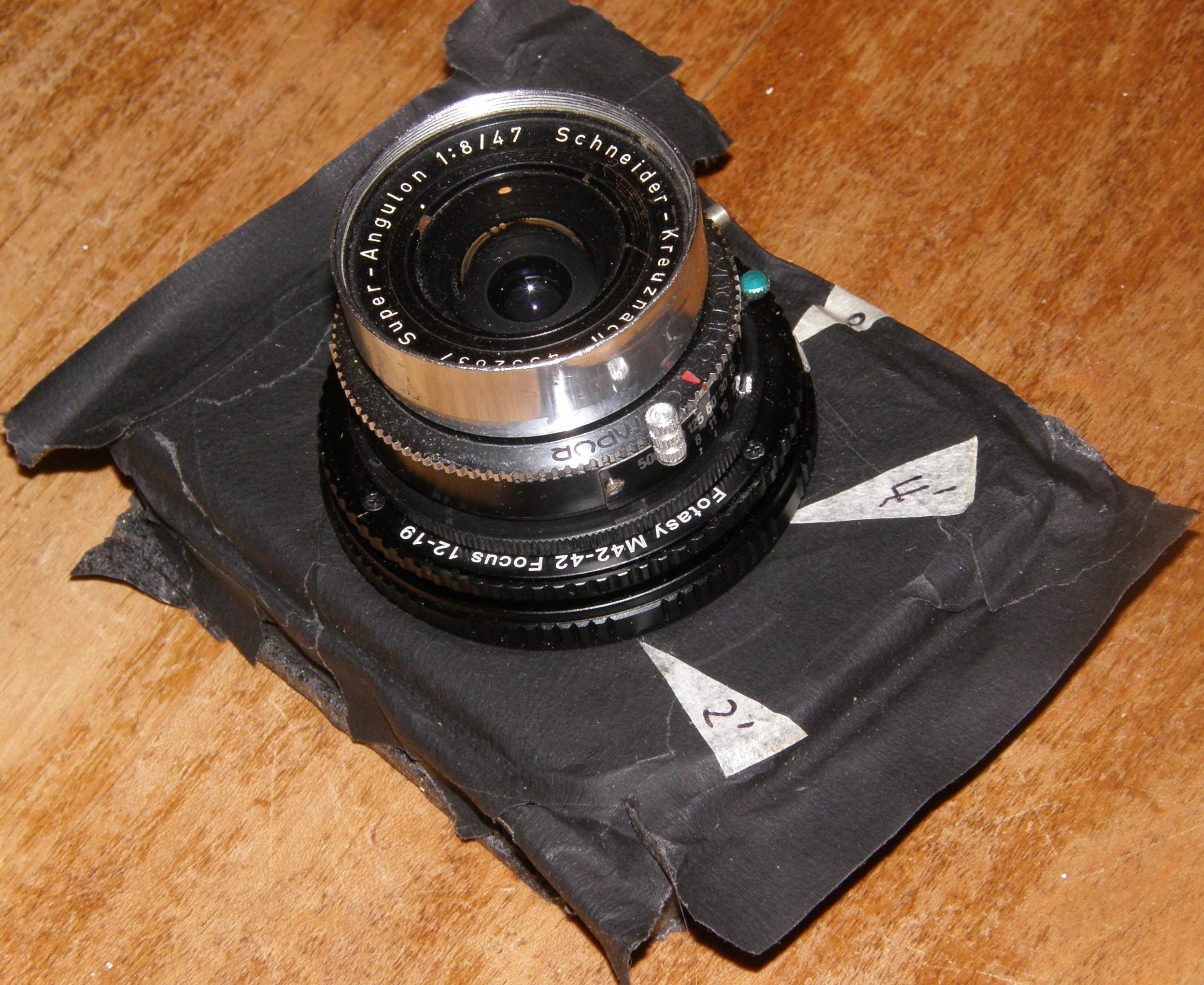

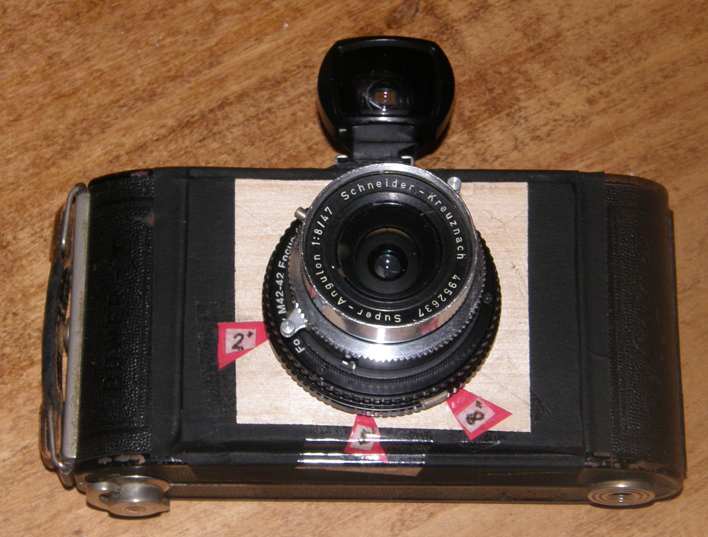

This is me FINALLY getting around to using a buncha things bought over the years. I've had this 620 'Bower-X' camera body sans lens for a very long time, ditto with the 47mm f/8 Super Angulon. I also have a LOT of 620 film, dating back years when I thought the Kodak Monitor 620 was the only camera I'd ever need. I decided to see if I could use the SA and this camera body and get something for sweat equity. I tore off all the lens holding hardware and the front door, and mocked up the SA onto a cardboard lensboard (an empty 6x9 sheet film box) with a cheap M42 focusing helicoid and black masking tape. Took some shots to see if it was worthwhile, it ended up so good I shot several rolls like that. I decided to make it permanent. I got some craft basswood, which is light but about as strong as matchsticks, and laminated it, each layer w/perpendicular grain, with Titebond glue-- making my own plywood. Then I built a box in the camera body, glued on a laminated top, drilled a hole, threaded the helicoid directly into the wood, and used my wife's nail polish to hold the helicoid in place after painting the inside to reduce reflections (good ol' Testors Flat Black). Photos show the progression to finished state. Focus scale (2', 5', infinity) made with the aid of Scotch Tape across the film rollers. It really works beyond expectations-- I'll put up some pics from the test roll in the Gallery. I can't quit the masking tape, but hope people find this build a little less 'nightmarish' (actual Photrio comment) than my earlier ones. I am pleased as punch.
A few additional things: 1) The pale tape on the front in the 2nd shot is securing the steel screws that are holding the cold shoe and 21mm VF in the penultimate shot. They held down the original Bower-X lens VF, and must be self-tapping, because they did. 2) My cold shoe was salvaged from an old Zarya with bad shutter curtains. If anybody knows of a good source of cold shoes for this sort of thing, I'm all ears. 3) I varied the distance scale on the final version by accident-- put down the red tape in the wrong place and decided to go with it 4) The SA lens is mounted in a drilled-out M42 body cap. The plan is to achieve interchangeable lenses by using M42 extension tubes and different tape colors for the focus scale. 5) The Bower-X is identical to an old Adox folder, which I successfully bought on evilBay with a 6x4.5 mask (we'll see if it ever comes-- the seller has been incommunicado since taking my money), so I'll be able to get 16 6x4.5 exposures (equivalent to 28mm on a 35mm frame). I have the VF in hand if/when it happens. Fun!

Looking good! What's the film/developer?
Thanks! It's very expired Verichrome Pan (1973) shot at 50ASA, souped in Caffenol C, semi-stand for 30 minutes. There's some benzo in there, about 20ml/L, to reduce fog.
