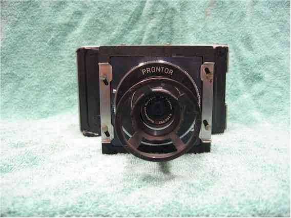

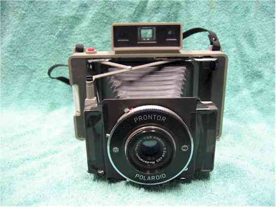

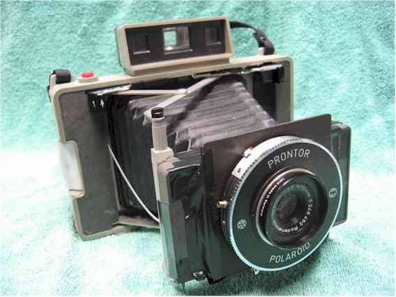

Poor Man's Polaroid 180
Anyone who has looked at the prices of these things on eb*y knows how costly they are. I made mine from a plastic Polaroid folder ($5) and the shutter from an MP-3 (part of a lot at an auction, less than $10) The lens is the front two elements from a Rodenstock Ysarex 105mm and the rear element from a 75 mm of the same line (both from the same auction lot). Somehow matches the 114 mm focal length of the folder perfectly. The Polaroid headbadge on the shutter is an added bonus. I will scan some pix taken with it soon.

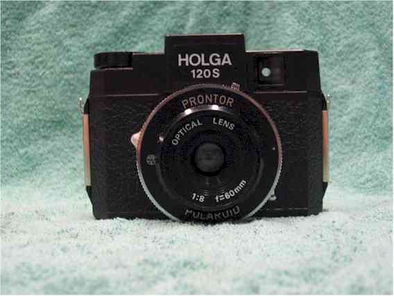

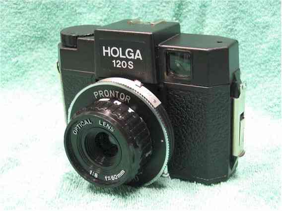

Exposure Control Holga
I got sick of the super wide range of density on my Holga negs- it made it impossible to get a decent contact print, so I wound up having to print every frame just to get a good look at it. To make this camera, I removed the Holga shutter assembly and hot-glued the retaining ring for this Prontor shutter to the front of the body. Next, I screwed the shutter onto the ring and hot-glued the Holga lens to it. For version 2, I hope to add some means to adjust the focus- right now it is hyperfocal.

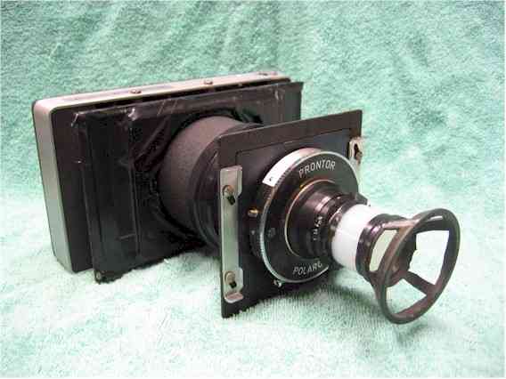

Eyeball Camera
Ok, this one was completely uncalled for. I took the remains of the lot of MP-3 parts won at auction and cobbled together this crime against camera craftmanship. It has a 28mm Rodenstock Ysarex for a lens, and the MP-3 bellows extension for a body. The dissected rubber eye hood keeps the subject (usually an eyeball) the correct distance from the lens. The 35mm film cannister acts as a diffuser.

What are you kidding? I think that you have done a wonderful thing here. I mean think about it. Does sinar or Linhoff or Horseman or ebony make an eyeball camera? Why no they don't. Take a bow man, you have won the 2005 award for coloring outside the lines. I applaud your creativity, your conviction and most of all the amazing amount of courage it takes to show the world what you have done knowing full well that some may scoff and poo poo such avant-guard adventures into camera modification.
I say Yeah!

RE: Exposure Control Holga
Regarding focus, at this point you might consider taking the shutter (with the Holga lens) off and putting it on an old folder. That is assuming that it's the lens aberrations that you love about the Holga and not the light leaks :smile:

Great idea! I never thought of that. I keep conceiving of the Holga body as just a film transport mechanism...I can't believe it never ocurred to me to replace it altogether...

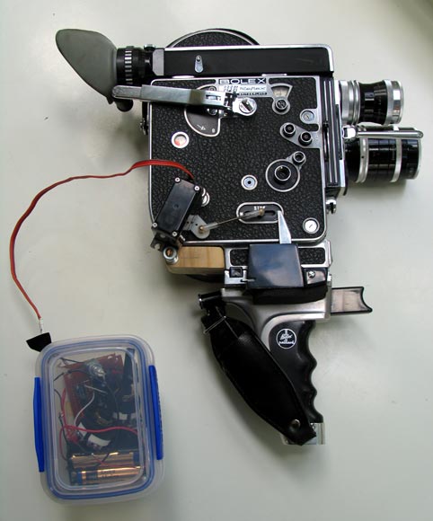

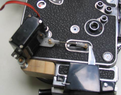

For the cine people here
An 'intervalometer' for a 16mm Bolex - a device used to drive cine cameras single shot capabilities periodically - this one also has the ability to set the amount of time the shutter is open during the cycle period - ie. if its f.p.s was 0.1 (1 frame every 10 seconds) I could adjust the shutter to be open for any fraction of that 10 seconds (within certain a range)
Cine people might find this snippet from an email I sent a friend recently helpful:
... adjustable duty cycle from ~%5- %95 (like shutter angle being 18deg - 342deg) with period anywhere from ~1.5 secs - whatever time you wish (ie. years+) ...
When the period is 1.5secs the shutter angle is effectively set at %50 on the T setting or very low on I (or the other way round cant remember which) - the longer the period the closer you can get the duty cycle (shutter angle) to %100
Its running using discrete logic timers and ripple counters (556, CMOS 4060 etc...) running off simple RC constants switching a relay which supplies the servo two different millisecond pulses blah blah technical etc...
I've had it running with a 18 sec period on already partially depleted AA's for 31 hours now - woohoo!
hopefully shoot some Baraka style stuff soon - but gotta build first:
an equatorial mount and glidecam kinda thingy - then a crystal sync motor ... the list goes on

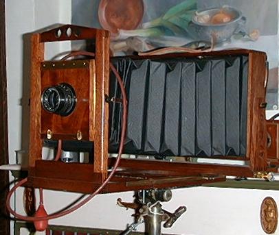

8 x 20 Panoramic Picture Camera
Here is a camera that I built a couple of years ago. It took me about a year and a half to build in my spare time. I built the film holder first, then built the camera around the film holder. The hardest part seemed to be making the bellows. I am now designing a 14" x 17" camera. It will have its own built in rear extension. It will be similar to the Korona Pictorial View camera. I have 2 film holders that I purchased on Ebay, and will be building the camera around them.
