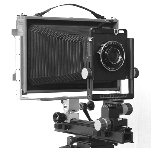

Well, I don't consider myself a camera builder, more of a camera assembler as I leave all the precision work to those more qualified. But, since you also included "mods and creations" in the subject title, here's a pic of my 4x10 Swiss Lotus. It's assembled from bits and pieces from ARCA-SWISS and Lotus along with a few pieces of aluminim bar stock I bought at my local hardware store and cut on my table saw.
It works great, and thanks to the people at ARCA-SWISS and Lotus, is a pleasure to use. The weakest part of the design is (of course) the parts I built. There is a bit of flex in the rear standard - not bad. It reminds me of the Canham DLC I used to own. You can see it flex if you push on the top of the camera back, but once the pressure is removed, it goes right back where it should. So, don't push on the top of the camera back and everything is OK.
Using thicker bar stock would have minimizd this flex, but would have added weight (the camera, as shown weighs 6½ lbs.). Now that I've been using the camera a while and am pleased with the way it all works, I may design a better rear bracket (rigid and light) and have it fabbed by a local machine shop.

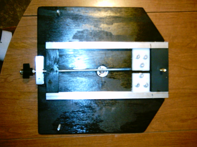

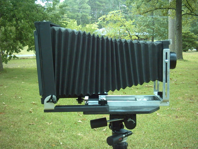

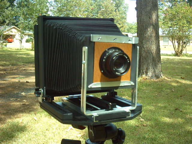

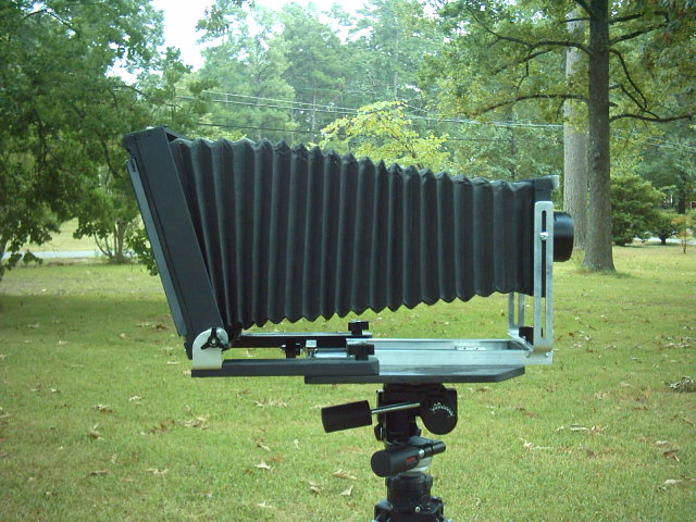

So What do you get if youtake...
A piece of ply, some u shaped aluminum channel,a plastic cutting board, the front standard off some band j camera,a surgical brace support thingy.a bandsaw blade, a rabies tag for a cat, various nuts and bolts, a picture frame from the thrift store, two yards of drapery fabric and some glue oh and a bit of time..why an 8x10 camera of course! oh forgot threaded rod and brass inserts and those plastic thingies they use in the packaging for kids toys these days.
I based my design on a cross between a philips explorer and a kodak masterview, the rest was bodgefied into existance,hope you guys like it!
oh and special thanks to all those apuggers who answered other peoples questions and provided solutions, especially pfitz for the tip on using a tile to glue up frames and calamity jane for the drapery blackout fabric for the bellows.

Andy,
Great looking homebuilt, I like it!!!
And of course Jane's cameras are always beautiful, way to go everybody!!!

Cute.
I can see base tilt at the rear, rise and maybe shift at the front. Any other movements?

Very nice camera Andy, congratulations on your improvisation artistry. Now what did I do with those rabies tags I had lying about?

Interesting idea the twin rails. Great thinking
