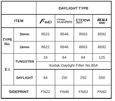

Fuji (when they still made Movie film) had REALLA 500D stock (8692 in 35mm and 8692 in 16mm) and TWO 250D stocks , Eterna and Eterna VIVID. they also had F-64D All gone at the stroke of a pen.
