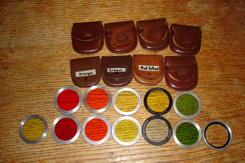

Can anyone tell me how to tell the difference between filters for the i, ii and the iis,iii,iiir lenses? Looking at one of the close filters which I know come in two versions (makina lists two), but the seller doesn't know which it could be. Were the filter sizes different? Or are they optically different?
Most Plaubel Makinas III and IIIR came with the 100mm F2.9 Anticomar lens which takes the illustrated filters, this is my collections. These also fit the F4.2 Antimcomar 100mm and the 73mm Orthar wide angle lens.
Makina Filters What I have by Nokton48, on Flickr

It would help if we know what camera and lens you have. There are variations out there

WOW thats alot of filters ! No wonder I can't find any on ebay, seems like you've got all the supply Nokton hahaha :D

Quick question, would a filter for the Makina I/II fit onto a quick change Anticomar or Orthar found with the IIS/III/IIIR ? Other attachments designed for the I/II Anticomar like the R0.1 Close up attachment or the 4.5 Reflex Ring will fit the IIS/III/IIIR aformentioned lenses.

I've got a iis. Which looks like it's 40.5 or 41.5mm. so the i &ii take smaller filters? Because that would make it easy to distinguish between them.

For a IIS, the filters as seen on Nokton's picture are the technically appropriate ones. But as I mentioned on my question directed at him, I know that at least certain close up filters and other attachments for the I/II will go on a quick change Anticomar for the IIS/III/IIIR. I am not sure if this is the case for colour glass filters for the I/II also.

From this page: https://camerapedia.fandom.com/wiki/Makina
And this info in it:
  • filter and close-up lenses (first # for Makina I and II, second # for Makina IIS, III, IIIR)
    • close-up lens T 1,5, fits all lenses, distance of 65cm with standard lens, #125/1, #483
    • close-up lens DIN, fits all lenses, distance of 45cm with standard lens, #485
    • close-up lens R 0,1, fits only wide angle and standard lenses, for lifesize reproduction, #125, #484
    • yellow, light, #118, #505
    • yellow, medium, #118/1, #505/1
    • yellow, strong, #118/2, #505/2
    • orange, #118/3, #505/3
    • green, #120, #506
    • red, #120/1, #506/1
    • blue, #120/2, #506/2
    • ultra-violet, #120/3, #506/3
filter thread size (behind the shutter) :41,5mm
It would appear that only the DIN filter fits both.. confusing if they both have the same filter size.

The R0.1 attachment I have Im pretty sure is for the I/II but threads onto the front of the anticomar on my IIIR just fine. Same with V2/V3 extention attachments that I own, and I am pretty sure the same applies for the 4.5 Reflex ring, though I do not have one to test with. I'm pretty sure the same will apply to the glass lenses. Really it makes sense that filters and attachments between the anticomars are interchangeable, as the lens diameters (and thus lens ring threads) must be the same, given they are essentially for the same system, the only operating difference being the position of the shutter. The principal change that was made in introducing the larger filters/attachments as seen in Nokton's pictures, was to make them able to fit to the now standardised Tele-Makinar also, something that could not be done with the original filters.

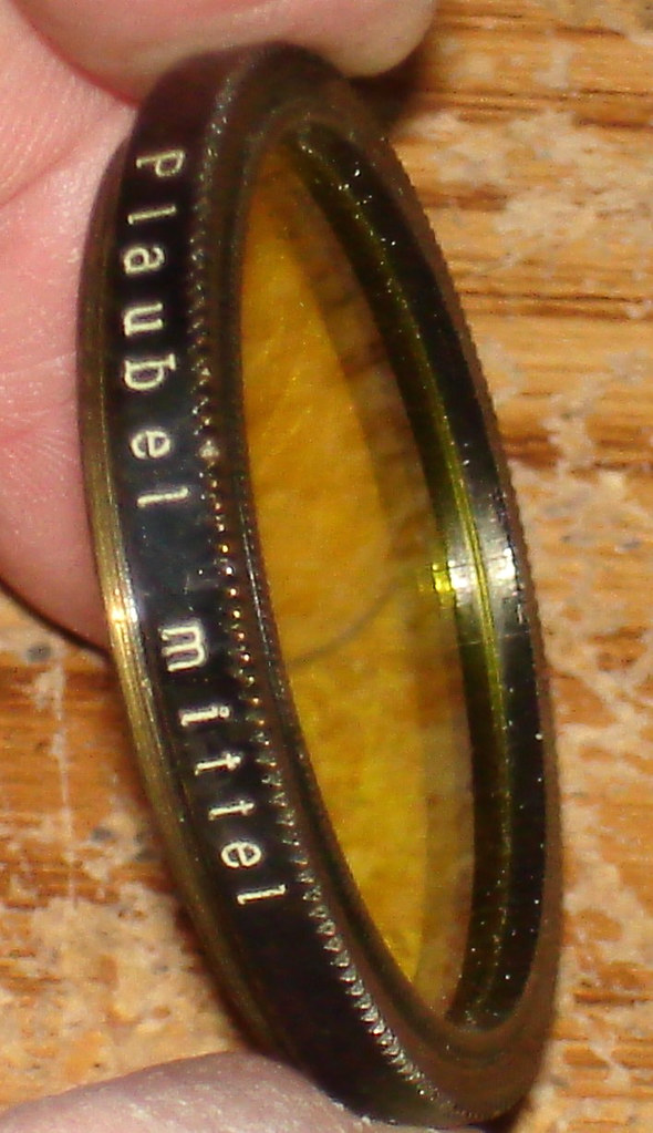

My Makina II Yellow Filter by Nokton48, on Flickr
I leave this filter on my Makina II all the time. With calipers the outside thread diameter measures 37.5mm My camera has the 10cm F2.9 Anticomar
So, generally earlier versions are 37.5mm threads and later 41.5mm.

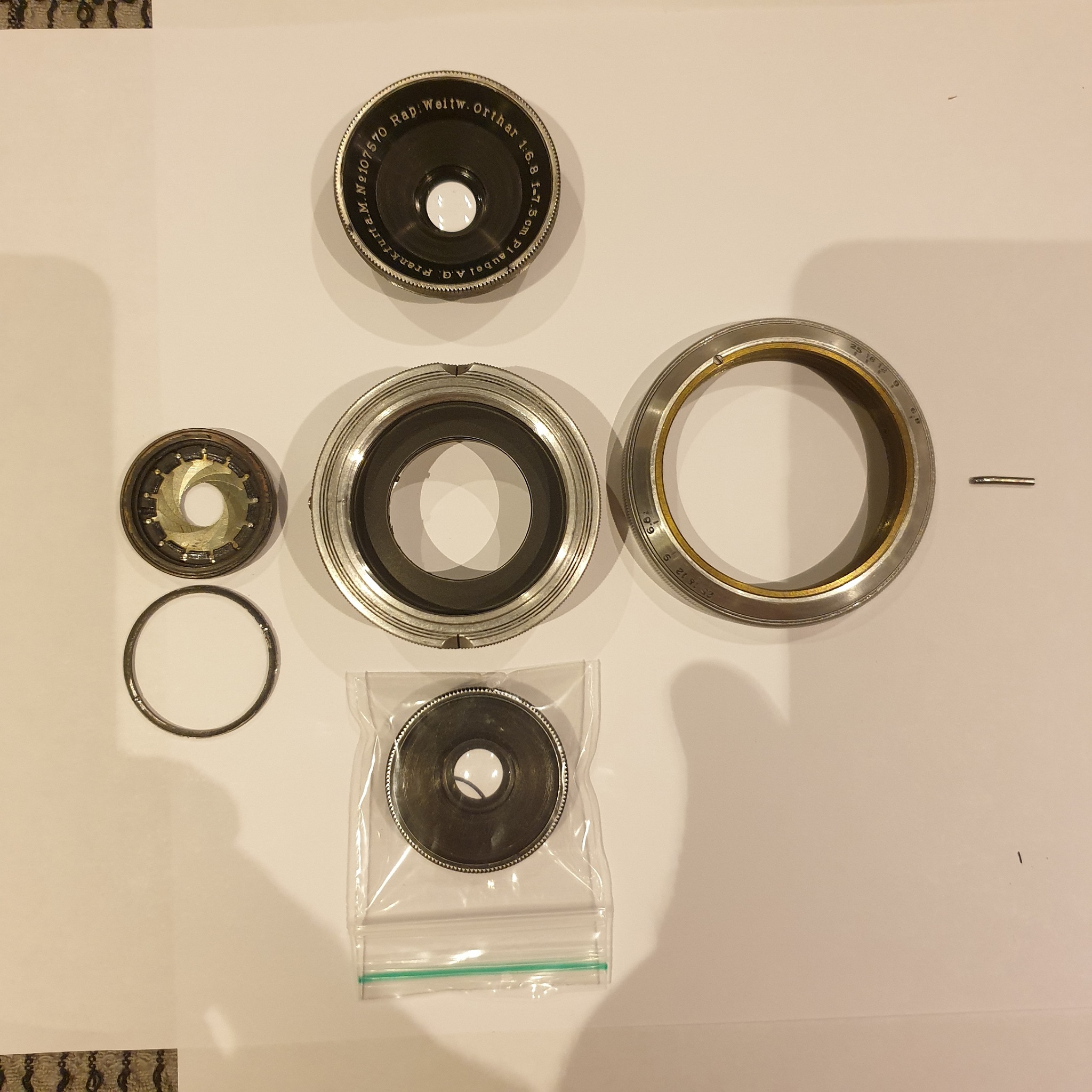

And for those interested, I thought you might like to see the 7.3cm orthar in CLA mode.
Very nice. Are you performing the CLA yourself ?
Yes. I recently bought a completely gunked up agfa record iii with the solinar in a compur rapid. I successfully rebuilt the shutter, rangefinder and camera as my first CLA, with the help of a lot of YouTube. Got the bug now. This is simple in comparison. It's just getting your eye in.

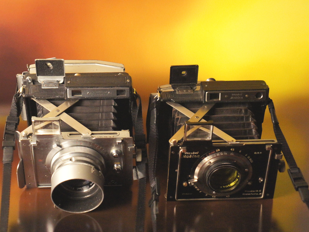

On the left my Makina IIIR with 100mm F2.9 Anticomar, Focal Plane Shutter attached, you focus with the small scale directly below the front optical viewer, it's on the backside. Never noticed it was there, heh heh. Geoff Berliner agreed with me that this is an important accessory, since you can shoot high speed 400 film at 1/1000 which is a distinct advantage, when you are trying to shoot wider open with a distinctive F2.9 speedo lens. BTW I have standardized shooting Ilford PanF+, it's the perfect speed for this 6x9cm photography. High speed film was like EI 100 back in those days. 1/1000 was a huge selling point. Using the focal plane shutter is really quite a hoot. You measure the distance using the reg camera rangefinder, then set that distance on the scale on the flip side of the bottom of the front finder bottom. 50 ISO film is the sweet spot with these cameras. The trigger for the focal plane shutter (which becomes the camera release) is the lever right next to the rear optical finder stack. So you hold the camera differently with the focal plane shutter.
On the right is my venerable and totally lovable Makina II stealth black camera also with 6x9cm back and Ilford PanF+. This one does everything I want and need very precisely. It like transports me back to the twenties it's a lot of fun to use and very intuitive in practice.
I am recently enjoying using both of these fine cameras. Folded up not too bad to carry around, even with the roll backs. Guess that was the real point of the design, to be stealthy in reportage. A blast to use, recommended
