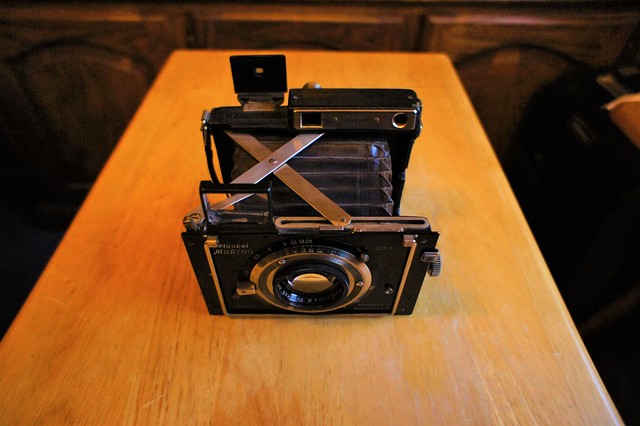

  • My Makina II has arrived here from Germany! Only two days time by Fedex! Lovely cosmetic condition but needs a good cleaning indise and adjustment also. Considering it was made in the 1930s, I am not at all surprised!
    It is going out this morning to Mr. Binder in New York City. He is an early Makina repair expert, and has a very large collection of Makina parts!

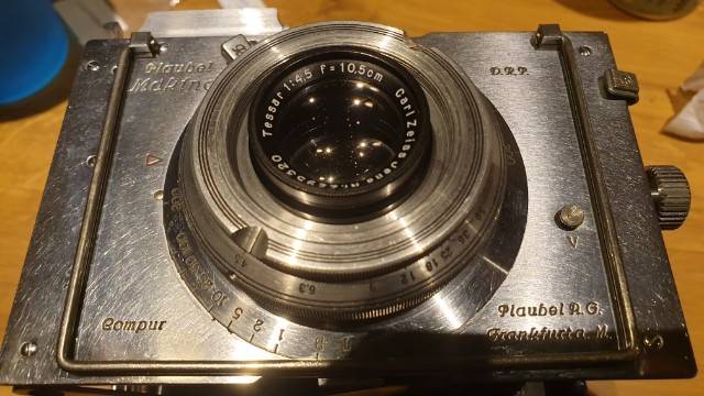

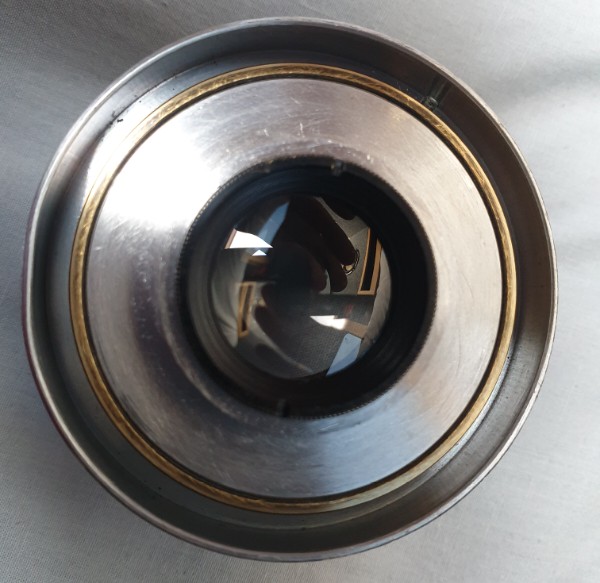

Just got a iis, needs a bit of cleaning and tlc, previous owner has repaired the bellows with electrical tape, anyone know someone who can repair or renew in the UK. Also it has a Carl Zeiss Jena 10.5cm f/4.5 on it that I can find no info on, anyone know anything?

That lens shouldn't be there, no models were sold with Tessars but ok, let's say the prvios owner did a good job and the camera has been adjusted to that Tessar and even rangefinder is as well, also the aperture I'm not sure if the following numbers from 4,5 till 25 will be accurate for that lens.
Those are a lot of 'if's
I just finsihed one IIS model I was planing to sell, plus one II plus another III that is still being adjusted, really that guy has my admiration if he did all the previous things...
So if the camera works, keep it, why not... but unlikely you will sell it in the future.
Of course it's my opinion, sadly I don't have an Anticomar 100mm spare for you but I have one wide lens Orthar without camera.
Alex
Yes, it certainly is strange. Aperture scale goes all the way to f/50, and if it has been a DIY project, it's been well done, apart from someone painting the back of the lens black, badly, but I'm suspecting someone didn't understand the issues with film thickness problems and was trying to sort that, no doubt also with the tape on the bellows. The is however a record on the internet of a lens like this being sold by Christie's in 2004, I'm wondering if this was our, or someone was doing this mod and selling them. Would love to know what the lens was originally from. Any ideas on bellows repair in the UK?

There is no way to know where that lens was comming from... 10.5cm f4.5 Tessar.... So many cameras wearing this lens that it's impossible...

What's confusing me is I can't find a lens that would have been the donor mount. The aperture ring is engraved from f/4.5 to f/50, and nothing about it looks cobbled together. Do you know of a plaubel lens that fits this? I'm away from home at the moment, but will send pictures tomorrow.
I have no answer for that, maybe you have the one sold in Christies... I tried to find that auction on their sit but I couldn't find it.

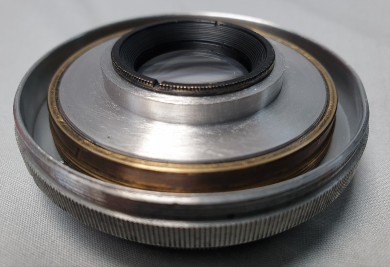

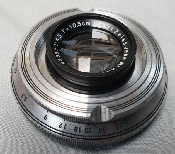

Here are the photos of the lens, what's also strange is that there is an external thread as well as internal on the barrel, but all the styling is of a plaubel Makina lens. I'm trying to find if the person it came from did indeed buy it from Christie's.
Well, aluminum seems the same but number lettering are different, I just checked with 4 Orthars and 2 Anticomar lenses and the font of your lens differs than the ones I have, also there is no ',' in my lenses, they are with '.'
Are your number lettering engraved or painted over only?
The lettering is engraved. The front of the Carl Zeiss part is consistent with the same lens I have found that was mounted in a few different cameras and large format lens boards. Are the engraved f/numbers the same format? Seems like it would have been incredibly expensive and pointless to make such a copy unless you had access to the factory machines and blanks, not to mention the aperture mechanism. A special order perhaps. Don't know what advantage the Zeiss tessar would offer. I'm very intrigued by it. Have emailed Christie's to try to find out if this was the same lens, or if there are more in existence. Thanks for your help.
Oh, and range finder hasn't been altered and from rudimentary testing the lens corresponds to focal distance on camera, at least for sub 2m. More testing needed.
Another example of the 10.5cm
Yes, the font in all my lenses are consistent, same and only in one is engraved, rest are painted over, I can't feel the lettering if I pass my finger over it.
My wildest guess is someone from Zeiss deleted old aperture and made this lens, so probably is the same as Christie's or from the same source.
If you can get photos from that auction everything will be clear :smile:

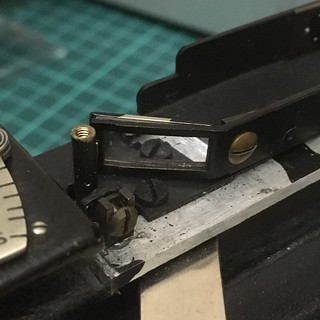

While this thread is back I thought I might just pop in to request some advice from the Makina gurus. I recently purchased a beautiful iiir from another member here however it seems the RF calibration may have been knocked in shipping. It appears to be correct at infinity and checked on the ground glass however at closer distances the RF moves out of alignment. I've had the top cover off however cant seem to identify the screw that allows for changing the rate of movement of the RF mirror to the lens movement(or any of the adjustments for that matter!) Any words of wisdom would be much appreciated (Photos even more so!)
It's odd a bump can take off only close focus.
What I would do is to check the distance marks with the ground glass and the rangefinder to see which one is correct.
The screw you are looking for is located here:
The bronze screw located in front of mirror, this one sets the whole rangefinder plate back and forward pivoting on the left screw cover pillar. There are 2-3 screws that set securely the rangeinder plate so just unscrew them enough to let this screw do its job.
Of course is a trial error procedure and once you move this you hace to adjust back the screw for the horizontal adjustment set at the left of the rangefinder (there are 3 vertical screw and one at their right, this last) and then go again to close focus and check if you are closer or more far than before, then repeat.
'I think' this is the way but I might be wrong, the all mighty WizCam would tell you how to do it much better than me, I'm just an aficionado.
