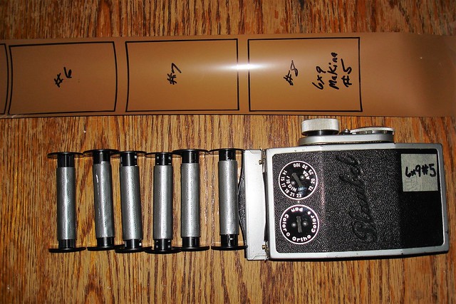

I have just decided I will no longer attempt to load modern plastic 120 spools into Plaubel Makina film backs. I shot a rather important roll a couple of weeks ago, using a plastic spool I wrapped with duct tape. Well when I opened the back to change film, it did not load evenly onto the spool, and the roll is fogged! Luckily I was able to switch backs and reshoot my important photos but I am not going through this again!
I bought another dozen wooden spools for the take up side in these backs, which will solve that problem! Onward and upward! :smile:
I am opening and re-loading all of my Plaubel backs with wooden take up spools as of now.
Film advance with these old wooden spools is smooth as butter. Very nice!
Hi,
I've had some frame spacing issues with older cameras including the Plaubel Makina roll film backs. I've heard that this is caused by the difference in older thicker film and the new modern thin film. The solution I've heard was to add thickness to the takeup reel with tape so more film is pulled with each advance of the knob.
Is this what you were doing with the tape on the reel? Is the wooden reel thicker so you don't need tape? I also look forward to hearing how the wooden reels work out with frame spacing.

Hi Again Robert,
Yes increasing the diameter of the modern 120 spools which results in beautiful even frame spacing, as you can see.
I used three go-rounds of duct tape on each spool and it does the job (sort of). See below.
DSC05861 (2) by Nokton48, on Flickr
DSC05851 by Nokton48, on Flickr
The Makina "advancing key" fits tightly and precisely in the wooden slotted end of the spool. Just exactly like it was made for it!
Kodak 120 film spools by Nokton48, on Flickr
However, the tape is not wide enough, and can result in uneven roll winding. The result is straining to get the film through the film back all the way to the end of the roll, not a good thing for it's gearing, etc.
These old wooden spools are the answer. Easy to load (no taping of the roll when loading, a real pain!) and it really goes through smoothly. I have some Kodak, Agfa, and unmarked spools, they are all identical except for the metal stamping.
Try one and be amazed! These are the right take up spools for these really old film backs.
