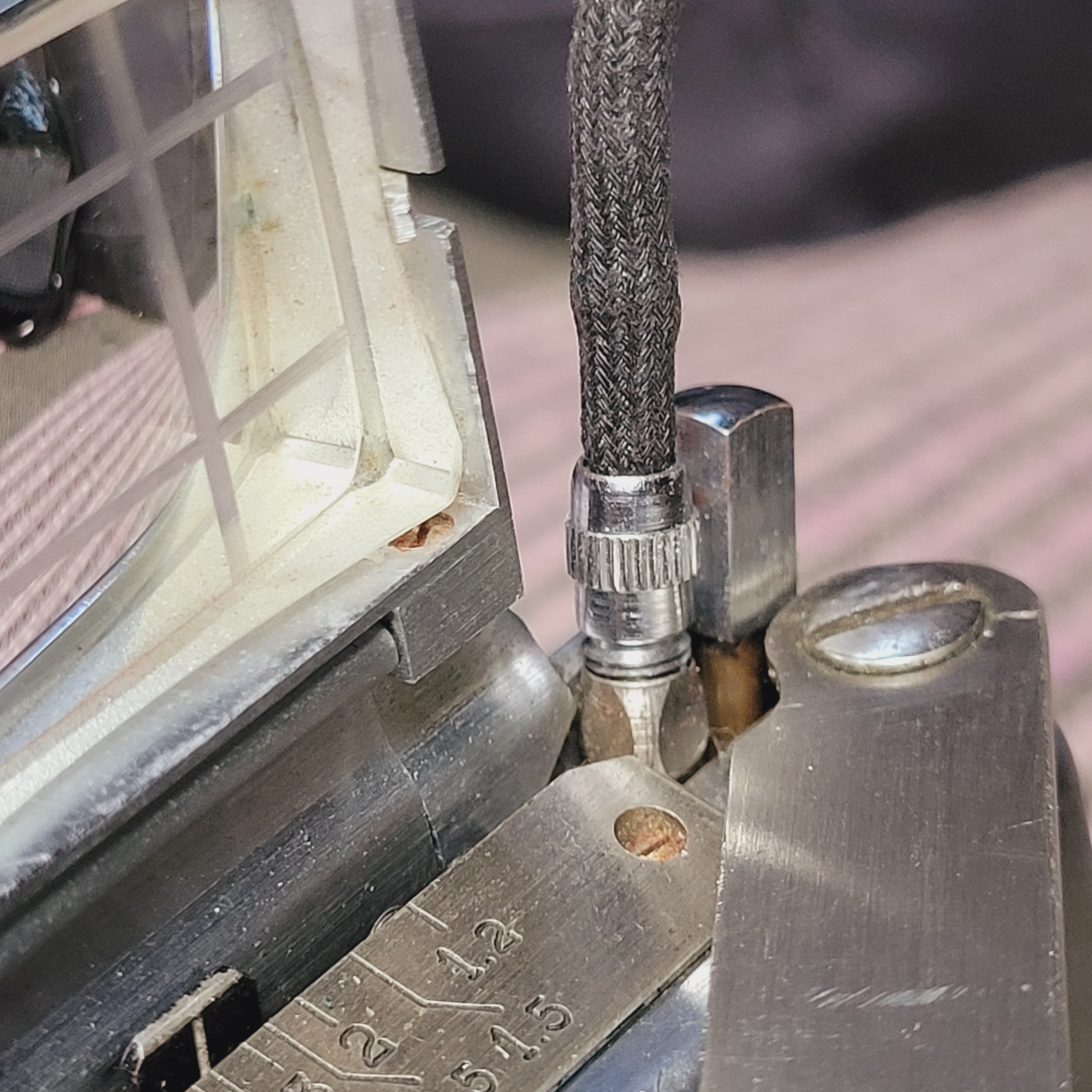

Yes let us know if it fits. I strongly suspect it was something Prontor made custom for Plaubel.
Prontor seems to have made Plaubel Makiflex Cable Releases, there is a strong family resemblance that I am detecting. So it would make sense they also made them for Makinas. I'd like to have one for myself, actually :smile:

You will be pleased to hear the prontor shutter release cable fits as snugly as a glove.

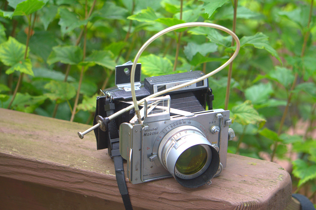

There seem to be plenty of Olde Prontor Releases around, which is good. I just bought an early double release at a good price.
Makina IIIR New to Me Prontor Cable by Nokton48, on Flickr
Bought this Prontor Cable Release for $16 on Ebay. Works like it was made for it on the Makina IIIR! And your finger fits just fine if you want to manually trip. This will help me make sharper pix in certain circumstances. Recommended for Makinas!

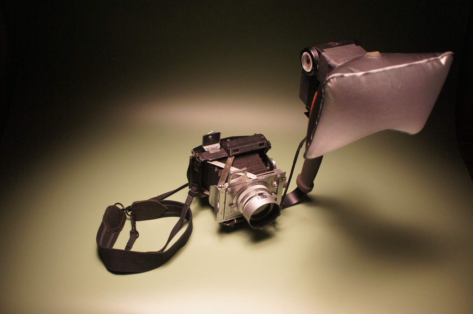

I want to use this as a "Reporter's Camera" as would be done in the day. Adding the Makina Tripod Adapter, gives tremendous stability to the camera, and it lines up perfectly with the Stroboframe Bracket I use for portable flash photography. The thyristor in the 283 makes for auto flash photography with the IIIR. It's a tough brute of a camera, suitable definitely for Press Use, simply by adding the Tripod Adapter.
The Reporters Camera IIIR F4.2 283 Tripod Attachment by Nokton48, on Flickr

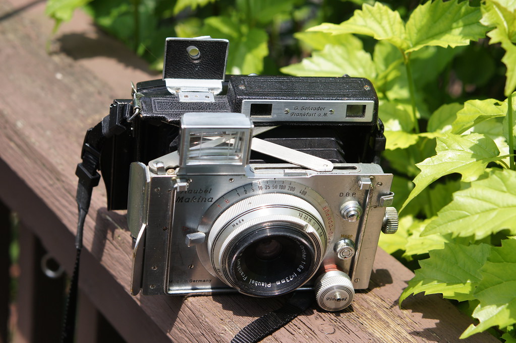

This is my 7.3cm Orthar, it fits screw-mount Plaubel Makinas. It takes the same filter as the 100mm lenses, which is good. I've been told it's a 4/4 Double Gauss optical design. Best not wider than F11 for best results. Plaubel made an optical finder which slipped over the standard one. Great for wide angle shooting with III or IIIR handheld.
SONY DSC by Nokton48, on Flickr

Left is my 73mm Orthar Viewfinder which works fine on my black Makina II, excepting that I don't have a wide 73mm that will fit it!
Right is my 73mm Orthar Viewfinder which works good on my IIIR. However, I have to remove my eyeglasses to see sharply with my IIIR. Not a major obstacle, the view is very precise. And it is marked for different backs, 6x6 etc
