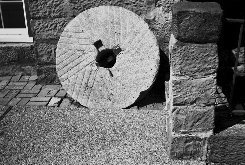

Plaubel Makina III F4.2 Anticomar Foma 200 MicX by Nokton48, on Flickr
Ye Olde Mill, Utica, Ohio. Plaubel Makina III, F4.2 Anticomar (their -sharp-lens!) Foma 200 Microdol-X Replenished.
Notice the precision framing at the edges top and bottom. The Makina Viewfinder is quite accurate to the film and allows this kind of precision framing if you wish. Not bad for a rangefinder!
"Notice the precision framing at the edges top and bottom. The Makina Viewfinder is quite accurate to the film and allows this kind of precision framing if you wish"
So, that is the way you framed it when shot and not a crop after the fact?
Very good for sure.
Very good for sure.
Hi Robert! Yes I composed starting at extreme edges top and bottom, adjusting camera distance and position, until framing was -right- where I wanted it. No cropping after the fact in this case.
I'm quite impressed with the accuracy of the Makina Glass Viewfinder. Good enough to frame precision compositions.

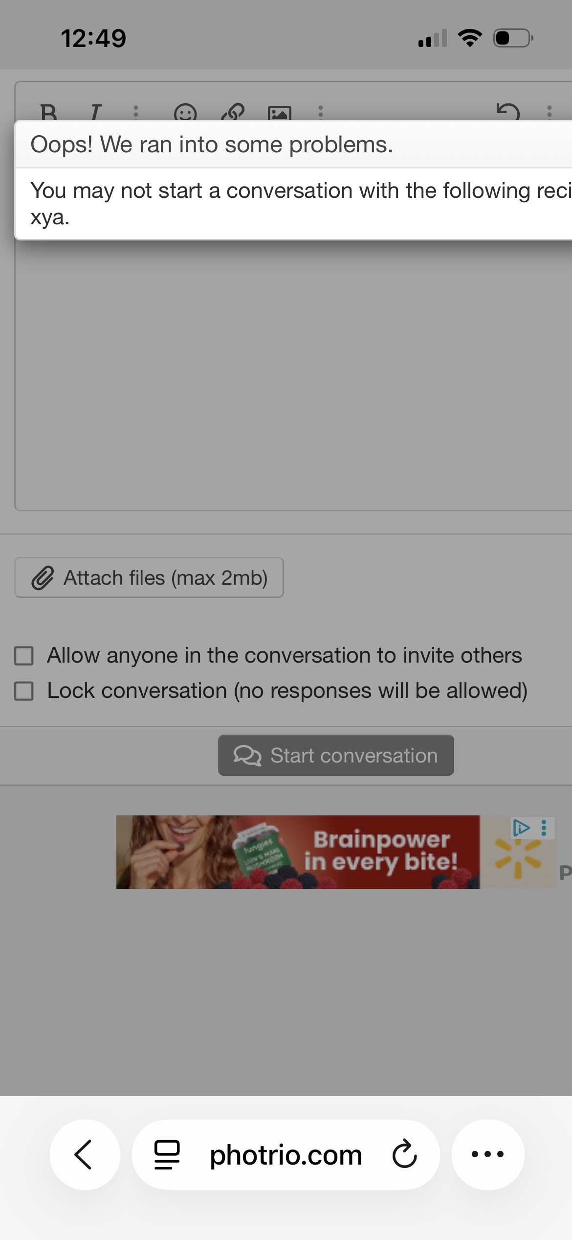

PM me your E-mail address and I can send you a .pdf file. I'm the owner of the site Nokton48 just mentioned...
There must be a security setting preventing me from viewing your profile or sending you a pm.
