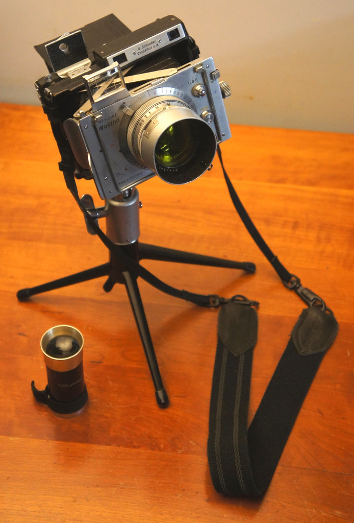

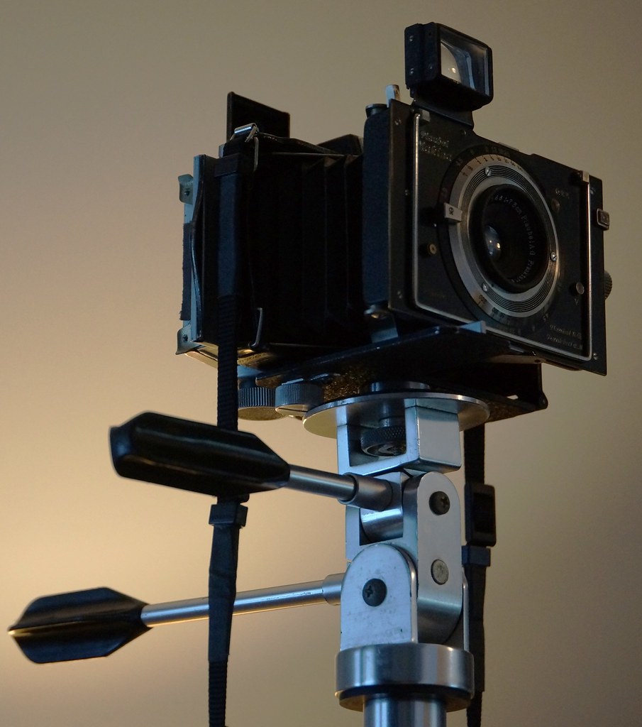

OK I figured out how to attach my Makina IIIR to my Leitz Tiltall, using the Leitz Ball Head. Using the Focal Plane Scale. Unfortunately they are not even close! DRAT. However I can use the FP Shutter perfectly at infinity, and I'll continue to test ti at more medium lens distances. And I'll shoot some 6x9cm Kentmere at EI 800, so I should be able to test the faster speeds. And of course I can shoot on a tripod if I use the groundglass to focus, then put on the film back. Like using a Mini View Camera. Plaubel used to call the Makina "The World's Smallest View Camera". Which I can now do using the FP Shutter.
Leitz Tabletop Plaubel Makina III FP Shutter Groundglass by Nokton48, on Flickr
The Leitz Tiltall Tabletop is a good match to the Plaubel Makina IIIR with Focal Plane Shutter. Right now will focus using the groundglass, then put on the film back. And also I scale focus the Focal Plane Shutter using 800 EI Kentmere 400. Next I will test how well the Focal Plane Shutter works with film.

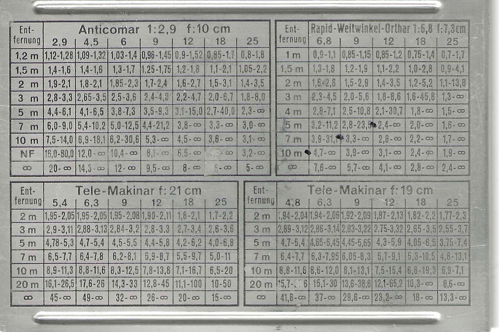

I have photocopied and printed, copies of this Plaubel Makiina Depth of Field Scale, which covers the four main Makina lenses. I then taped (Scotch Gift Tape) to the back of each of my 6x9cm Plaubel Makina Film Backs. An instant reference regarding the best focus setting for a particular photograph, and the chart is right at hand, can be studied right before making the exposure. I think this is a very positive improvement in my handling my Makinas, especially when used handheld out in the field.

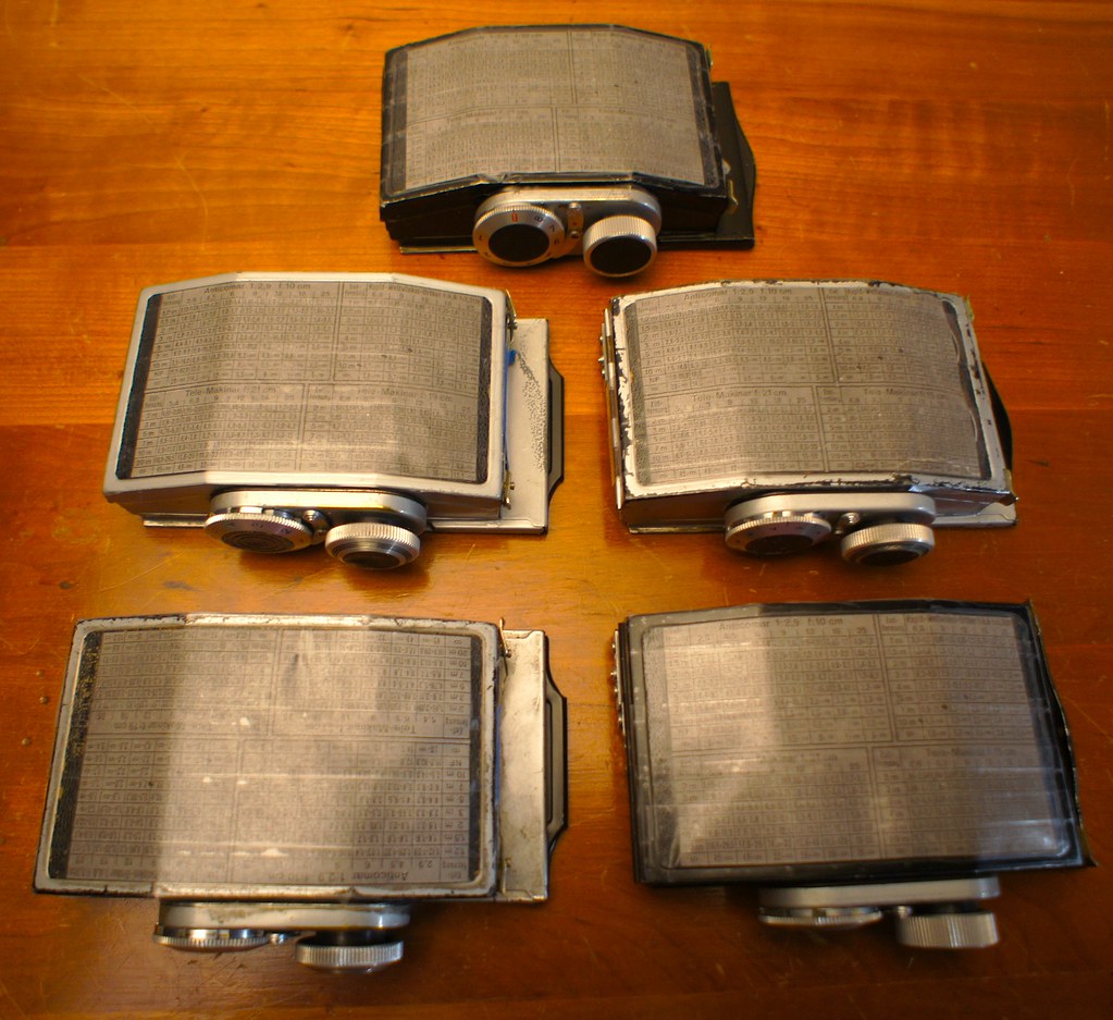

Here's five of my Plaubel Makina 6x9 Film Backs, each one has a Depth of Field Scale attached with Scotch Gift Tape (strong stuff). So when Makina Composing and Rangefinding, it's easy to consult the tables, there is one for each of the four main Makina lenses. Especially when using the Wide Angle 7.3cm lens, it is important to set the lens at the best hyperfocal focus setting. Having these tables at hand will facilitate sharper Makina pictures.

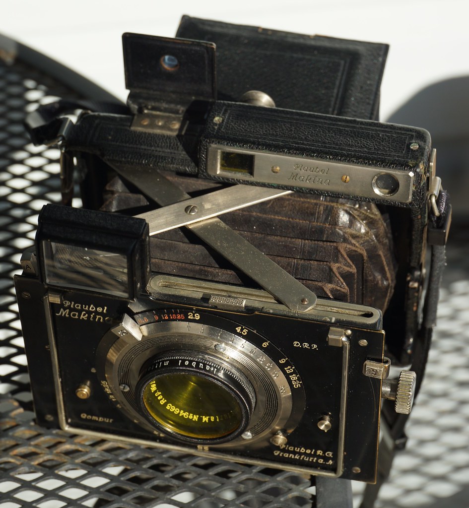

Plaubel Makina II Body, with Groundglass Back with Hood. Three correct original lenses. Far left the 7.3cm f6.8 Orthar, then the 100mm F2.9 Orthometar. On the far right, the 21cm F6.8. Black Finder Masks II vintage 7.3cm left, and 21cm right. So a fairly complete set ready to use. Great for carryin' around.

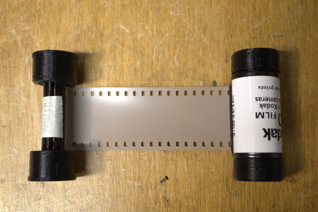

I just received a 3D printed adapter for shooting 35mm film in 9cm width, the instructions show rerolling the 35mm film inside cut down backing paper. This could also fit my Makina 6x9 Backs.

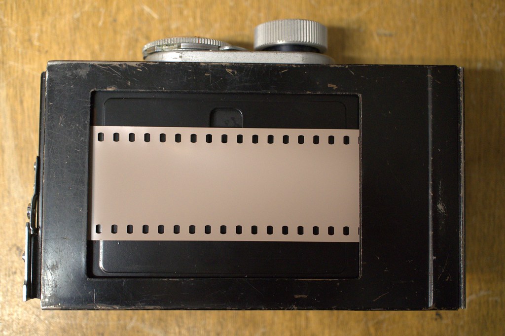

Hello Again Plaubel Makina Fans. I bought this 3D Printed Four Piece 35mm Film Back Insert set for $12 on Ebay. It's plug and play with Olde Plaubel Makina Film Backs, and any olde scrap 35mm film you may have around, B&W or color. Not perfectly flat, I wonder if an optical glass plate could be added, to flatten the springy 35mm to the Makina Pressure Plate. Then you could prolly shoot panos with your Makina, making it a lot more useful and usuable. And sooo easy to do. If you stop down as I do, it should be fine to use, as-is??

You know Guys, same thing could be done with 70mm film cut down to fit 120 spools. Hmmmm....... Slit down 70mm could be re-taped onto 120 backing paper. Great cost savings, B&W 70mm is on Ebay. Lots of ways to make these Olde Makina backs play again.
Thats indeed something i have done before too, not with the makina but another medium format camera.
For 70mm film, it would beat re-spooling 120 film, which i have not tried yet, but i think it would be better to just make a new back for it, or even just a thin 70mm film cateidge to use the regular plaubel 120 film backs for 70mm film.
The film back i am hoping to make would have 2 settings, one for IMAX and one for panoramic.. Similar to how the XPan works. With a working frame counter and mechanically similar to how the plaubel 35mm film back works. It‘s definitely a nice engineering challenge for myself, and if it works out, i will share it here :smile:

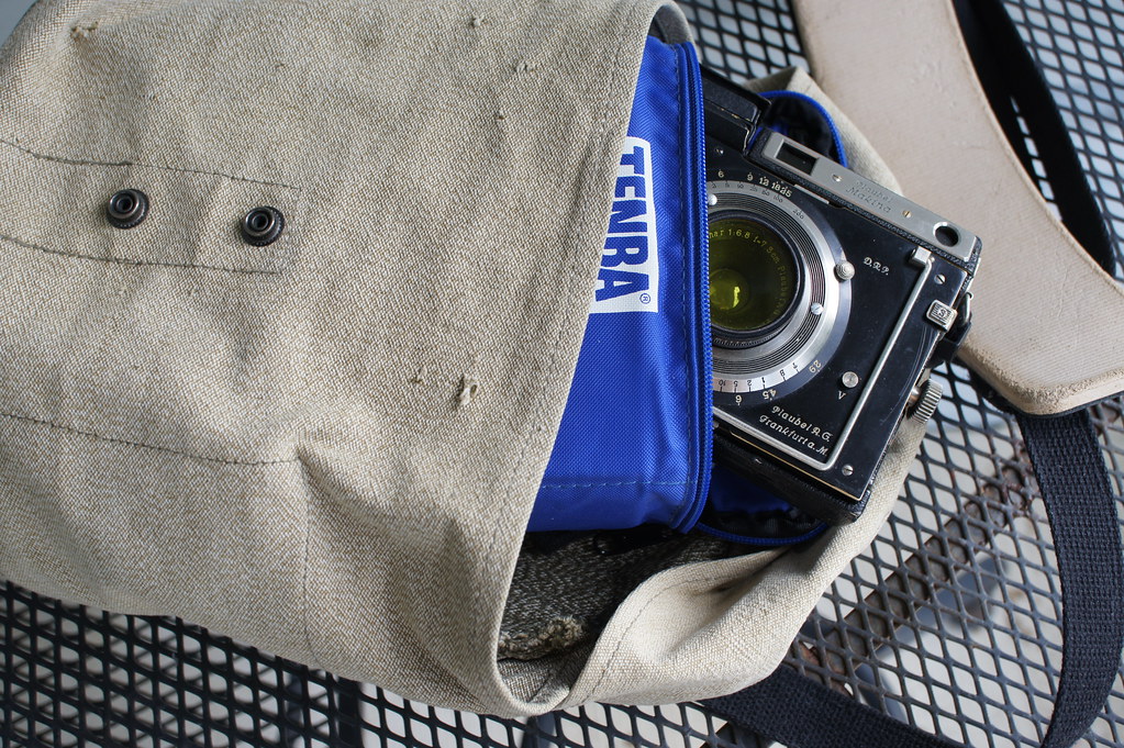

New Way to carry my Makina II 100mm 7.3cm 210 lenses Backs Extras by Nokton48, on Flickr
I've always like this Swedish Medical Bag, bought at local Army Navy Store. 4x5 Tenba Back is perfect size to fit the Makina III with 7.3cm Orthar, bag also fits the 100mm, and the 21cm. Plus Makina 6.5x9cm Roll Holder, and Extras. Nicely padded and now no more bruises from carrying around the Makina III in this bag, nicely padded and protected. Domke Postal Strap necessary, this is a small heavy stealth bag, great for shooting. My entire Makina II System fits in this medical bag.
