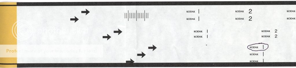

Kodak sent me an email. They say they are no, well, to quote: "
Dear Mr. Carter,
We are in the process of printing backing paper with an added frame number track for Voigtlander Bessa 6x9 cameras. See below. The very bottom track is the one we have added back.
Here is the photo of what they sent to me:
Here is a photo of paper, (PX125), with my window outlined, which I immediately sent back to them:
Are they adding the correct row or not? I specifically asked for the inner track in my initial inquiry.
What I wrote:
Hello,
New 400TMY no longer has 9 rows of numbers. I tried to use my Voigtlander Bessa 6x9 / 6x4.5 that has two red Windows in a line not on the edge and not in the center. No numbers could be seen. A piece of one was seen way out of frame. TX is the same.
Lightness of the ink is not the issue here. The numbers are gone entirely.
Please put them back.
Thank you.

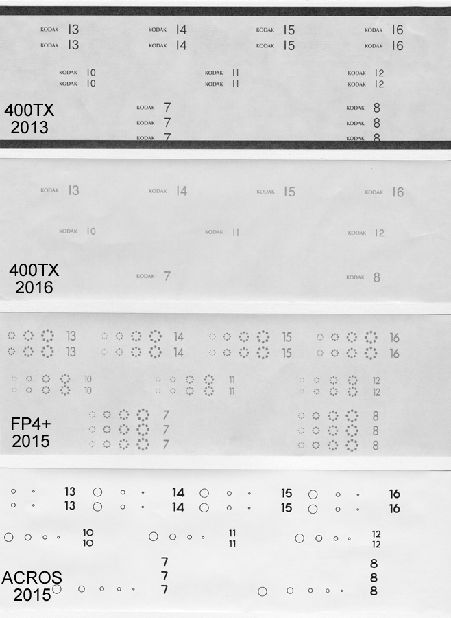

OK (since a luncheon excursion was canceled :angel:)
Note the competition has the multiple rows of numbers.
Also, not obvious in this scan, but the Fuji paper is whiter and has a glossier surface, as in maybe they have a different source (their printing is darker too).
As an old coworker used to say "Ah wish ah understood all ah know about this here thang."
Thanks for posting the film backing scans. They are most helpful.
After running a roll of Ilford through a new Ondu and not being able to see the numbers I went out and bouught a roll of everything available to try and figure out whose frame numbers and paper color provided enough contrast for me to pick out the numbers or at least a darkening where they were but haven't gotten around to exposing any of those rolls. It looks like I am going to have to bight the bullet and spend the extra $ on Fuji.
After running a roll of Ilford through a new Ondu and not being able to see the numbers I went out and bought a roll of everything available to try and figure out whose frame numbers and paper color provided enough contrast for me to pick out the numbers or at least a darkening where they were but haven't gotten around to exposing any of those rolls. It looks like I am going to have to bight the bullet and spend the extra $ on Fuji.
Glad it was helpful. One advantage of Fuji Acros for pinholery is that its reciprocity characteristics are better than average, requiring less adjustment for longer exposures (no compensation up to 120 seconds). Don't know if that's worth an extra cost, but at least it's something. It appears we can't let our guard down on this stuff!
I've been waiting for the TMY2 bleed problem to disappear completely before I order more, but now, if the numbers have truly disappeared, I will be ordering no more TMY2. Many of my cameras have the "ruby window" and that means Delta 100 and Delta 400 are now going to totally replace Kodak for me. Not a problem since I like both of the Delta's, but still think TMY2 was the "Gold Standard" when it comes to ISO 400.
I agree with TMY2 being a gold standard but it is a subjective choice;my all-time favorite for bodyscapes and portraits though.
