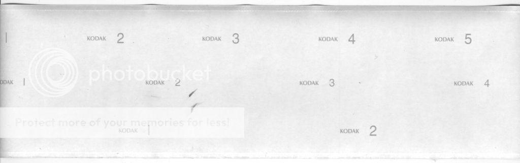

Numbers on 120 backing paper not aligning with red window

Could you scan a sample of this paper and post it. I would be most interested in its appearance. I cannot verify any other instance of this other than this thread.

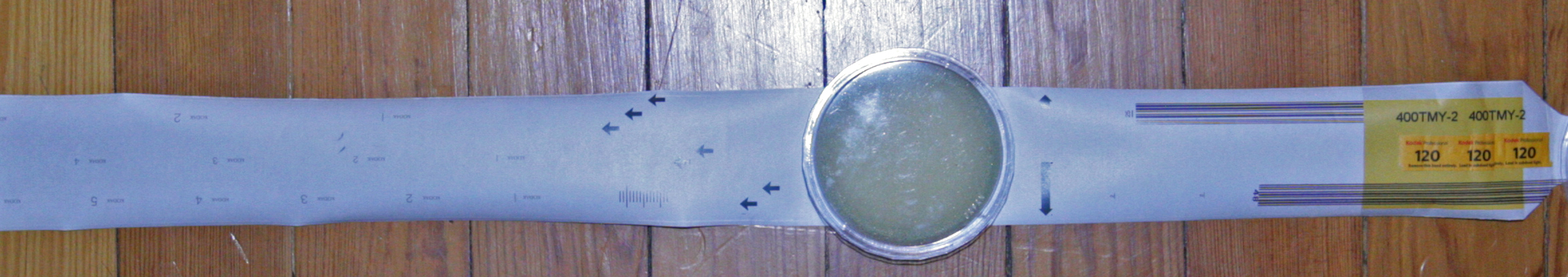

And many fewer numbers.
Yes, not where the Bessa could see them.
What version of the backing paper is that - i.e. when did you acquire it, and do you know what the "Develop Before" date was?
I ask, because my understanding is that there have been additional changes to at least partially deal with this consequence.
