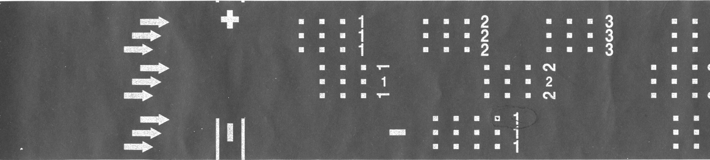

Kodak sent me an email. They say they are no, well, to quote: "
Dear Mr. Carter,
We are in the process of printing backing paper with an added frame number track for Voigtlander Bessa 6x9 cameras. See below. The very bottom track is the one we have added back.
Here is the photo of what they sent to me:

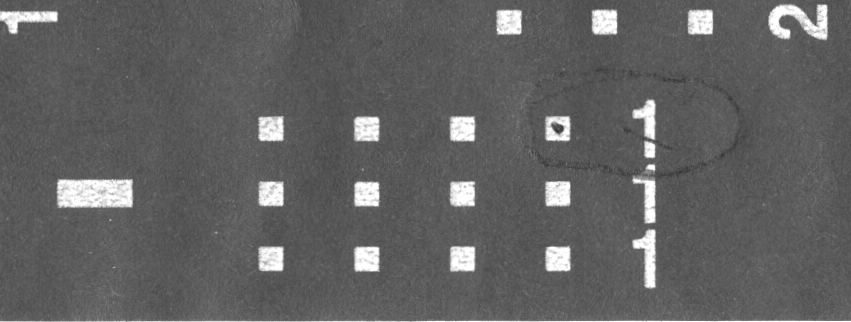

Here is a photo of paper, (PX125), with my window outlined, which I immediately sent back to them:
Are they adding the correct row or not? I specifically asked for the inner track in my initial inquiry.

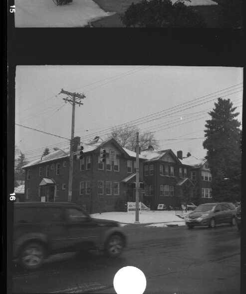

I certainly don't wish to hijack this thread by complaining about Foma 120, but rather than starting a new thread I venture to allow myself just one last remark about the annoying hole in the backing paper.
It appears that I'm not the only one to have encountered this particular problem:
https://twitter.com/berrange/status/631546776353243136
(And I still can't fathom the reason for the hole.)
Ricardo Miranda
Mar 31, 2012
2,408
London, UK

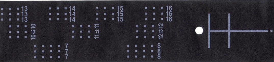

The new faint backing paper frame numbers, very frustrating though they can be, are not the only source of chagrin for users of MF cameras with ruby frame counter windows. I occasionally use a Czech Flexaret Standard TLR camera (6x6), and shooting Fomapan Creative 200 with it has presented me with an annoying problem.
Just at the end of the last frame (the 12th) the black backing paper has a mysterious 7 mm hole through which a corresponding area approx. 1 cm from bottom part of the negative is invariably exposed to light (perhaps at the factory?) and consequently ruined.
I have never encountered this problem with other 120 films (Adox, Ilford, Kodak, (old) Orwo, Rollei etc.). With them, I can rely on the frame number in the ruby window showing the correct positioning of the film. With Foma 200/120, however, the film seems to be displaced or offset relative to the backing paper. So far, I have shot six Fomapan 120 films, and all of them exhibit the same defect. I can only count on getting 11 full frames per film.
Have other APUG users met with this or a similar problem? Of course I should also dearly like to know what earthly end the hole might serve.

I wrote Kodak Alaris. They came back with the same statement about the 6x9 numbers for Voightlander Bessa cameras. I still don't know if that means every 6x9 with the red frame window or not.

Arista EDU 100 must be started sooner than the numbers in order to defeat the hole at the end. This is the row that lines up with the window in the Bessa without the number 1 that I have. If I used it in the Voigtlander Bessa I'd have to start counting at the first white square seen and not the number that follows.
I hope Kodak puts the correct row of numbers back on.
Michael L.
Sep 12, 2012
104
Copenhagen
After six rolls, my own conclusion to a T, studiocarter. Thank you. My Flexaret Standard uses the middle row of numbers, and the Foma 200 (= Arista EDU 200?) must be started at the first of the three white squares ahead of the numbers to finish before the hole at the end is reached.
I think that post #67 conclusively shows that (a particular batch of) the film is to be blamed, not any particular cameras.
