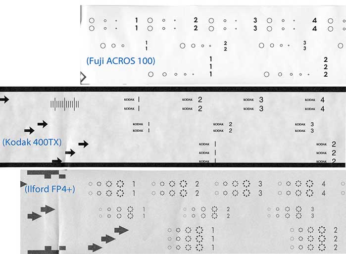

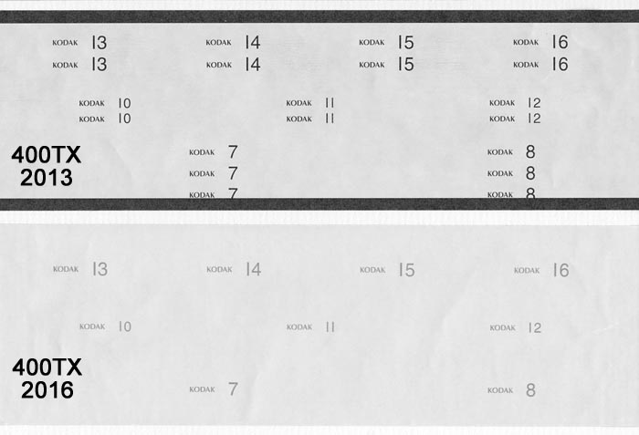

I find it difficult to believe Kodak would print paper for Tri-X differently from the others, but at any rate, here's a before and after from my recent experience:
I can think of two other possibilities -- 1) maybe they just ditched printing on a batch or two as a quick fix (admittedly scary) or 2) perhaps the OP's camera uses one of the non-centered number rows that has disappeared? I have no idea what cameras used those alternatives, my impression is they may be ancient. The new stuff works in my Perkeo II and Ercona II.

OP here. Sorry, not no numbers, just faint numbers that go unseen in low wattage incandescent light through the red window. I had a look at the papers from another box of the same film that I'd processed already. There ARE three rows just very faint. I will load a paper and see if they can be seen in daylight.

Note the competition has the multiple rows of numbers.
Also, not obvious in this scan, but the Fuji paper is whiter and has a glossier surface, as in maybe they have a different source (their printing is darker too).

400TMY-2 B&W 120 KP 125499 MA-600-1 This version has two dark number rows on the top and middle rows, left to right spooling, 16 & 12, and three rows of numbers along the bottom, 8. Ink is dark.
400TMY-2 B&W 120. KP 130206. MA-600-1. Light gray ink. One row each of all three, 16, 12, & 8. This is not usable in the camera I tried. "Damned engineers, the're always changing things; they just LOVE to tinker"
