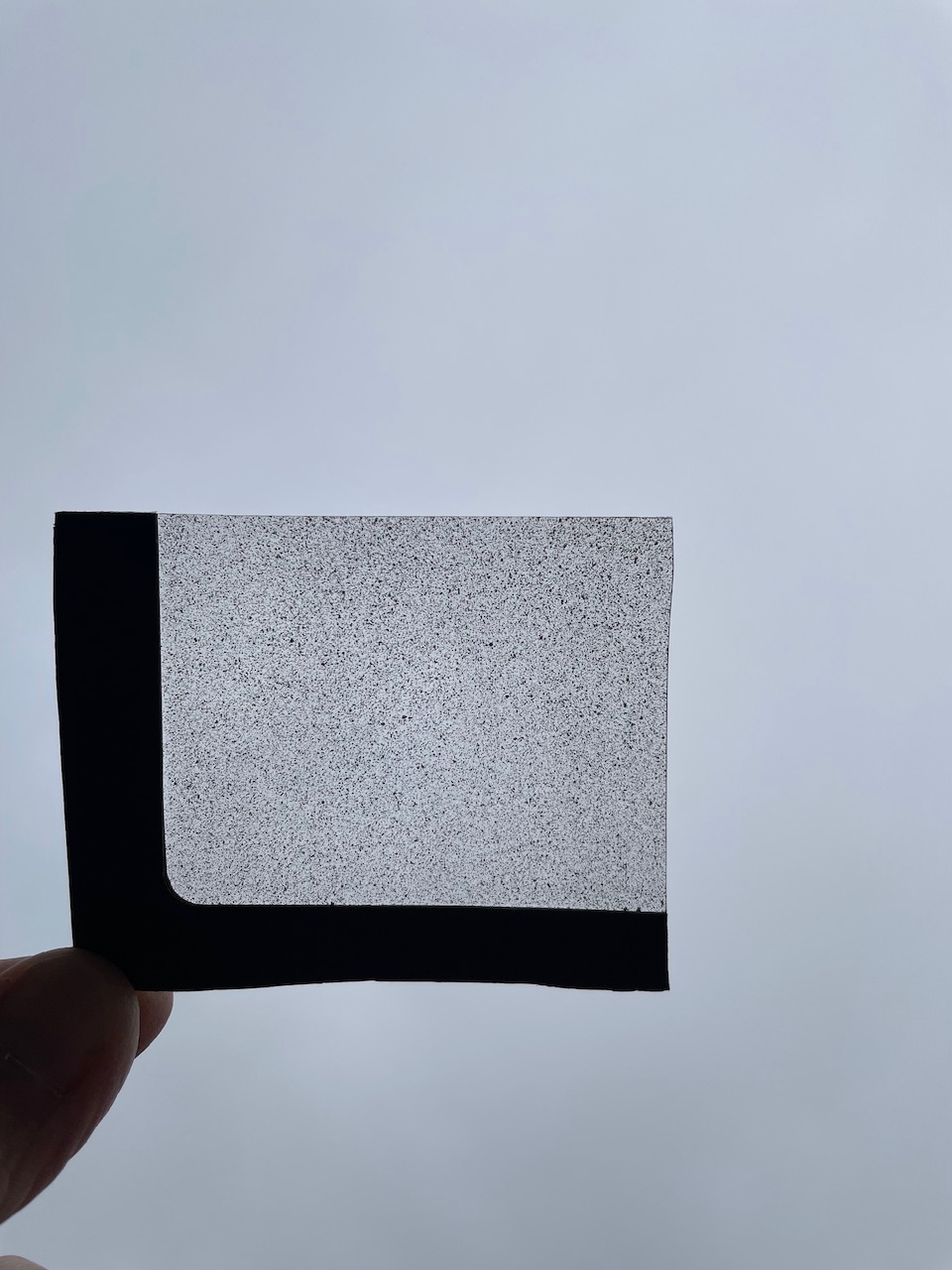

TBH I can just use 1/2 EV slower ISO each time instead of using ND filter. Much easier

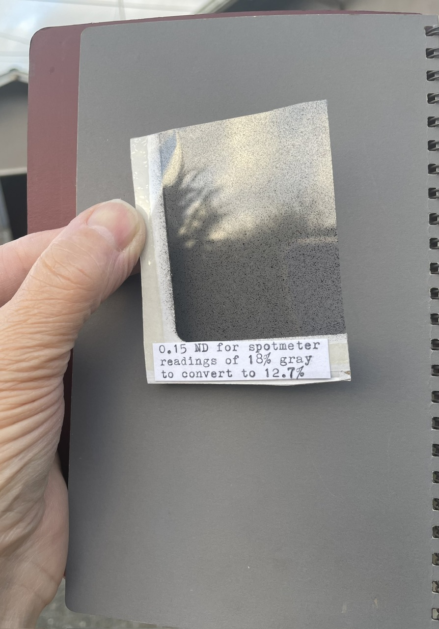

The 1/2 stop filter is only for taking spotmeter readings off the 18% gray card.
If you change the ISO. you might forget and leave it on for any other kind of metering purposes where you want to use the actual ISO.
ISO are in third-stops, and the difference from 18% to 12.7% is a half stop. There would be rounding errors.

Whichever ones you read the 18% card by reflected light need to be opened up 1/2 stop…
Correcting 18% to 12.7%
Digital Sekonic 3.5 fc (between 1/12 and 1/10 f/8)
Analog Sekonic 4.6 fc (between 1/15 and 1/12 f/8)
Pentax 5.6 fc (between 1/20 and 1/15 f/8)
You say 1/12 f/8 was the “correct” exposure.
The Pentax is reading one half stop higher than correct.
The Sekonics are within a sixth stop of correct.
