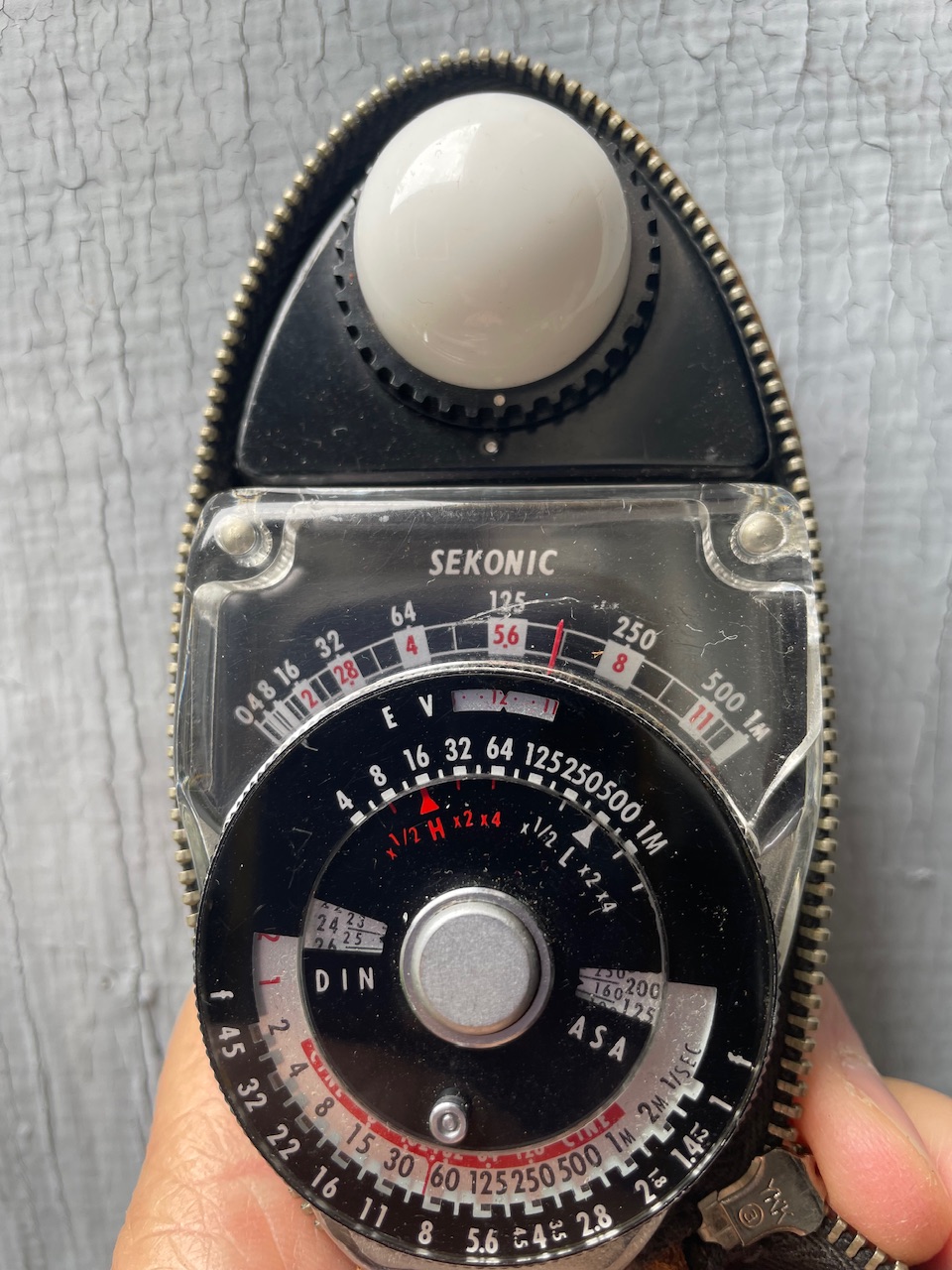

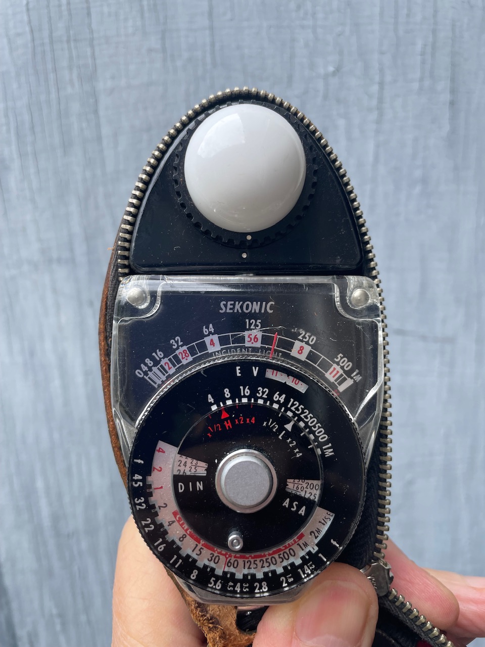

So for example, with no slide this was your old Sekonic reading?
Right. That must’ve turned when I held it up for the picture.

Please do correct my if I and wrong, and it is a so log time I haven't used my Sekonic lightmeter (I putted back in it's box years ago), but is the dome fixed correctly?
Shouldn't the white dots only be aligned when putting the dome on and then turn it clockwise to fix it?
I know, there are no electric contacts in the dome, not like the first model Variosix F, but the dome might not be parellel over the cell, or doesn't it matter?
You’re right the dots are in line to remove the dome, and you would want to twist to lock it. Doesn’t affect reading though.

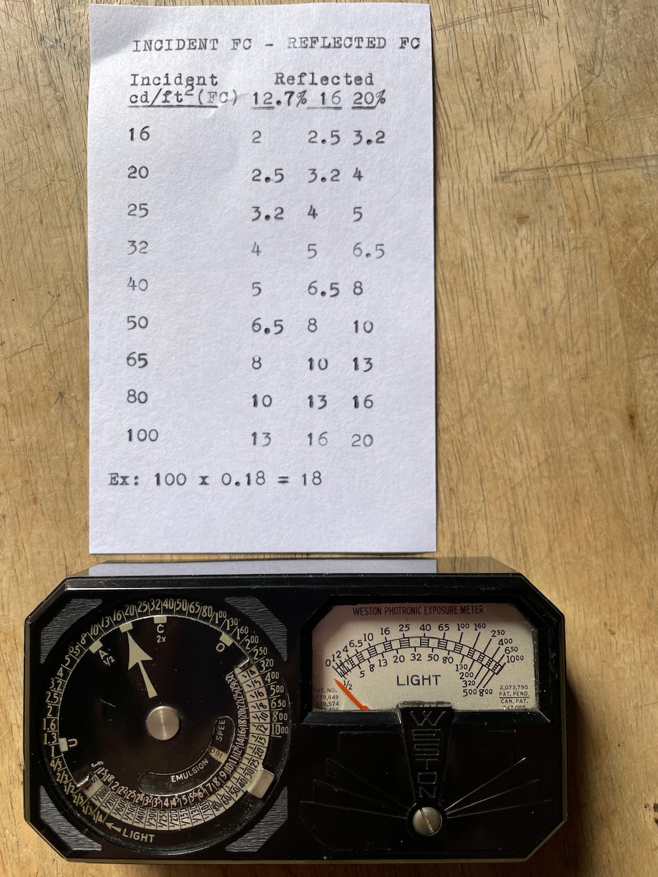

The oldest Weston’s had all the footcandle numbers, all the f/stops and all the shutter speeds marked in third-stops on the dial. I heartily recommend getting one of these for the dial. The Weston Master III has ASA calibration. Earlier ones are off 1/3 stop from ASA (160 = 200 in this example).
Using the numbers on the Weston dial (and transcribed to the card for illustration) you can figure what would be reflected at what percent reflectance based on what’s incident on the card.

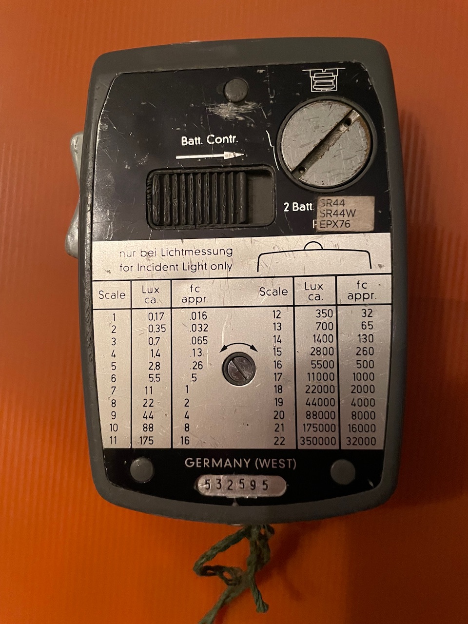

It was easy enough to see on the back of an old gray Gossen Luna Pro meter.
Relationship between incident footcandles as indicated on analog Sekonic. And reflected footcandles as indicated on Weston (after correcting Weston speed to ASA)
