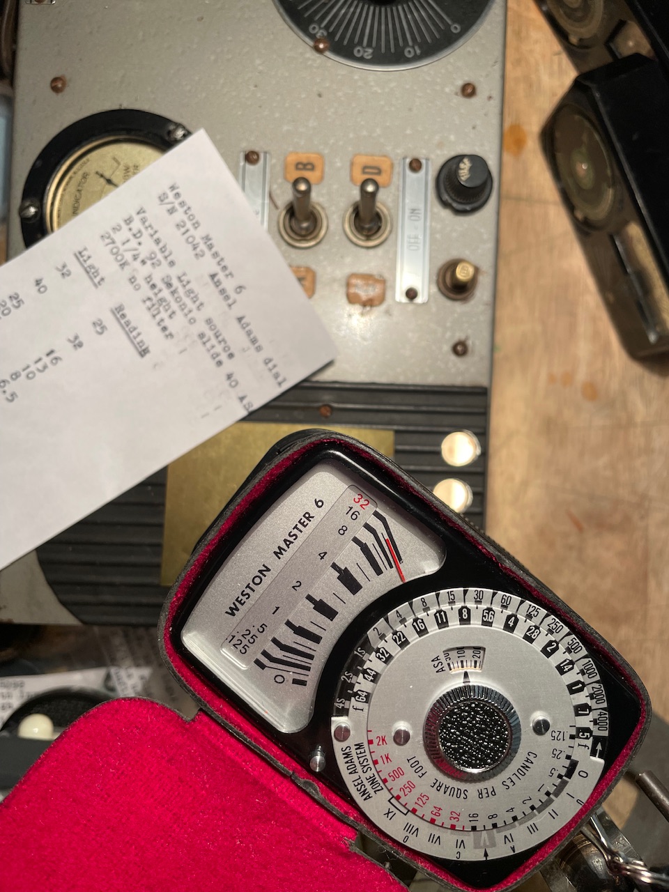

I really want to be able to evaluate a scene (Or a trans-illuminated panel) in candles per square foot. My calibration notes are in terms of candles per square foot actual vs what the meter indicates. I have one meter I trust: Sekonic L-758DR and an old gray Gossen Luna Pro keeps up pretty well with it.
So day-to-day knock around get the setup together with the Luna Pro and then check with the Sekonic. Those readings become my actual light and notes include the source, filters, attenuators, and distance.
Now I switch in the Weston and lose my mind because I can’t get 32 candles per square foot to read 32

Writing down the deviation between actual light and meter reading is the third step, after cleaning, balancing and zeroing.
I dream of a meter where readings match full scale high and low.
Next I dream of doing that with tungsten driven / filtered to 4700K.
And then to be able to do it for all the Westons
