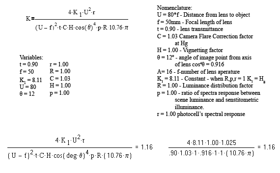

K isn't about reflectance. It's an exposure constant that factors in various elements that determine how much light strikes the film plane. If the exposure equation only uses f/stop and shutter speed (and film speed), the amount of exposure reaching the film plane or sensor will be lower than the equation predicts. K contains most of the variables as q, which is part of the camera exposure equation, but it includes variables associated with the exposure meter. Through the lens metering measures the actual amount of light entering the camera through the optical system. Hand held exposure meters need to assume average values.
1.16 is in cd/ft2. To convert to cd/m2, 1.16 * 10.76 = 12.48 or 12.5 cd/m2
Camera exposure equation:
