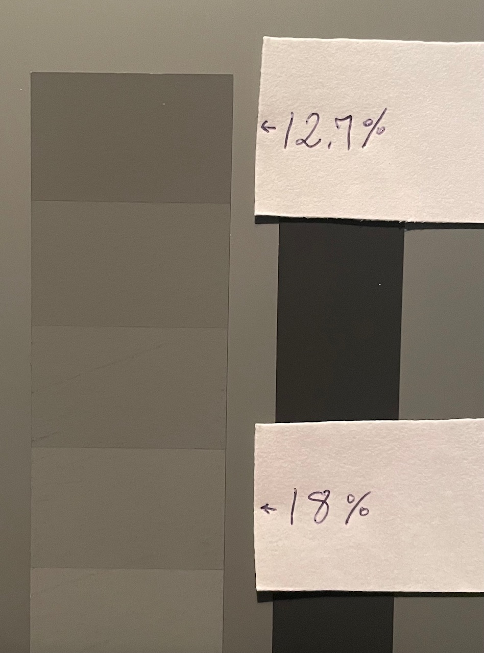

You may get better agreement if you will get a 12.5% gray card and meter off it in reflected light mode, and compare it to the incident light mode.
If you only have an 18% gray, the difference between 18 and 12.5 is expected and means that your meter agrees (if the difference can be accounted for by that much) and you should leave it alone. Treat it as OK if they differ by that much.
The delta EV from 18% to 12.7% is 0.5
These patches are sixth stop apart.
So your meter reading of an 18% gray card ā€œshouldā€ read 0.5 EV greater light value than incident reading.
