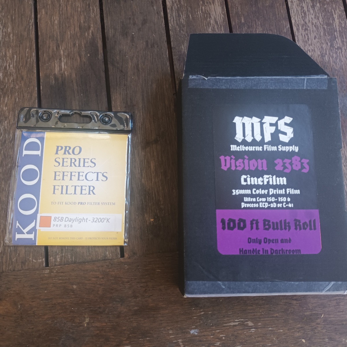

I think using the 85b filter in daylight with tungsten film is the correct way.
I had a look and found one and as well a roll of slow iso film I bought ages ago, coupled with a recently purchased F100 camera and tripod, I can see for myself what it can do.
I'm keen to try my hand at ra4 printing at some stage, have the equipment, don't mind messing with colour. IMG_20220913_162036.jpg
I use an 85b for 3200k (tungsten) film in 5500k daylight
Yes, typically the procedure is to use 85B filter (orangeish warming) for tungsten film in day light, and 80A (bluish cooling) for daylight film under tungsten lights. There are weaker versions of each and the naming isn't totally logical, for ex an 85 filter is slightly less warming than an 85B, and the 81a,b,c filters are much less.
Comparing the filter curve of an 85B filter to the orange (cuts blue) filter used with black and white film will show they are very different and cannot be interchanged.
I used an 80A filter to make slides of paintings under incandescent bulbs BITD, using daylight slide film, which was easier to get than tungsten balanced.
