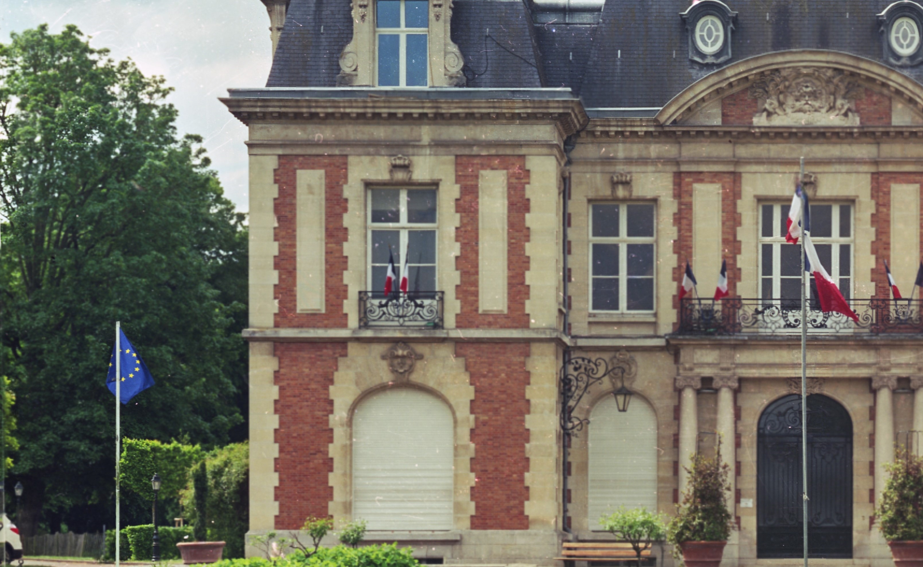

This is just a snippet from an overly-casually handled negative taken with my Sinar F2 on Cinestill 400D, 210mm Sinaron S at f/22 and 1/250th.
The scan doesn't go near reflecting the sharpness. I also might have given a little more time in development.
I love the colours. The full shot features more sky and lawn, both of which rendered superbly.
I swear that the cops could lift a fingerprint off those windows if needed.
