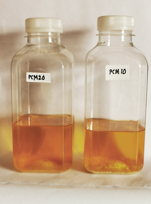

The PCM20 storage sample is now ~6months old with few crystals, pic, and I am continuing to use this formula.

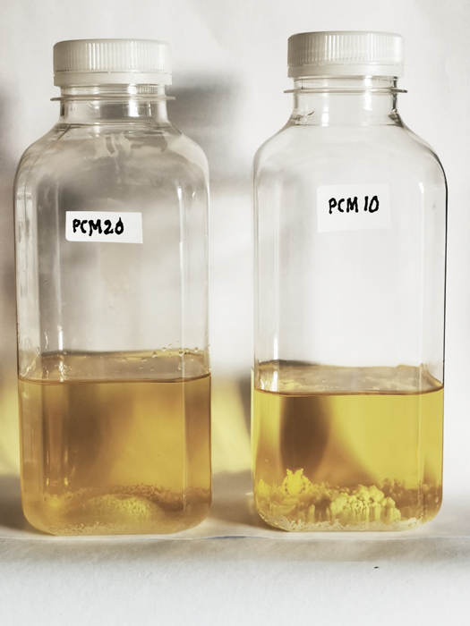

The storage test concentrate of relistan's formula PCM20 is now 8 months old (pic) and the concentrate I use is now 5 months old (July 2024).
Both show more crystals but fortunately they stick to the surfaces of the containers and do not float about, making it possible to decant the solutions (for now) if needed.

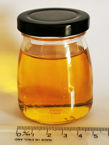

After about 6 months the remaining working sample (not the storage sample) was decanted into a wide necked 100 ml clear glass bottle (pic). A tiny few crystals carried over and settled out but the decanted PCM20 is now easy to see and syringe out.

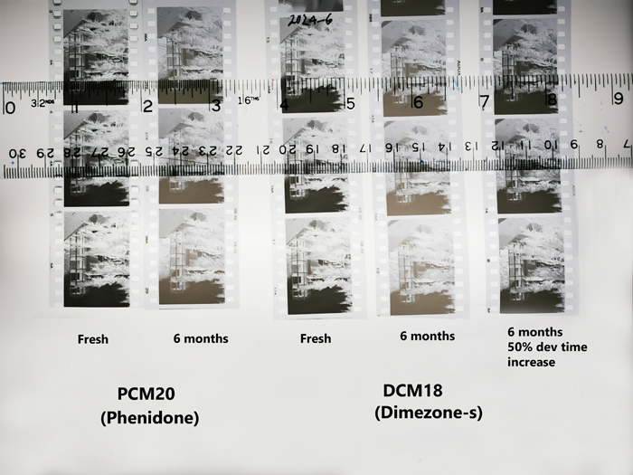

I noticed a decrease in negative density with time using PCM20 and after about 6 months I made a test (attachment).
This shows that after 6 months there is a notable decrease in negative density using both PCM20 and DCM18.
After 6 months an increase in development time of more than 50% is needed to restore the negative density to that obtained with fresh concentrate.
IMO is fairly clear that neither of the concentrates PCM20 or DCM18 is going to be a satisfactory stable HC-110 substitute and if it is wished to use PC Borax developer it is better to use PC 512 Borax described by @relistan at the start of this thread as this does not lose activity.
I will carry on tinkering with the concentrate PCM20 until it is used up as it is otherwise quite a nice developer.
