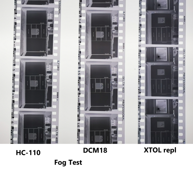

@Alan Johnson What is the Base+fog like on these metaborate variants? One of the things that is much better with PC-512 Borax vs PC-Glycol is that it has basically no worse fog than most commercial developers. I had attributed that in part to the pH difference.
Attached a pic on a light box of Delta 400 developed in HC-110, DCM18 and replenished Xtol. I don't see a problem with base +fog using Metaborate in Glycol, at least with Dimezone-s.

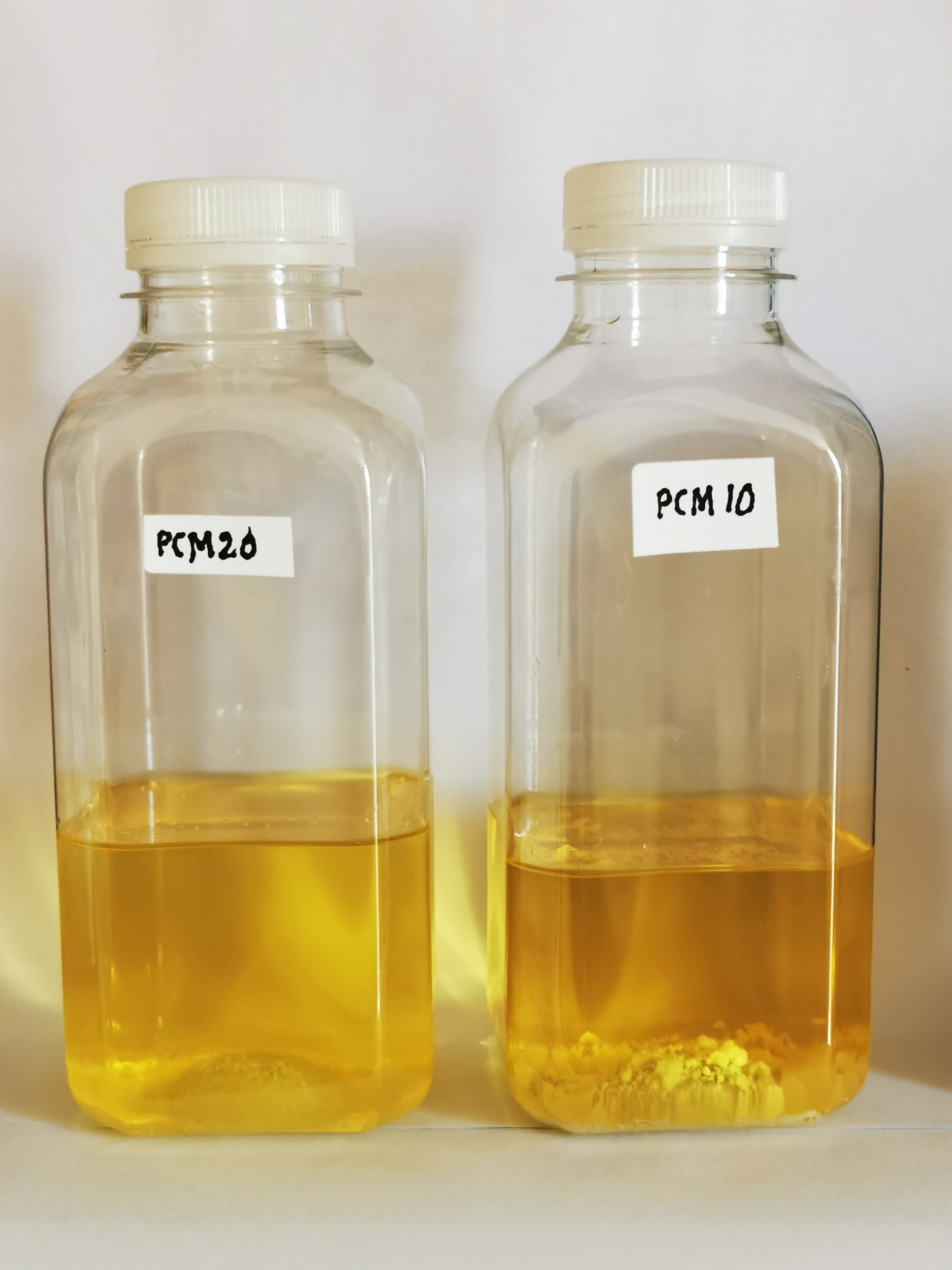

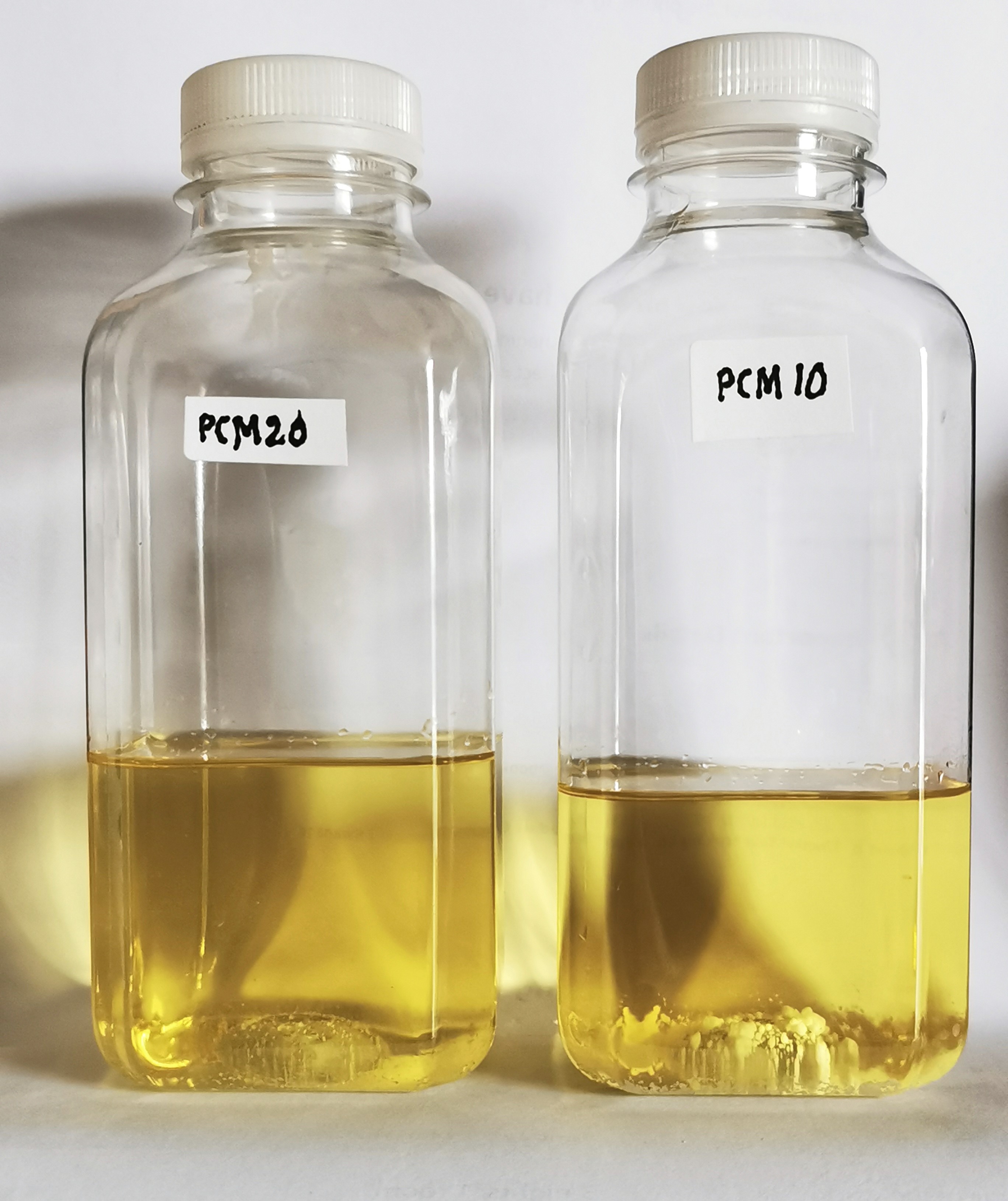

It is rather disappointing to find that after 12 weeks crystals have appeared in the PCM10 storage sample and a lesser amount in the PCM20 (pic). These may be metaborate as the ratio 1.67 is greater than 0.4-0.5.
The sample of PCM20 I am using is only 4 weeks old and has no crystals, I will carry on unless there seems a better idea.

Alan, were these clear when you mixed them? I'm surprised at how yellow they've become after only 12 weeks. And yes, the growth of crystals is disappointing. If the crystals can be made to dissolve under heat (I suggest a water bath), then they are not due to the separation I encountered with Mocon. Perhaps a PCM5 would not crystallise.
Did it become colder around the time?
What bothers me is that I would have expected, if the crystals have just come out of solution, that the lower concentration version PCM10 would exhibit it less or not at all compared to the more concentrated one.
About the yellowing: About the effervescence around 55degC, it seems that it's water of crystallization being expelled (see my post #350 link to data from borax.com) but since water mixes with PG, it's still there in solution. Would it be feasible to remove at least some of the water by heating the PG + metaborate to a higher temperature? I would be inclined to do it before adding the two developing agents (once it had cooled.)
The two shown in the pic, post 409 are kept to see what happens if the developer concentrate is just left in store so I will leave them to see if/how the crystals grow. They were clear when made up. Maybe eventually they could be re-heated to see if the crystals re-dissolve.
For a few days before the crystals were noticed the temperature dropped by about 15F to 55F.It is surprising that the PCM10 is most affected. My conclusion so far is that the occurrence of these crystals means that this glycol mix is likely to be of interest only to a few hobbyists who have a quantity of metaborate, most people would be better off mixing @relistan's formula for 512 Borax.
For actual use I have a separate mix of PCM20, not the storage samples illustrated. After 4 weeks this is still clear.

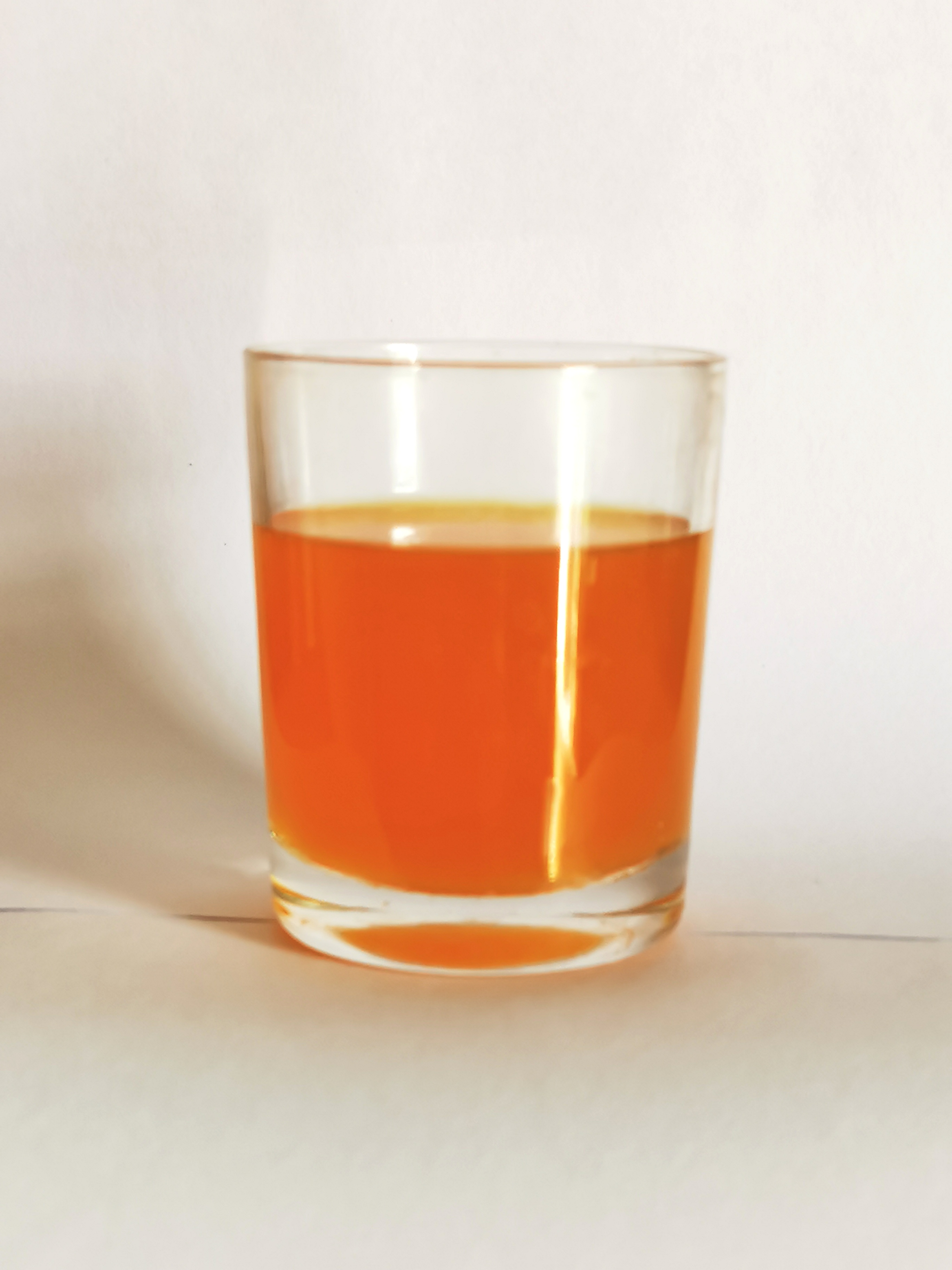

To see if it is possible to re-dissolve the crystals, I used a sample of PCM18 with crystals in a glass bottle.
The bottle without cap was placed in boiled water and the contents stirred every few minutes, the water being brought to the boil every few minutes. The temperature of the PCM18 sample was found to be 65-75C. This was continued for 1hour and the bottle removed and cooled.
Next day this sample was found to be cloudy and orange [oxidation of ascorbate].It was tested for activity by comparing with a colorless sample of DCM18 [all I had]. There was very little visible difference [the test is not that accurate] in negatives from the same strip of film developed for the same time& temperature at the same dilution using the heat treated orange PCM18 sample and the DCM18 sample.
This suggests that if it ever becomes necessary to re-dissolve crystals, the heating procedure described above will work.
