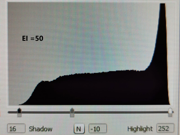

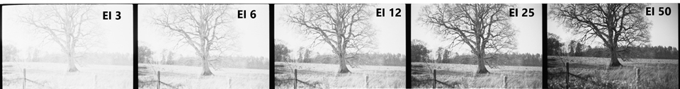

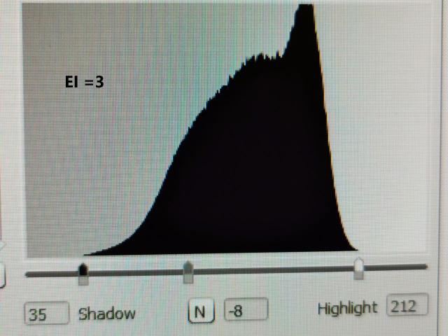

Using the diluted PC-512 Borax 1+1 for 10m 20C, HR50 was exposed at EIs from 3 to 50 (pic).
Scans of individual negatives at EI=50 and EI=3 were made, the histograms are shown (pics).
This shows that as the exposure is increased (EI 3) to the shoulder of the H&D curve where it starts to curve lower the range of tones captured is reduced (the histogram gets narrower).
The contrast is reduced as discussed above. Presumably is could be increased again by overdevelopment. A good film for the Ralph Gibson technique.
