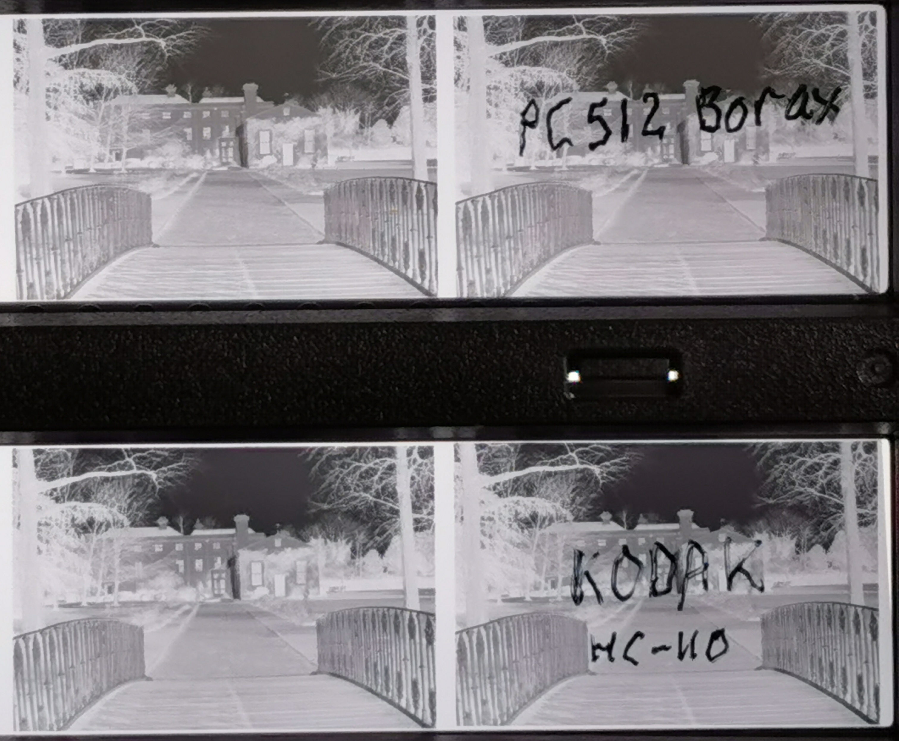

At high magnifications it may be seen that PC-512 Borax gives a finer grain than the former Kodak HC-110 syrup (next to it on Flickr):
PC-512 Borax:
Very interesting @Alan Johnson! That is quite a noticeable difference.
I had never done this comparison, but I had observed from the start that this developer has much finer grain (and less/very low fog) compared to other similar formulas I had tried. It is interesting here that it is outperforming original HC-110 syrup with its fancy sulfite substitutes. I had thought at first that the fine grain might have something do with borate and ascorbic acid interaction. I did not test too far in that direction to understand it better. I know that folks with better chemistry than me (notably @Rudeofus) did not think that is the case.
It may also have to do with the unbuffered pH, which already starts fairly low and should drop as the products of development form, but I tried other HQ developers in the same range of pH and did not see as fine a grain (and fog!), and a bicarbonate-based developer with only a bit higher pH did not do as well. I am looking in my notes and I don't seem to have a pH measured after development had finished. That might be informative.
This ratio of ascorbic acid to phenidone also seemed to give the best speed and fog characteristics, which was why I settled on that. I doubt that has much to do with grain size, but it's possible. Perhaps it has an effect if somehow the ratio switches something and the primary agent here is actually ascorbic acid? According to Anchell and Troop, Silvia Zawadzki thought that it might be ascorbic acid that was the primary agent in XTOL. But as far as I know, ascorbic acid as a primary developer on its own is fairly foggy and I'd expect that to be bad without sulfite—which XTOL has and PC-512 Borax does not.
Interested if you have any other theories.
The question I always ask when facing such a comparison: were both negatives in the same density range? If you assume (and published scientific measurements confirm this), that silver grains are completely opaque to light, then you can assume classic B&W negative film as an arrangement of fully opaque and mostly transparent patches. Size of patches depends on development, but the actual granularity of the result will also depend on "how many patches do you need to create a certain density?".
If your density is 0.3, then you need an equal area of opaque and transparent patches, while D=1 will already require a 1:9 ratio. At D>=2 things will quickly go very very grainy regardless of which developer you used.
The PC-512 Borax was slightly less dense. But not sufficient to change the conclusion that it gives finer grain.
I made a better test earlier with the unstable metaborate syrup version DCM18:
