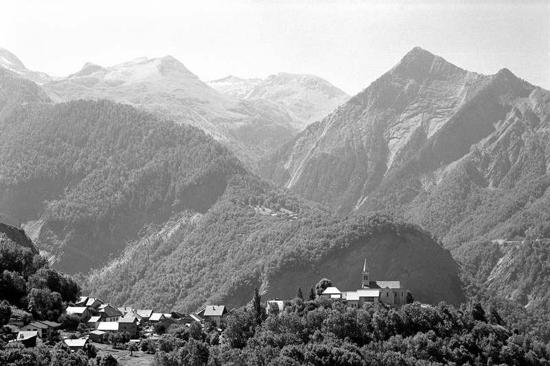

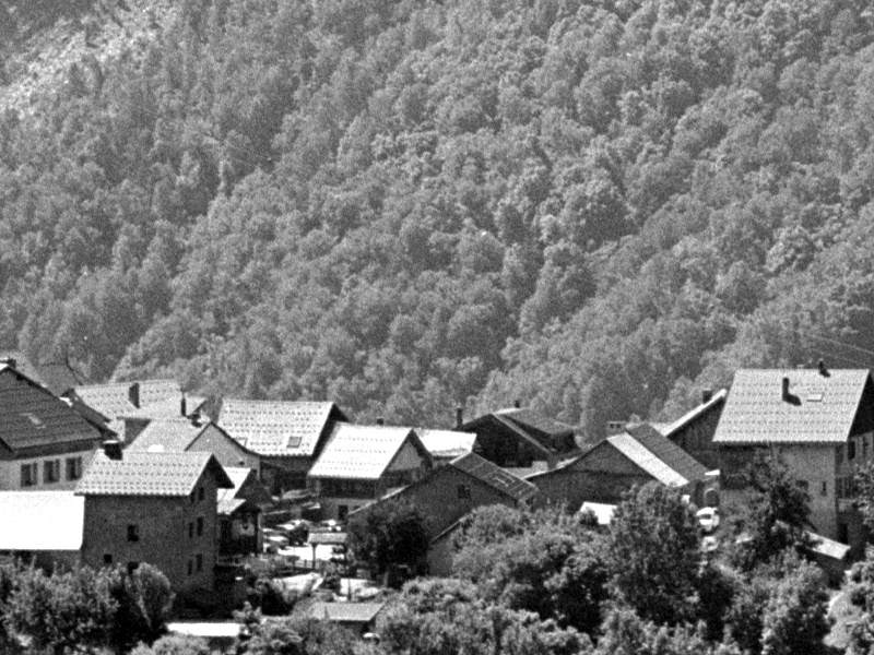

Long time watcher of this thread. I had sworn off Silver Bullets; long time user of D-76 1+1. But I was convinced by the positive evaluations. Prepared some PC-512 and developed a short series of pictures. FP4, Contaflex SuperBC, yellow filter. Dev 6'15" @ 22°C (from 7' @ 20°C per Ilford compensation chart).
Taking the film out of the PhotoFlo, I was already impressed by the low fog, the detailed shadows, and the tone separation. Nice negative! Please define? You know when you see one🙃 And after scanning, good resolution and almost no grain (although grain is not at the top of my priorities). Tonality looks all right, although a more qualified statement will wait for enlarger prints.
@relistan : Well done!
LS-2000 scan, just black and white points, no USM.
100% crop @ 2700dpi :
Thanks for posting, this is great! Nice results and I'm glad you are happy with them!
