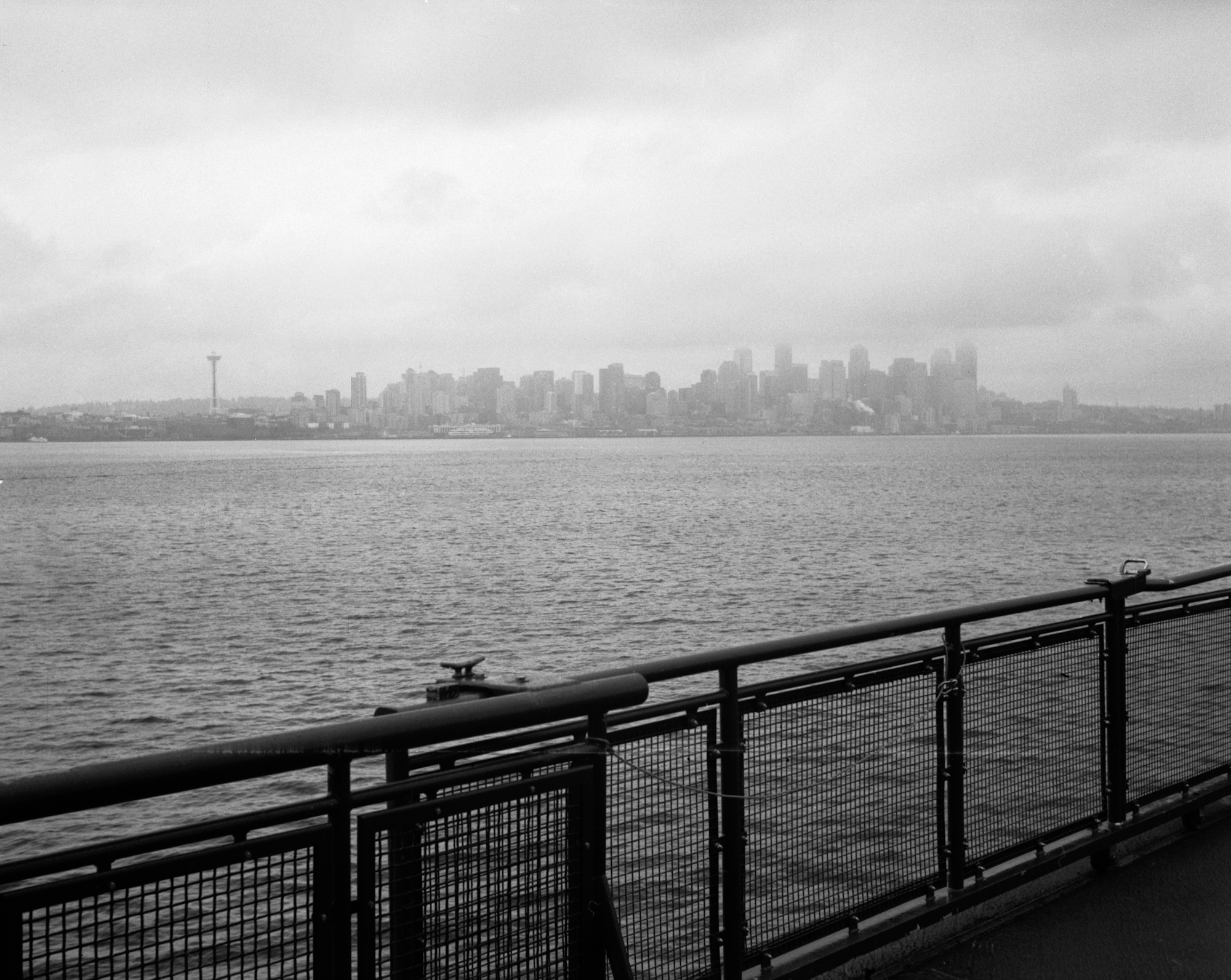

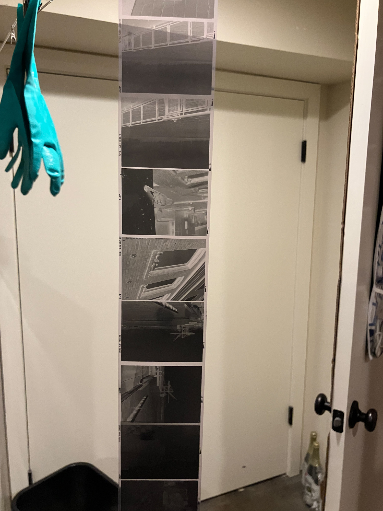

Gave PC-512 a shot today. Completely bungled my first roll where embarrassingly I forgot to mix my concentrate with the borax solution. I think I must have autopiloted as if using HC-110. Turns out that the developer does NOT work without borax 🤣
But the second roll turned out pretty well.
HP5+ in 120 (6x4.5) shot at 400, deved for 6:45.
Couple things stood out.
1. The color of the dev when pouring it out was black!
2. There is more base fog, but the contrast is more than fine.
3. Mixing the ascorbic acid took WAY longer than I expected. I ordered a magnetic stirrer.
4. My PG was super smelly, and worse once heated. I thought PG was supposed to be odorless but this was uncomfortable. I reached out to artcraft where I bought it from.
5. There is grain, but it’s got a kind of soft easy quality to it. I usually develop HP5 in HC-110 and I dislike the way the grain in the highlights looks. This is nicer.

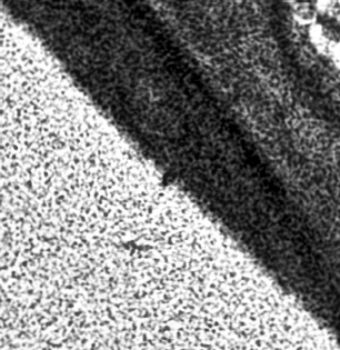

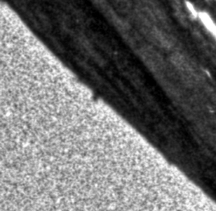

I compared PC-512 Borax with FX-1, blue sky, orange filter.
PC-512 Borax
FX-1
PC-512 clearly gives less grain . An assessment of sharpness seems to depend on whether the relatively smooth edges with PC-512 appear sharper than the ragged but clearly defined edges with FX-1.
The resolution of my scanner ,~80 lppm, is a limitation in the attachments, which are from about 1mm squares of negative.

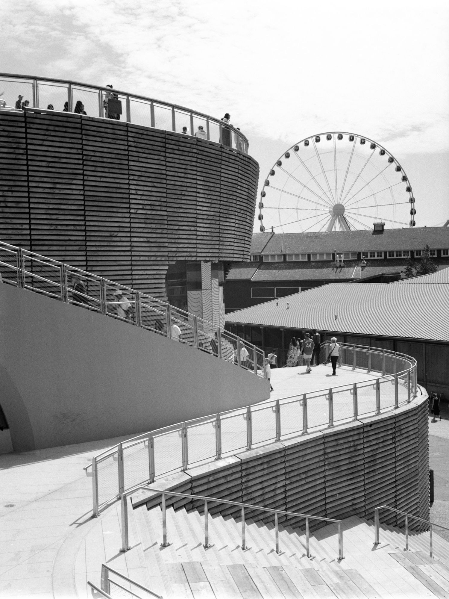

I developed Delta 100 shot with a Fuji zoom date f2.8 in half strength (1+49+50) PC-512 Borax using the time for full strength multiplied by 1.8.
FP4, HP5+, Delta 400 and Delta 100 have all been shot in the half strength version using the time multiplier of (full strength time) x 1.8
The factor of 1.8 seems about right from the limited number of tests.
PC-512 Borax
FX-1
