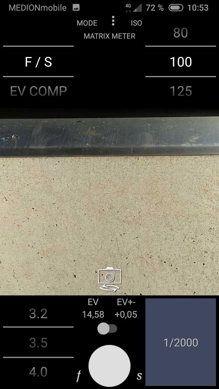

For most Minox-type cameras with manual control, exposure is easy with a small adjustment to the f-16 rule. Just multiply the ISO by 20 and that's the shutter speed for a SUNNY situation.
ISO 25 = 25 x 20 = 1/500 SUNNY - adjust as the light dims:
Cloudy w dull shadows = 1/250
Cloudy Bright no shadows = 1/125
Overcast/shade = 1/60
etc.
ISO 100 = 100 x 20 = 1/2000 SUNNY -- use a filter
Since I normally shoot B&W at 1/2 the ISO, I adjust for that too.
Today the proof of how accurate your process is. I didn't have a gray card with me, so it was a gray wall.🌞
Alsdorf, Germany, cloudless sky in the morning:
