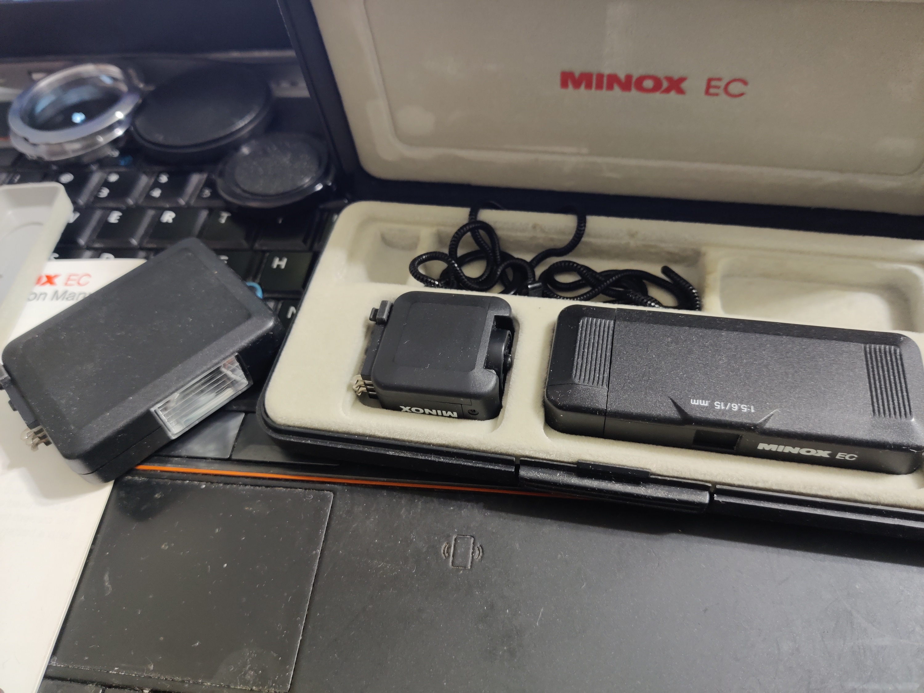

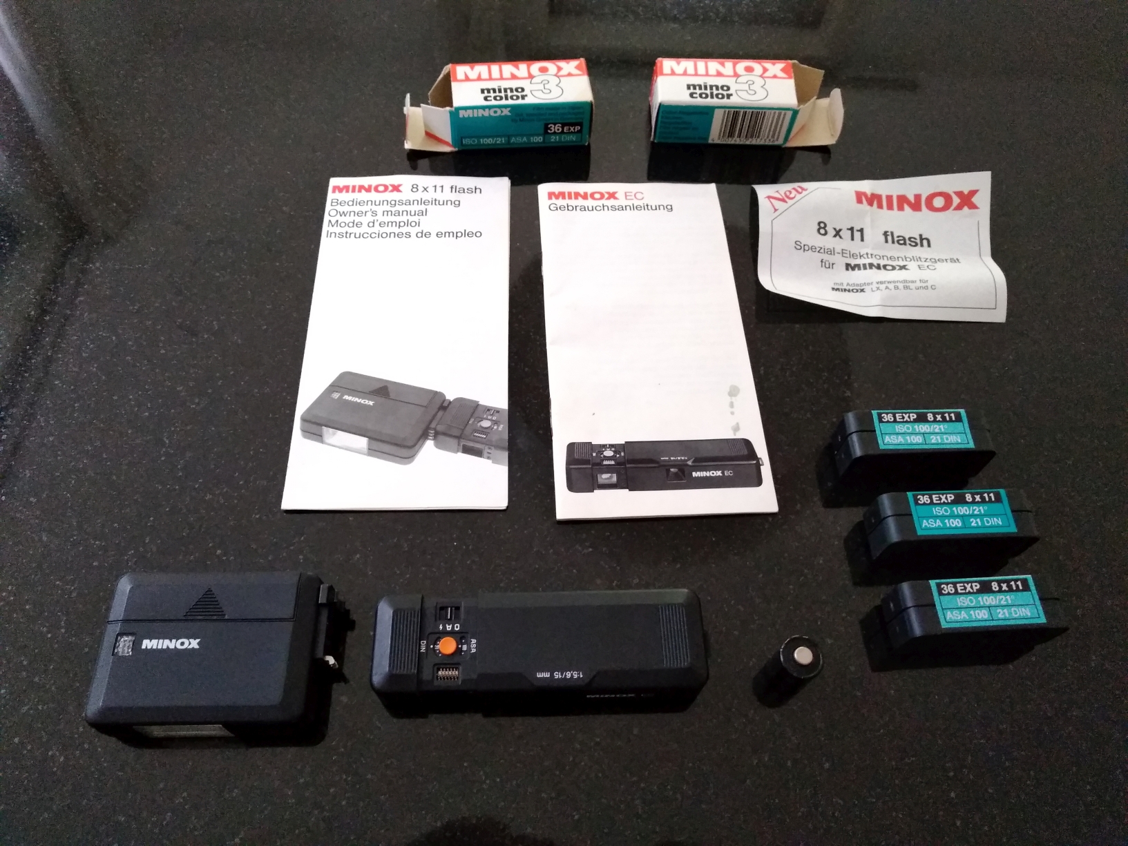

Here is an addendum on the subject of costs for Minox beginners. Today I received a Minox EC that I bought privately online last week.
Price for the complete set: 10 Euros
Camera and electronic flash look like new and work perfectly (not yet film tested). The three films (36 exposures) are still unopened (1993). The operating instructions for the camera and flash are complete and appear to have never been read.
I admit, that was outrageous luck.
That is a heck of a deal. And you got the version with the flash which is the one to have. FYI they made a case for the flash and the camera together if you can find one. It makes for a tidy little package. I have one but I don't remember where I got it. Possible it came with the EC. My EC was the package version that could be bought through an airline.

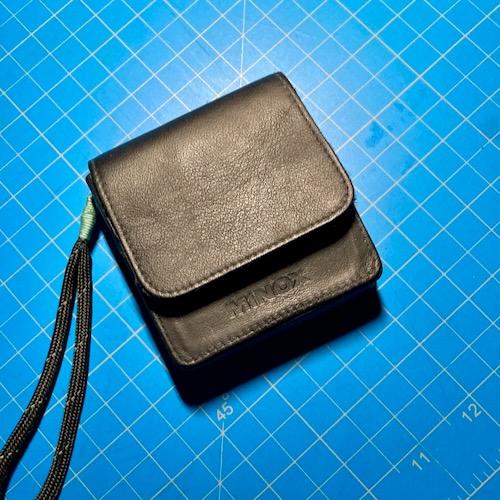

Can you please show us a photo? I've never seen it.

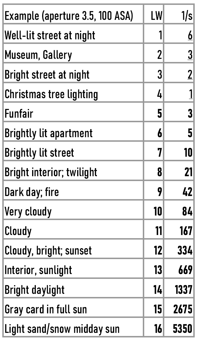

Very interesting consideration. Today's films have a very large exposure latitude compared to the 1950s. When I shoot outside with my Minox A IIIs on ā€œnormalā€ days, it almost always comes down to 1/100 of a second at 100 ASA.
Some time ago I made a table with example situations and Minox exposure times for 100 ASA. That's about right for me here (in Central Europe):
LW: Light value
Last column: underlined values mean whole seconds, all others mean fractions of a second.
I calculated the times with the help of this page: https://www.elmar-baumann.de/fotografie/formeln/belichtung.html
