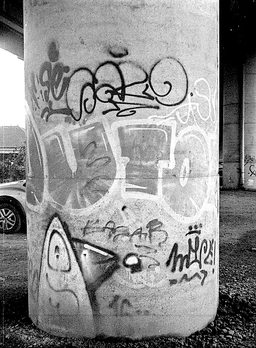

Minox IIIs, Ilford FP4 (517 type)
Looks as good as a Kodak Ektar H35 or Pentax 17 to me!
That's the beauty of Minox -- except for grain, it is as good as a significantly larger format.
