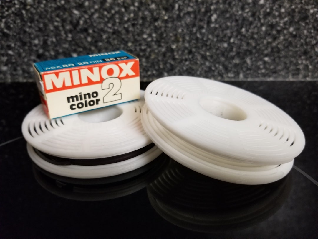

Once I figured out how to make the 3D printed paterson reels work, I've mostly only used those. The problem is that if the film is loose in the reel the emulsion will naturally rest against the surface of the plastic film channel, which prevents it from developing sufficiently. I found that while loading the film I could push it all the way inward to the core and then wedge the end in place with a piece of foam rubber, keeping some pressure on it. This way the film is forced outward so only the non-emulsion side touches the reel channel, and the emulsion side now gets uniform development.

I'm using these $20 reels in place of the daylight tank, which appears to have soared to "collector" prices for some reason. I'm also cutting my own film down from 35mm rather than buying pre-made rolls - once you have a couple of cartridges, reloading them with hand-cut film is vastly less expensive, since you can get 4 full minox rolls from a single roll of 35mm with very little waste.

I have a couple of those cut down Paterson reels for developing film which work for me with B&W.

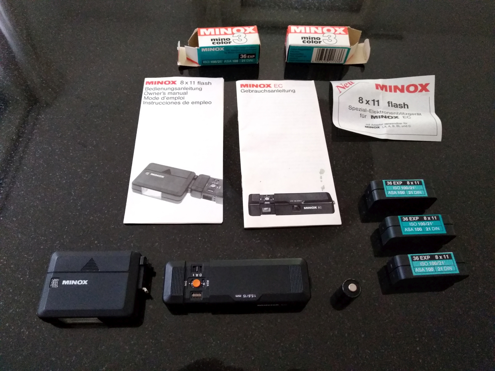

Here is an addendum on the subject of costs for Minox beginners. Today I received a Minox EC that I bought privately online last week.
Price for the complete set: 10 Euros
Camera and electronic flash look like new and work perfectly (not yet film tested). The three films (36 exposures) are still unopened (1993). The operating instructions for the camera and flash are complete and appear to have never been read.
I admit, that was outrageous luck.
